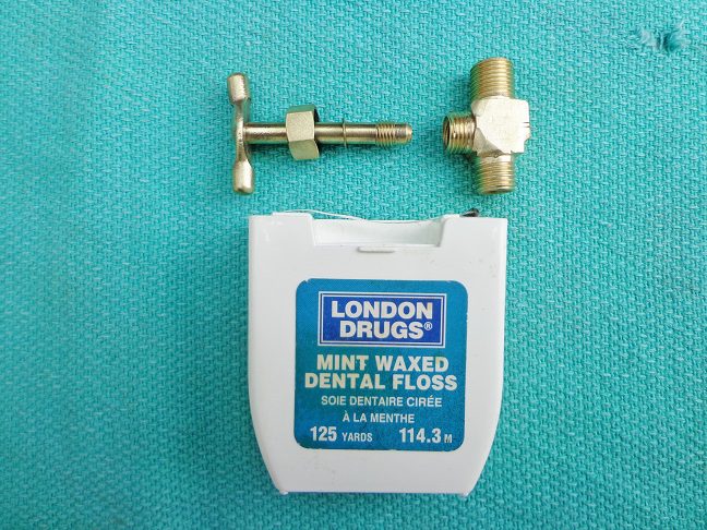

                I have heard that winding dental floss round the stem will fix the leak.
                #276218
                  DSC00050
                  DSC00051
