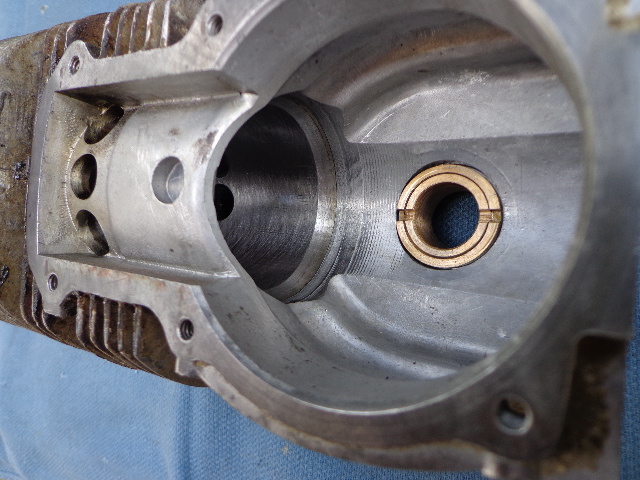

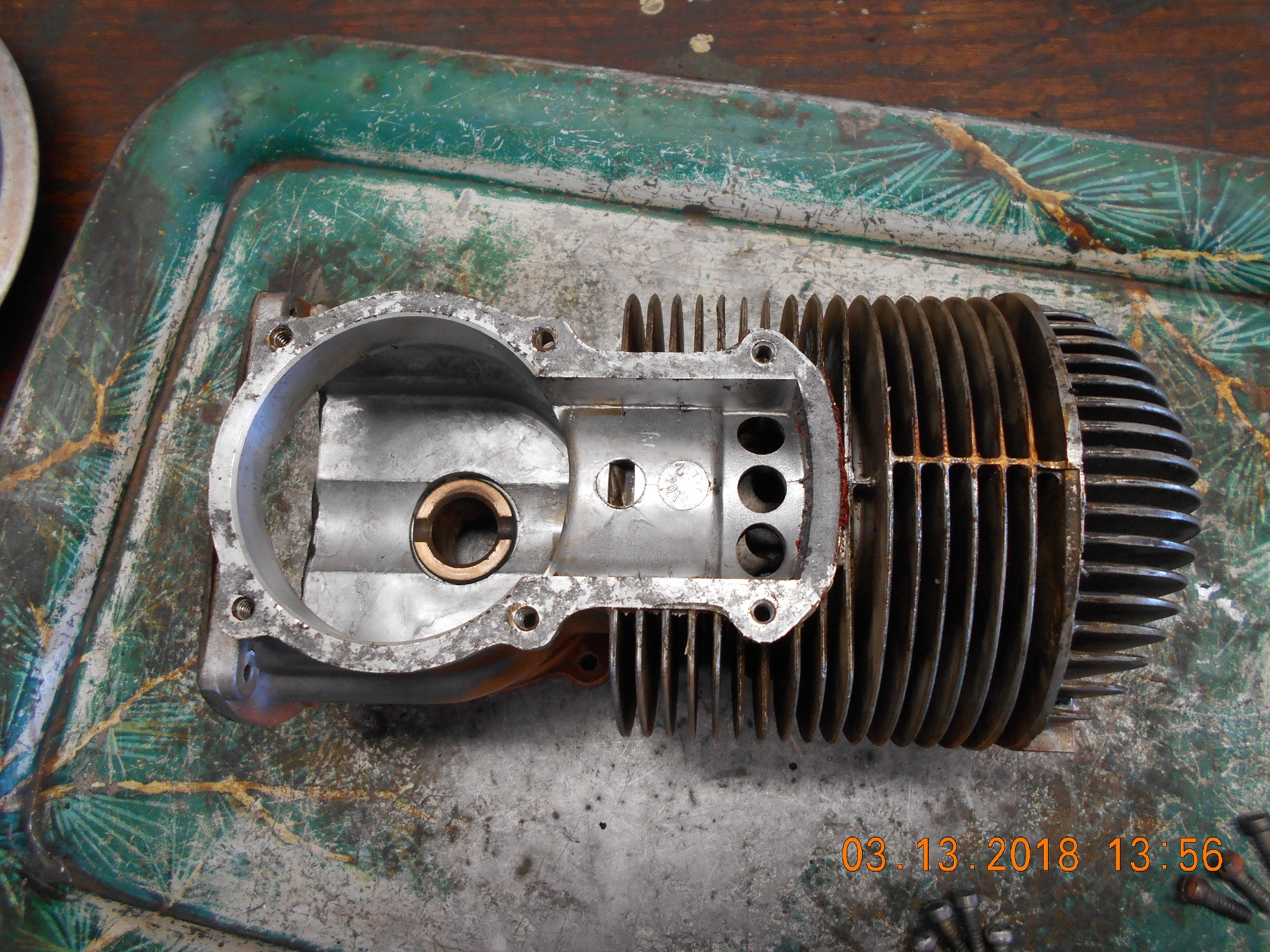

          Good idea on the ring "end gaps". I’ll try to get a ring in the bore and
          measure the gap, but with the way this power head is built, it may be
          hard to get a measurement with the ring at the top of the bore.
          It’s "headless" and the jug and crankcase is all one casting.
          This piston comes out of the bottom of the crankcase after the
          crankshaft is removed.
          It’s the type of piston that has all three rings pinned with the end gaps
          lined up in a row……… that never made sense to me!
          I remember reading that about honing / roughing up the rings on that
          other thread…… not sure I’m ready for that one yet. 😕
          #72498
            I pulled the rings off the piston and shoved one into the
            bottom of the cylinder bore. I came up with .014 end gap,
            which seem a little much unless air cooled engines
            need more gap? I could not find specs on it.
            Doesn’t the bottom of the cylinder bore usually have the least wear?
            If so, my end gap could be a little more at the top of the bore.
            I did not attempt measuring at the top, as I had a hard enough time
            with my angled feeler gauges measuring the gap with the ring
            at the bottom of the bore 🙁
            There was some carbon under the rings so that could be a minor
            issue with the low compression.

                      Dale, I don’t think that the ring gap is going to be "less"
                      at the top of the bore than the .014 at the bottom, so
                      I’m not going to bother trying to measure at the top
                      of the bore. It’s a $20 outboard, and it’s not like it’s going
                      to be bored over size, etc., therefore, "It is what it is"!
                      I’ll stick it back together and see if it runs. Maybe de-glazing
                      will give me a little more compression.
