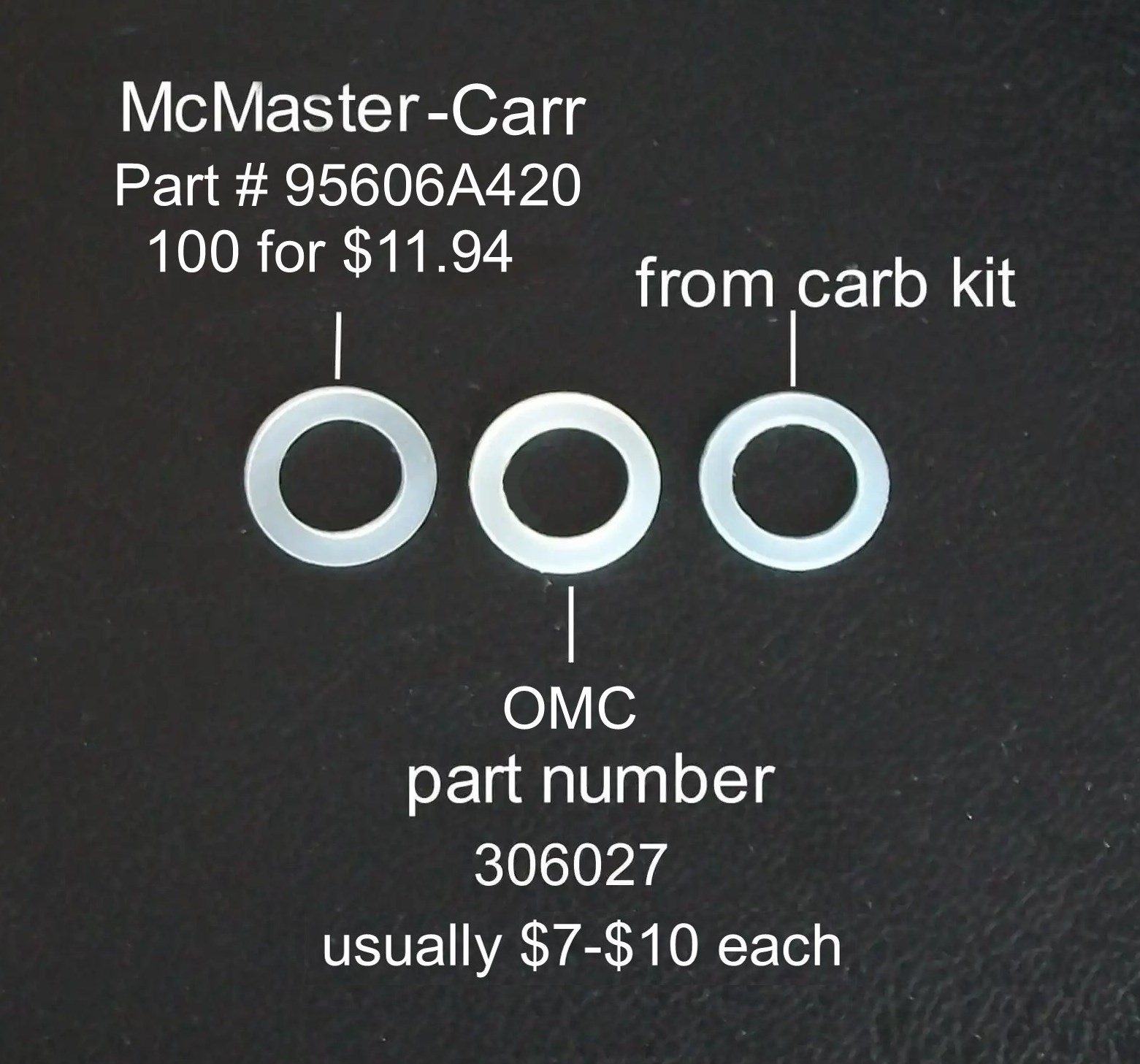

      2. in the Carb kit 0439071 you get two plastic O-rings/washers to use on the high and low speed needles and the packing washers.  Would anyone be able to tell me a size of this oring/washer and a source if there is a  place to buy a bunch.

        Yes, I believe soldering is the best way to re-attach that and I think Mumbles commented on that not too long ago. But I’ve also seen some that were secured with what I believe was 3M 847 or similar, that showed no sign of leakage. As far as the nylon washers that go on after a couple of the cork packing, I’ve gotten them from McMaster Carr and they’re a perfect substitute.
        https://www.mcmaster.com/catalog/129/3630/95606A420
        Part #95606A420
        Nylon Plastic Washer, Number 12 Screw Size, 0.25″ ID, 0.375″ OD, 0.026″-0.036″ Thickness
        carb-packing-nylon-washer-comparison-and-prices

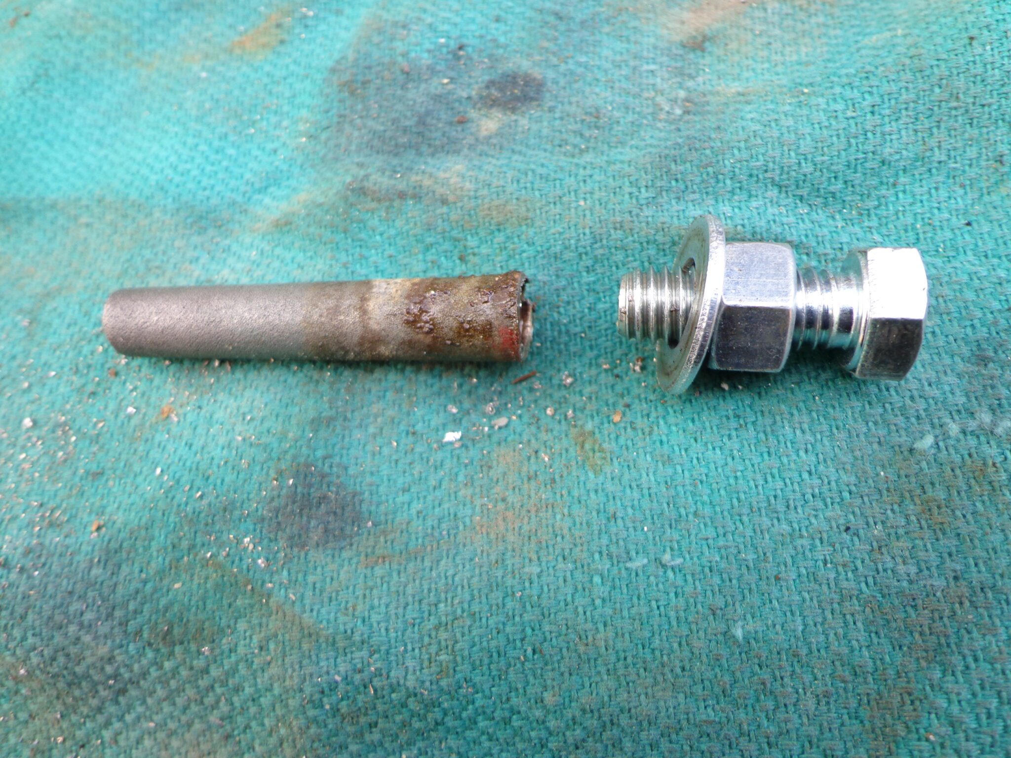

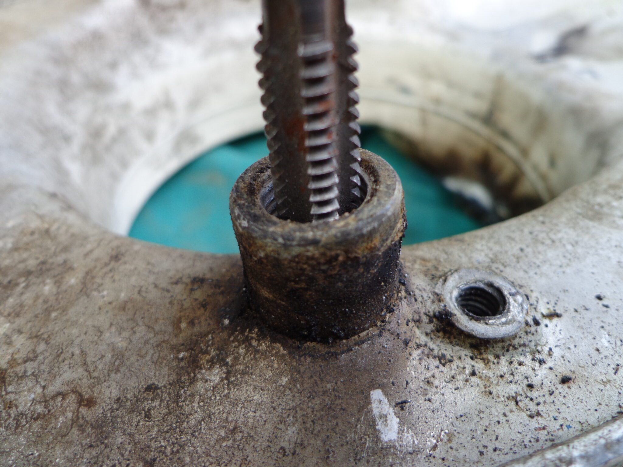

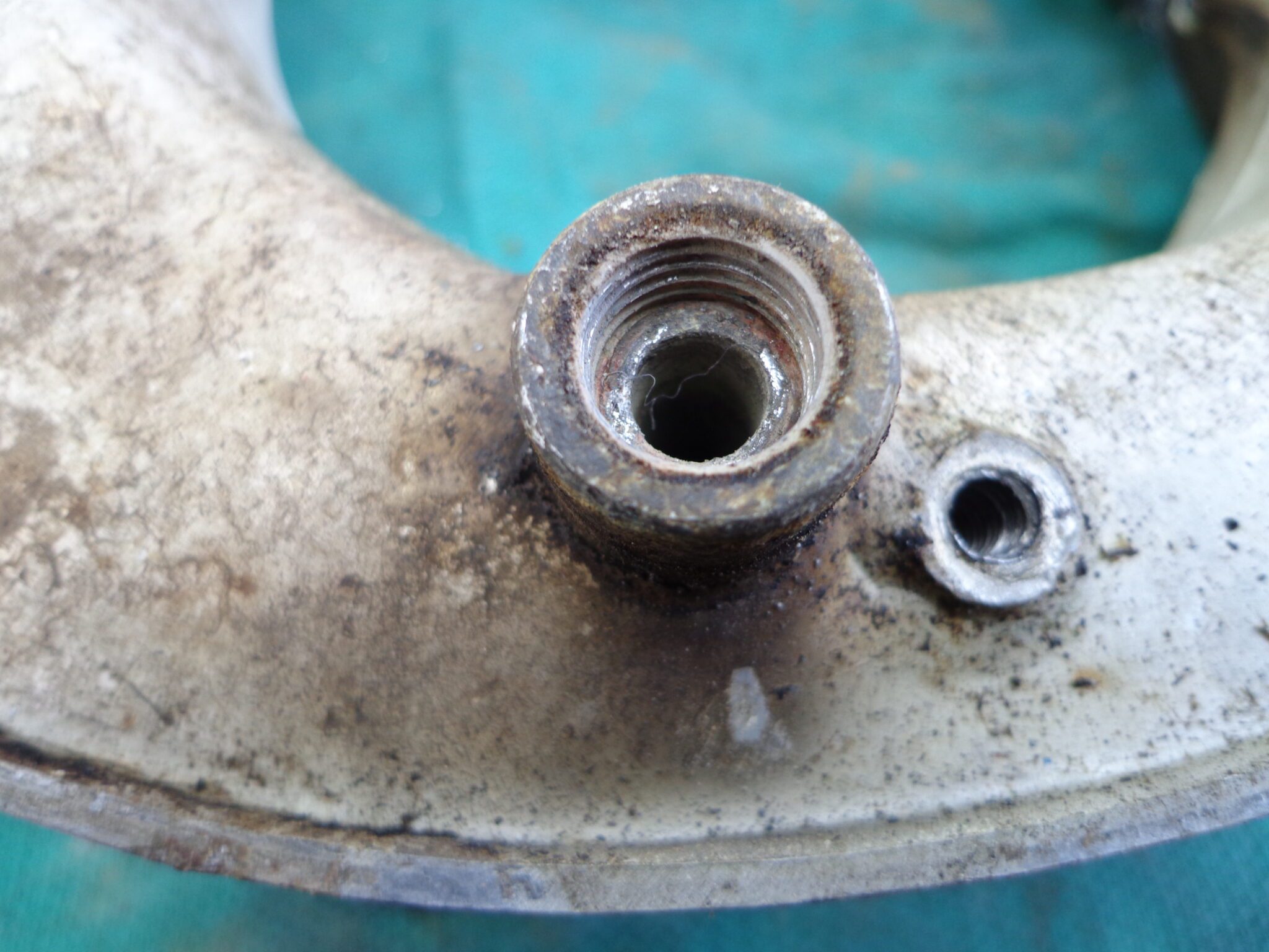

                #271481
                  When the filter breaks off inside the tank, I’ve removed them by first tapping them and then using a bolt with a nut to draw them  out. Once the parts have been thoroughly cleaned, a good epoxy can be used to hold them together.

                  DSC00014
                  DSC00013
                  DSC00017
                  DSC00018
                  • This reply was modified 3 years, 2 months ago by Mumbles.
                  #271491
                    Some more photos.
                    DSC00019
                    DSC00001
                    DSC00003
