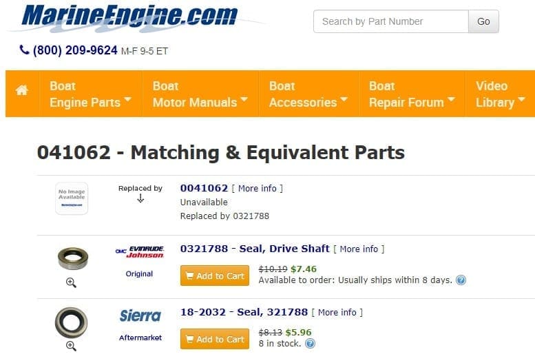

        Yeah Don, that’s the same seal. I think Frank R. had a formula for converting those numbers and I believe Garry shared this one awhile back that I saved. I’ve used it on MarineEngine and it works.
        Replace the dash with a zero
        41-62 becomes 41062
        Place a zero in front to make it 6 digit, or 7 if needed, it becomes 041062
        Punch that number in at marineengine and you get 0321788
        321788

        #159960
        Steve D
          041062

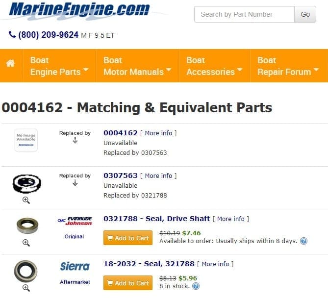

            Hm-m-m-m, seems to have worked. But the way I learned it is to simple toss out the “-” and insert enough leading zeros to make it 7 digits. Thus 41-62 becomes 0004162. It still comes up with the same result, so who am I to argue?
            #159966
            Steve D
              Cool, I recorded it wrong the last time you gave it.
              0004162
