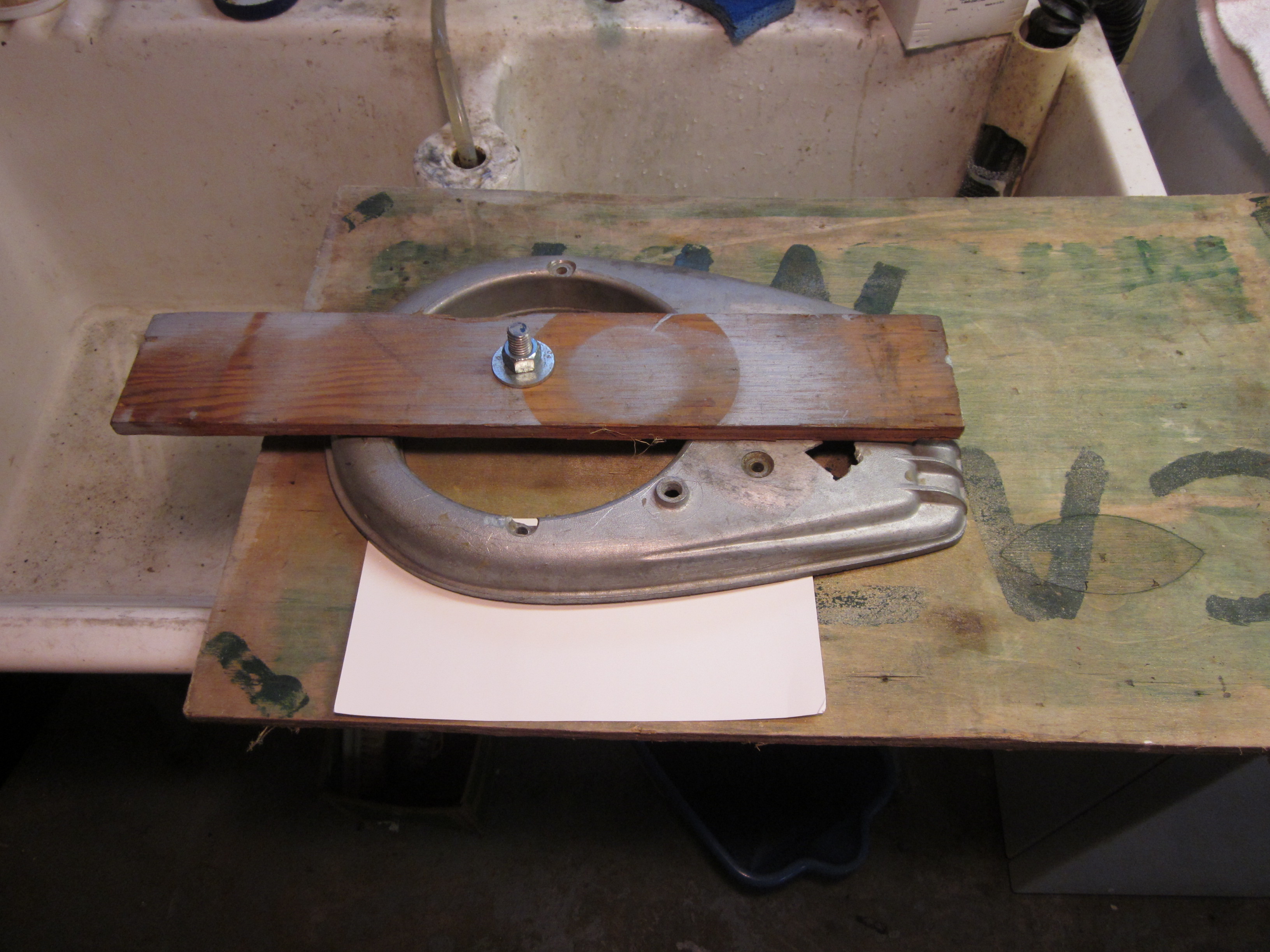

LouisDevice shown in photo is key to good results…cheap, simple and effective clamp. The tank is glued to the gasket material, then after SealAll has cured overnight the gasket is trimmed and
excess material removed.March 9, 2018 at 3:39 am #72243Louis don’t you think the tank might have a small leak with that large vent hole in the bottom. te. he.
March 9, 2018 at 4:04 am #72245You have a keen eye for fine details. Kiekhaefer (1941 Sea King single) More wrong with it than shows in photo. Needs a lot of welding.

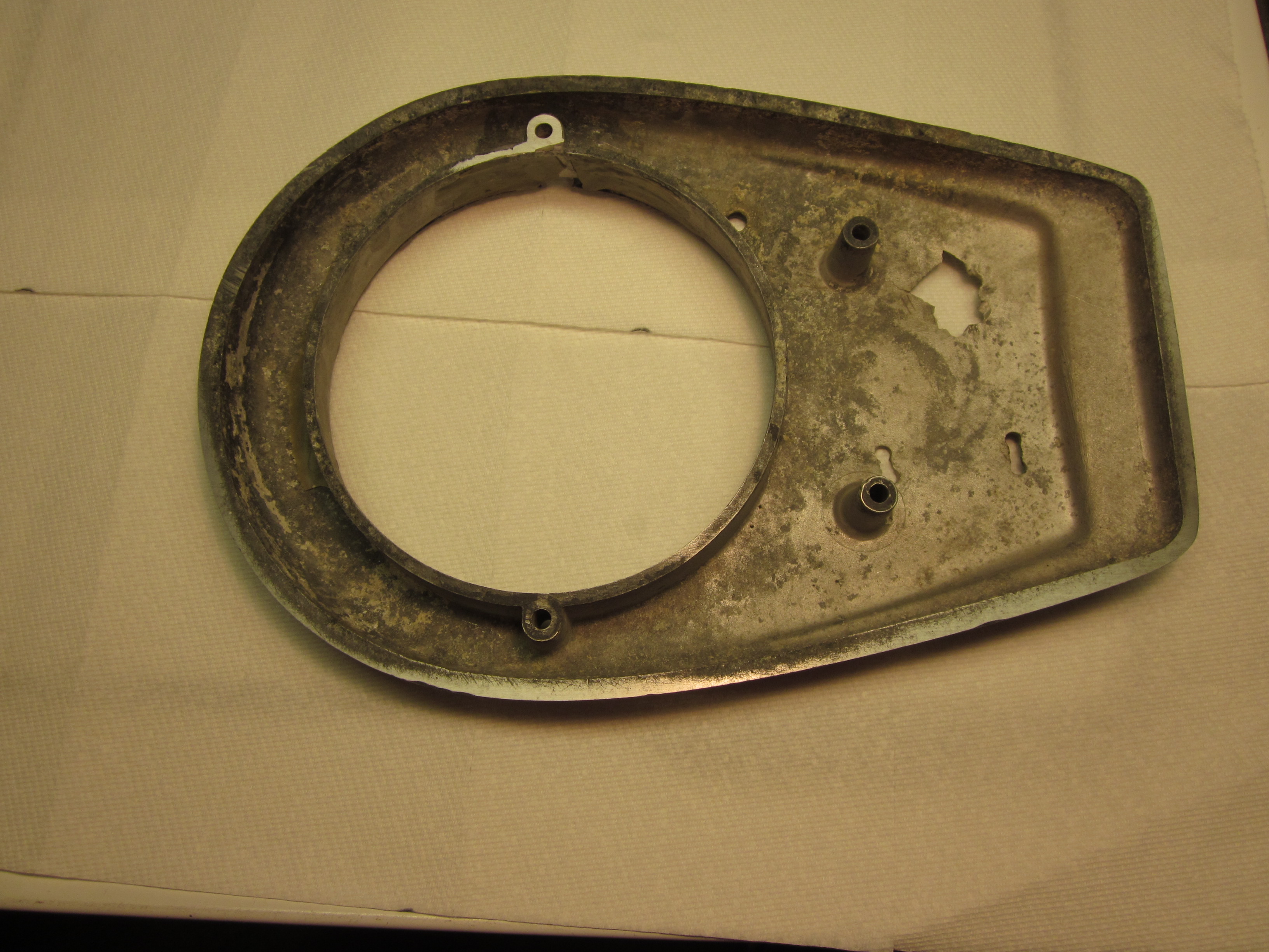

I am working on two early Kiekhaefer Mercury single cylinder gas tanks at present
The first one had warped seal surface, which has been dealt with
The second tank has a split gas outlet boss and a split in rear corner of top half.
In taking tank apart I noticed that tank had been sealed without gasket using a Goop like substance. Tank was not easy to open so I guess the answer to your question is Yes it can be
done with good results without a gasket.
I will use a gasket and SealAll onntank #1 as I have had good results, more time and effort ,but, I am pretty sure I will not have to do it over.
Tank #2 I will grind seal surface of flange. Best repair would require some welding and possible distortion stress. So maybe more sanding later. Epoxy gas tank repairs I have seen
appear temporary fixes ,however , no distortion. Cost is also a factor.

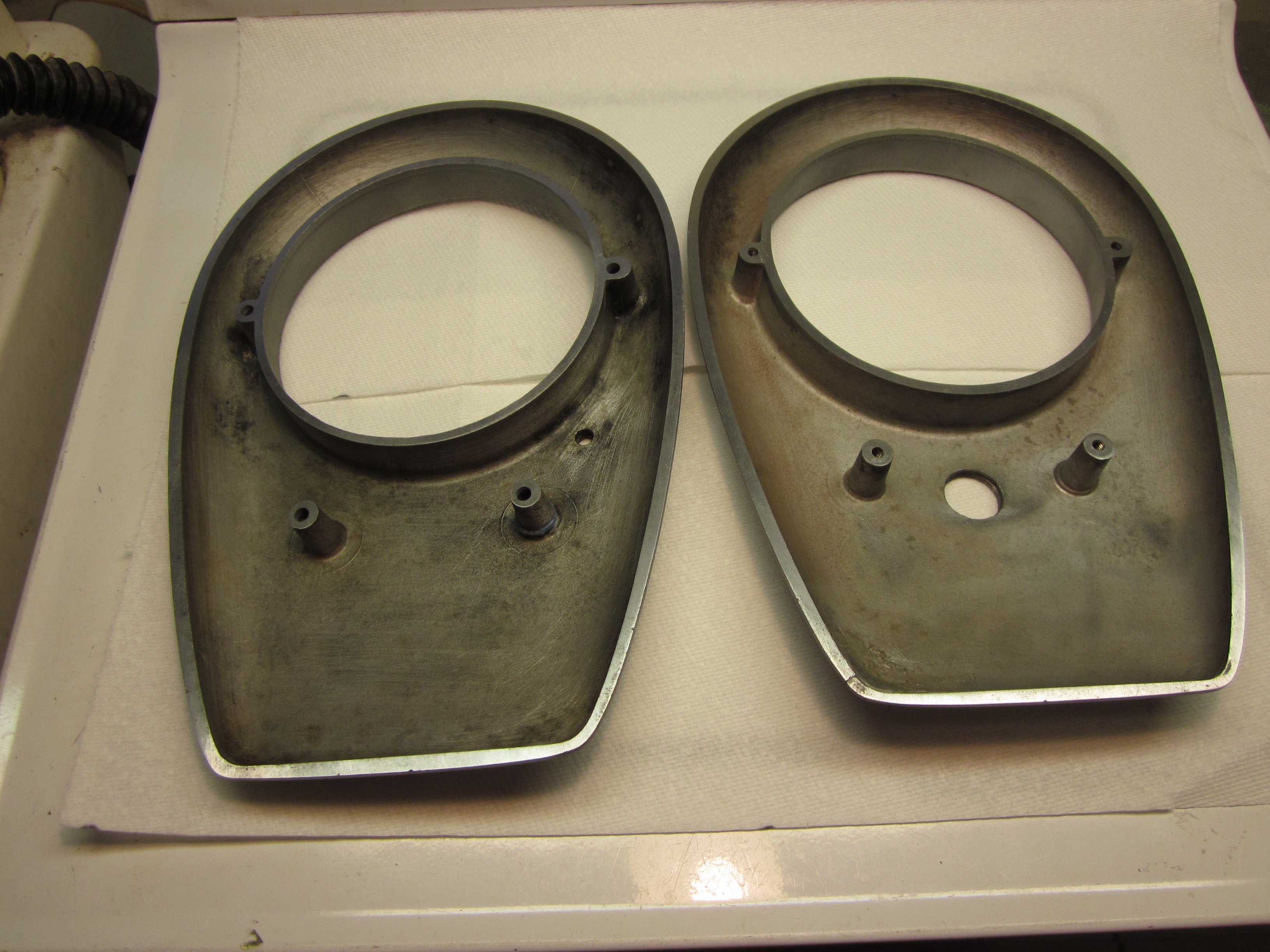

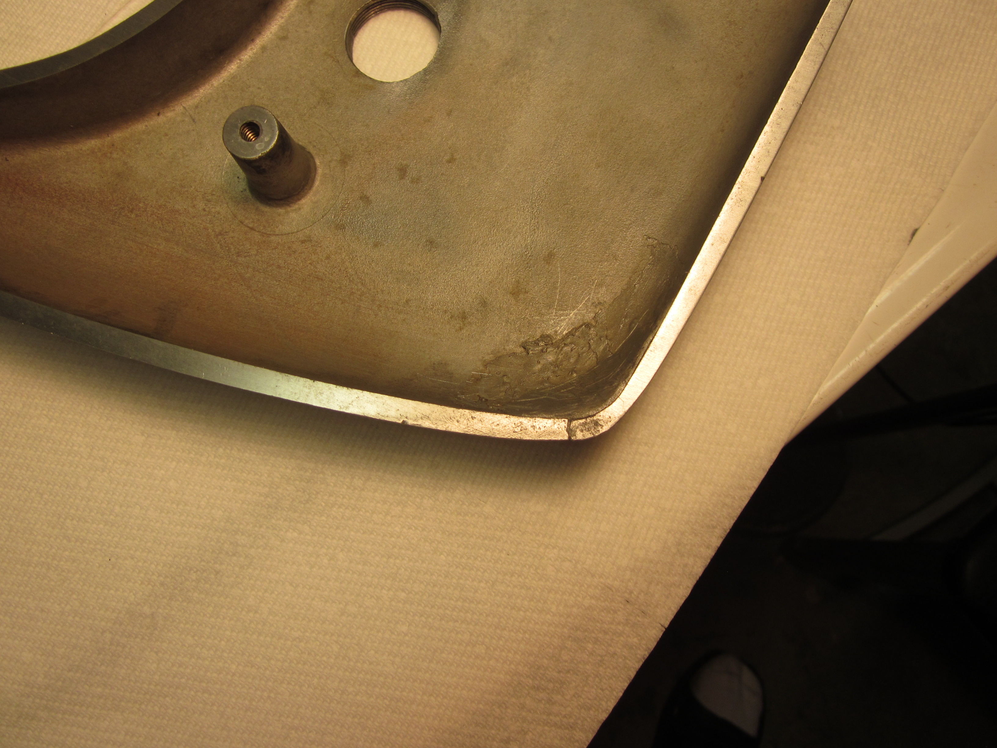

LouisMarch 13, 2018 at 12:51 am #72420Wrapping up warped tank subject.
Ground tank #2 surfaces and they are close match
Crack in corner may or may not be a problem
Someone asked it a corroded seam could be ground flat again…junk tank half had a corroded
seam (and other issues) A few minutes rubbing on wet or dry show a great improvement
Tank is cracked and break stands out so only part of seam could touch sand paper.
Trial indicates corrosion is as easily repaired as a warp.
