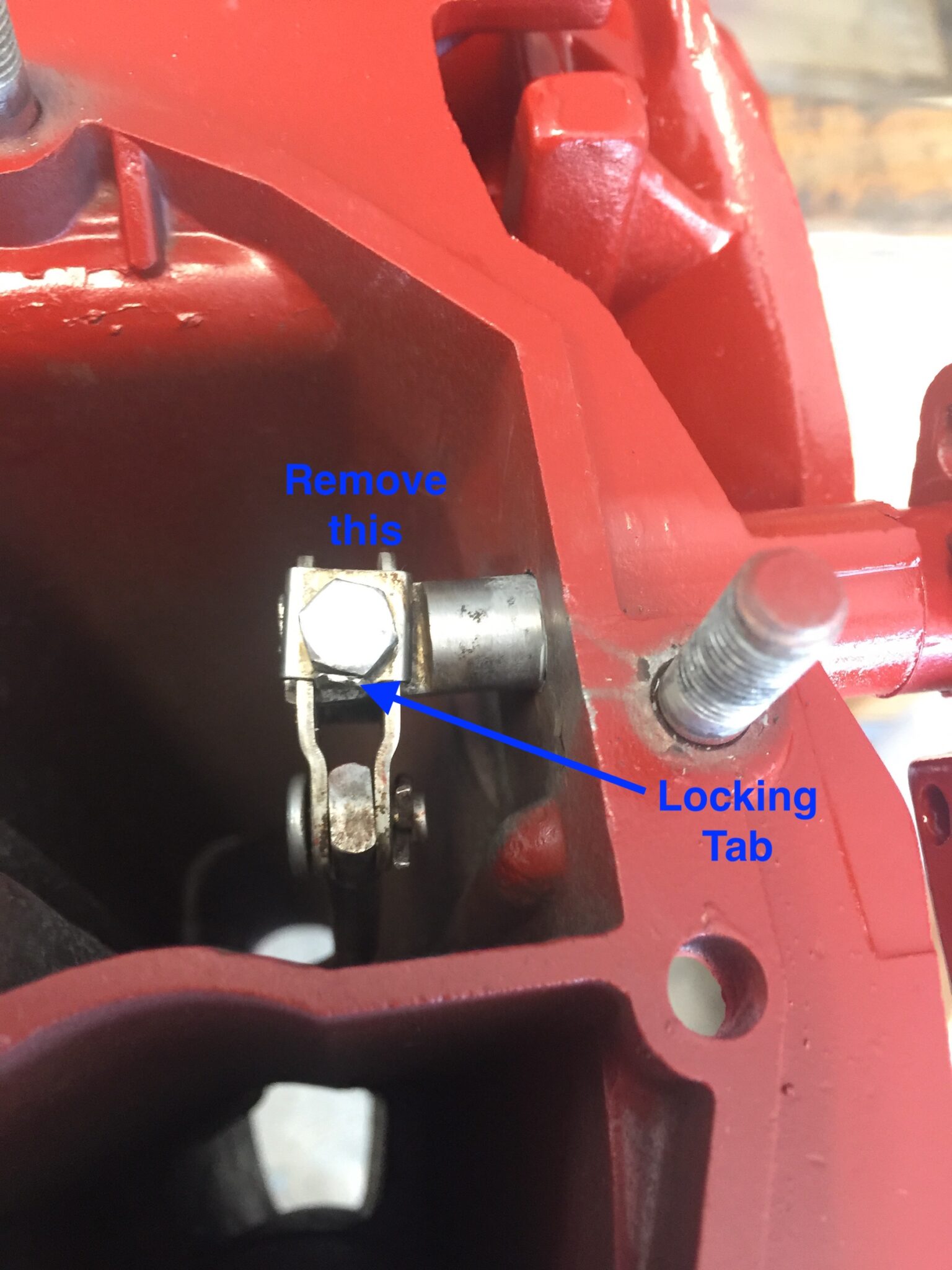

July 6, 2023 at 11:17 pm #277787Yes, you have to pull the powerhead to access the shift linkage and remove the shifter handle. I just finished a resto job on and FD-12. Here’s what the linkage looks like after you pull the powerhead. Bend the locking tab down, remove the bolt and pull the shift handle out.
