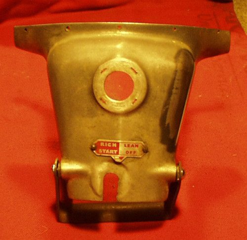

October 20, 2025 at 8:21 am #300776I have a front faceplate for a Waterwitch twin.
Is this the one you need?
October 20, 2025 at 9:10 am #300779Good morning. I’m not sure, I think the one I need is more squared off but I may get that one to work as they are so hard to find. How can we close the deal? I live in NC.

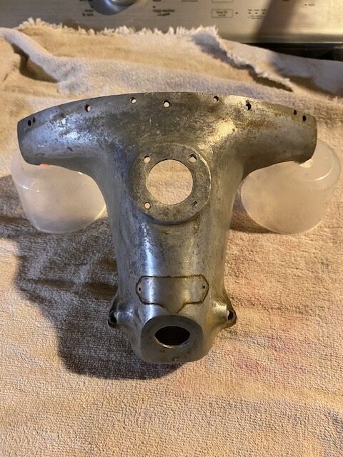

Your cover is correct for the 1937 Model # 571-20 and the 1938 Model # 571-21. The 571-22 front cover looks like this.
October 20, 2025 at 10:41 am #300783That is the one. Is it for sale? Dave
October 20, 2025 at 11:04 am #300788
Just have the picture. Sorry
