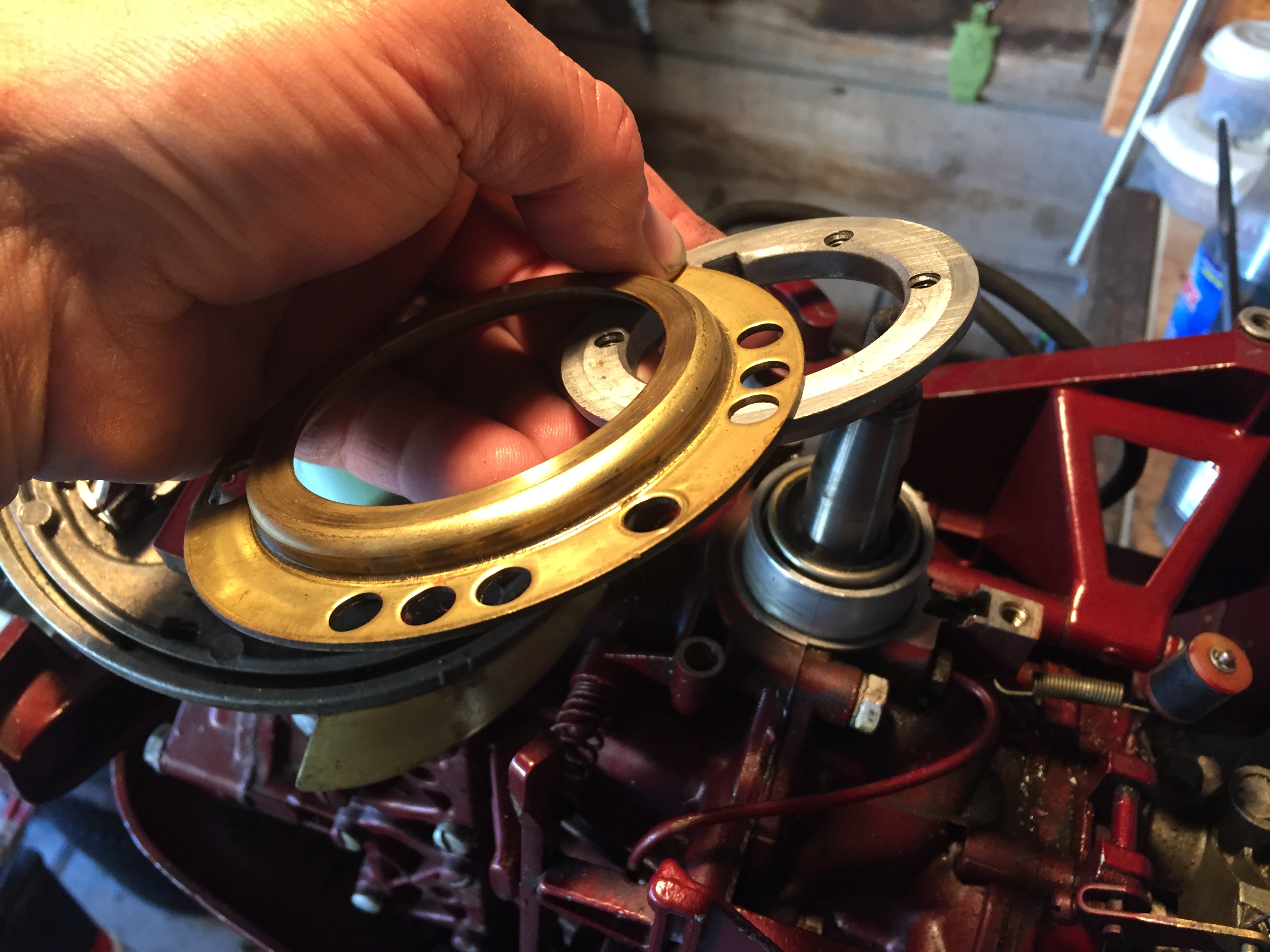

            #59089
            opposedtwin
              Well that was a cinch! Never removed one with this tool before, but it sure made it easy! Thanks Richard!
              So to reinstall a new seal, i just tap it in with a piece of pipe or something that has the appropriate diameter? How will i know when it’s properly seated?
              Scott

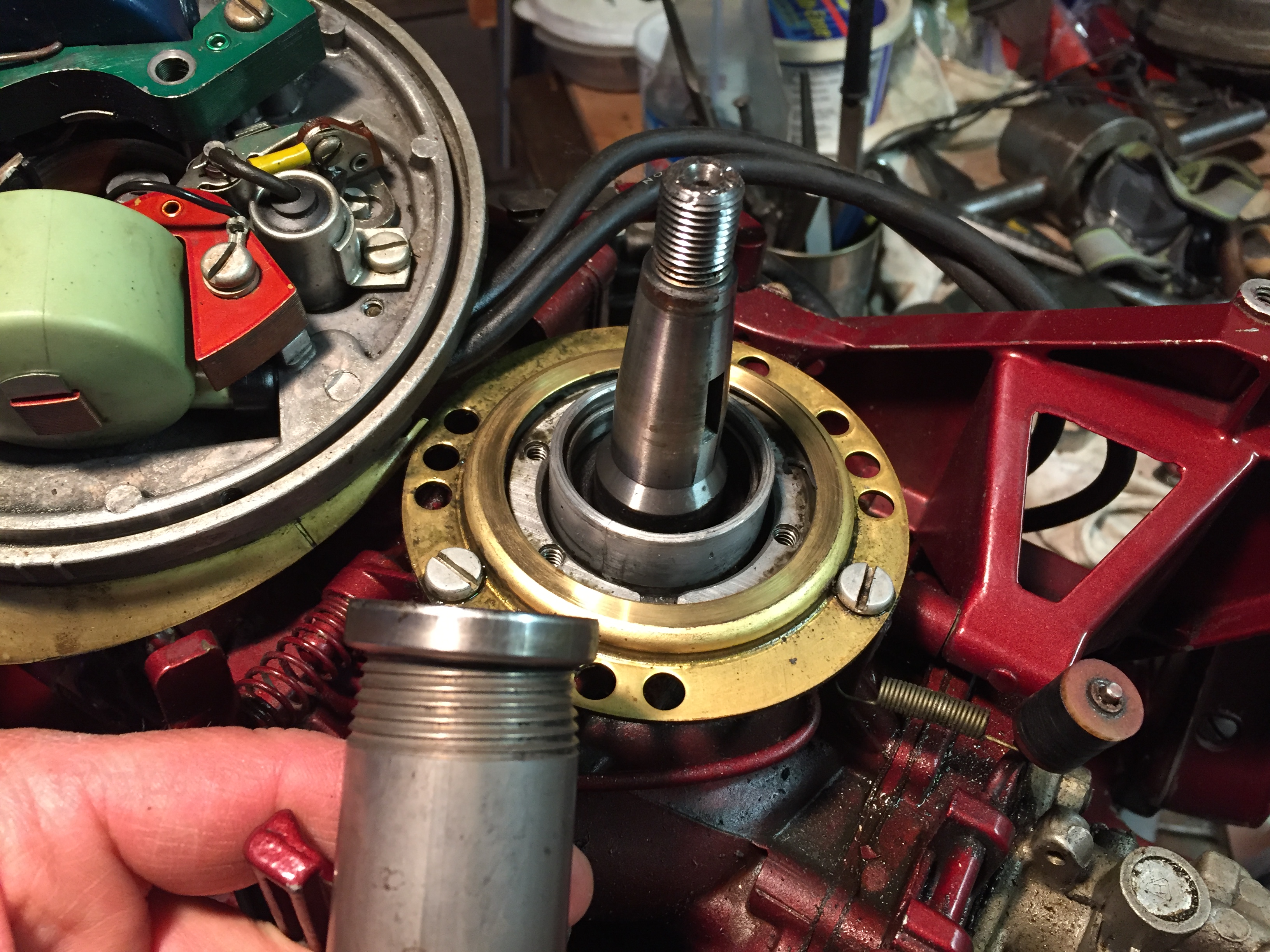

              #59111
                You can use a deep well socket, if memory serves, of the proper size, of course
                #59145
                chris-p
                  Well………….that is a tool on my list for Richard to make! 🙂
                  Short of that, a piece of ABS or PVC pipe works well. I prefer not to use a steel tool, unless its stepped, you can damage the seal.

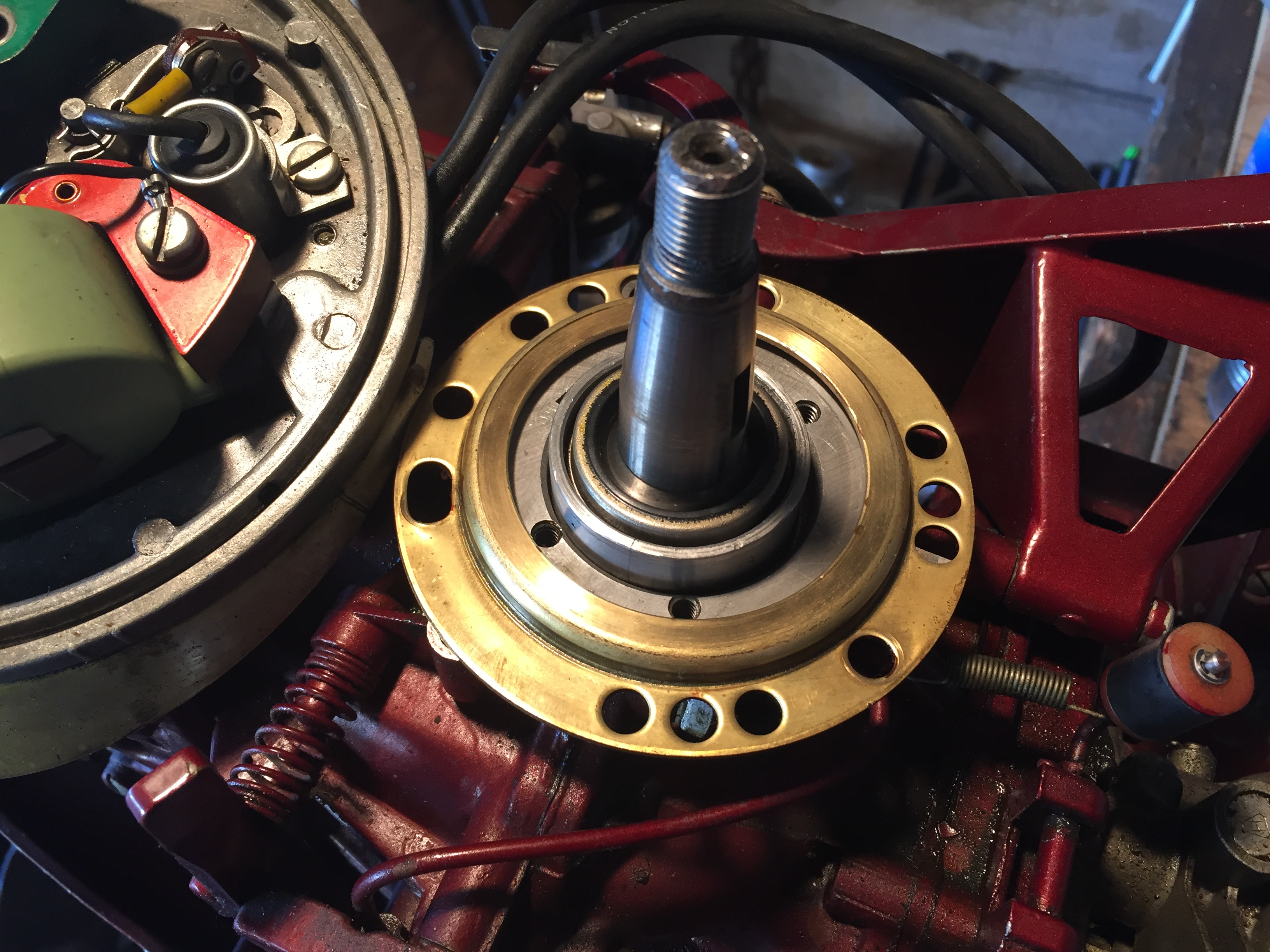

                      #59430
                      opposedtwin
                        Ok, got a new seal and a crank key. Haven’t found the right diameter pipe to set the seal in yet but that will be next. (I agree that Richard should make the tool and sell them with the seal puller as a set–would make the best father’s day gift ever!)
                        I seem to recall Frank telling us once where these 2 parts should be lubricated and where they shouldn’t be lubricated. Frank, are you out there? Also, is white lithium grease the stiff to use here?
