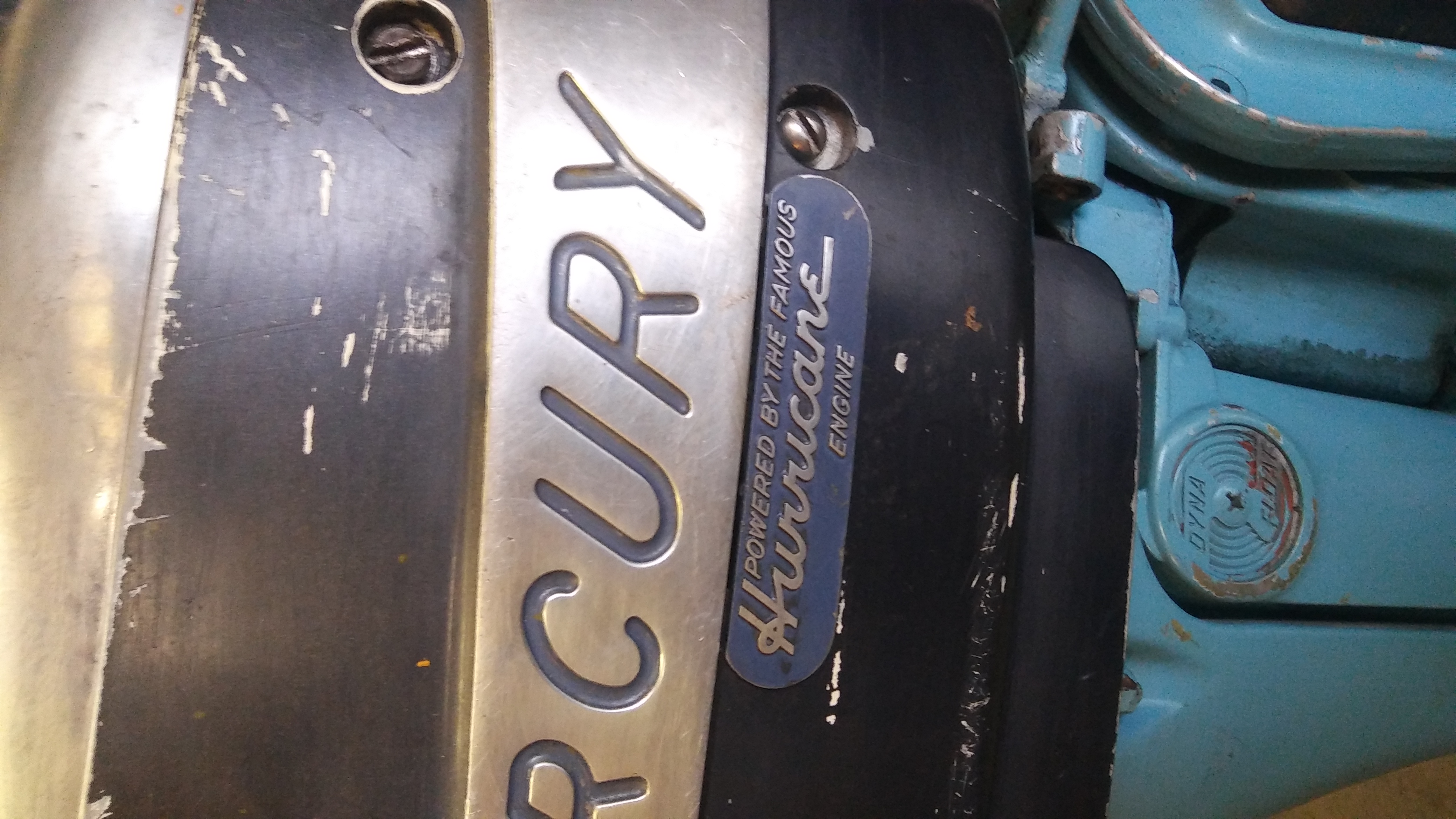

      What is your guys opinion on this motor? Good buy? Bad buy? Would you says its been restored?
      http://www.ebay.com/itm/172662377111?ul_noapp=true
      Thanks
      Jason
      #57608
        I don’t know if it has been "remanufactured" as he claims, or not. It obviously did get a paint job, you be the judge of the quality.
        #57609
          top of the line price to me. but area has a lot to do with price.
          #57610
          kevinrude
            very first picture, under the CURY of MERCURY, there is a fairly obvious patch job, FYI………………
            #57611
              Lemme think–was that where the remote control used to hook up?
              #57612
                Yes Frank that it is…some kind of cover is now there, did not know one wa ever made for that???
                #57613
                bob-myers
                  Yeah, it looks like someone filled in the area where the remote control was attached to the throttle and spark. Mercury made a cover for that access whole.
                  #57615
                  tarcigam
                    Looks more like a GM truck paint color than a Mercury green. I would guess painted, not "refurbished" Personally, I would pass at that price.
                    #57617
                    JOHN D.
                      Here’s that plate. I don’t think that is a factory correct color as implied. May be a good runner though.
                      #57620
                      SCOTT BOGUE
                        Given that Mark 25s can be had for less, the somewhat improvised repairs and the casual paint job would keep me from inquiring further.
