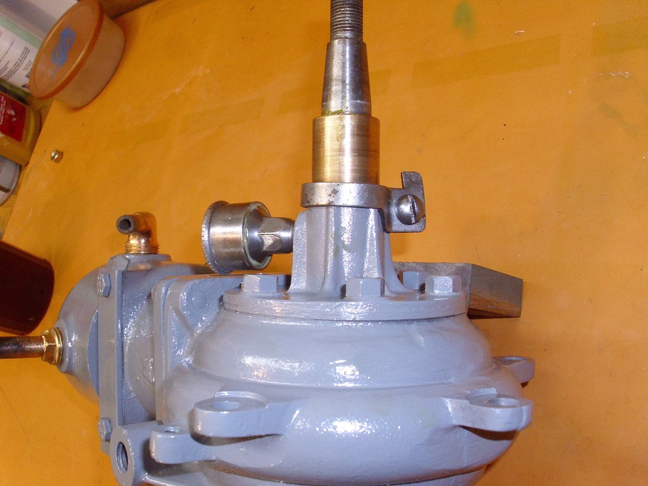

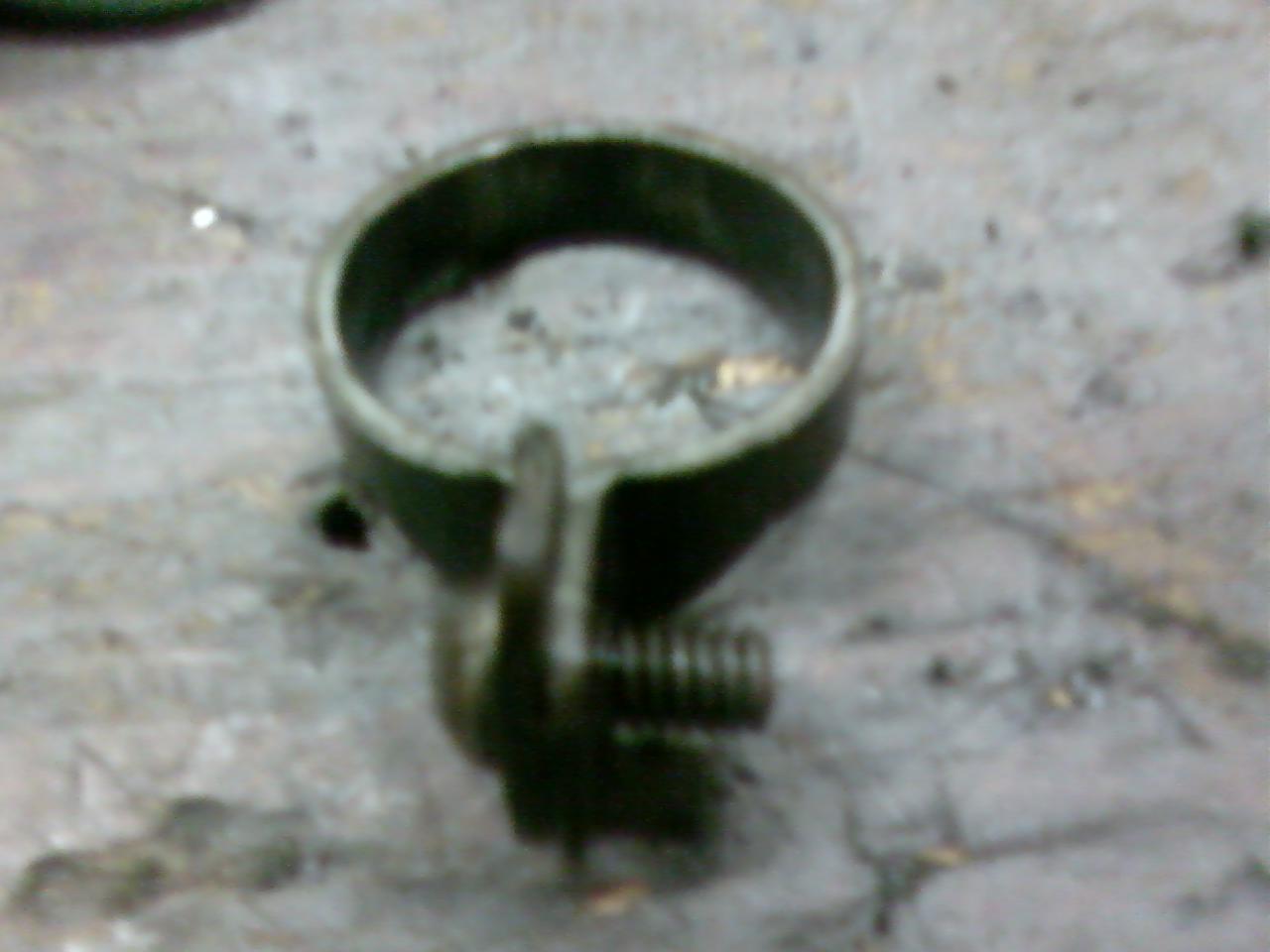

      I found this under the mag plate on my ’22 Evinrude single. It was loose on top of the crank case hub.

        Its a stop for the magneto. You set it so
        you don’t advance the timing too far.

          it’s an advance stop for the mag plate

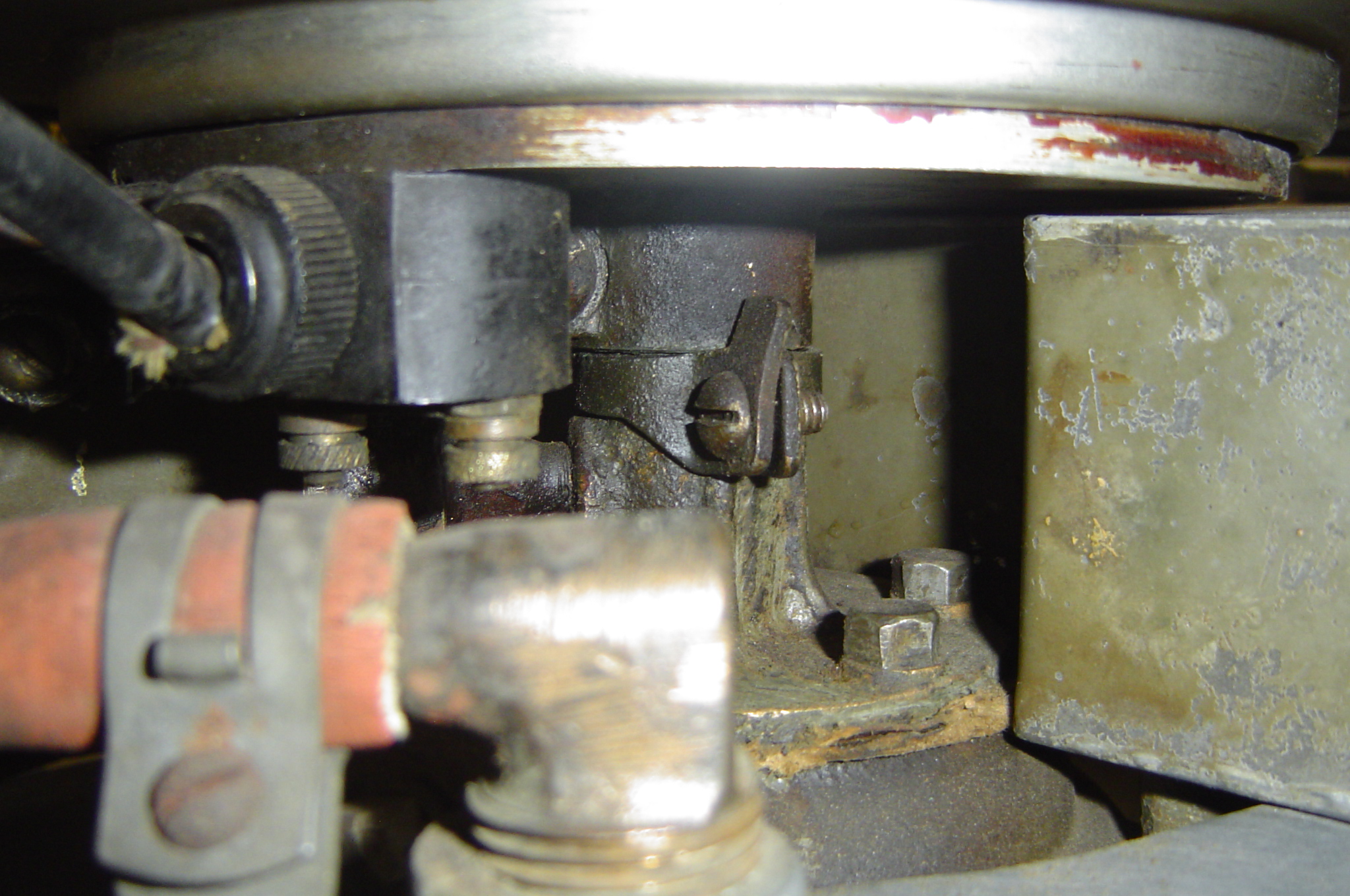

            I found a photo of the stop on an original ( unmolested??) motor

              Thanks Tubs and JoeCB. I see how it fits on the webbed part of the hub.

                The Model N Sportwins had the same thing.
