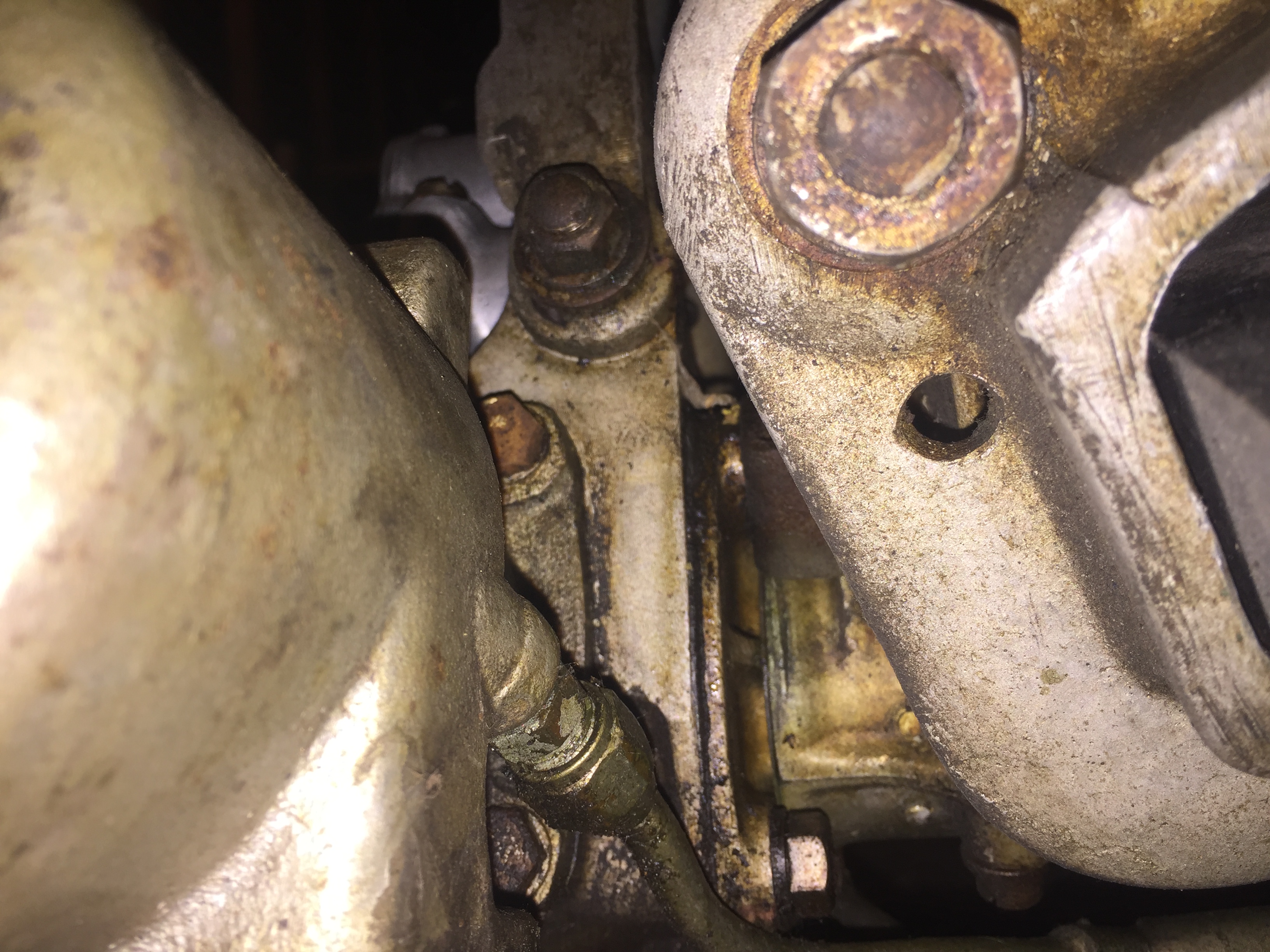

      Is this the area that should have the serial no. ?
      #70493
      smokeonthewater
        Well, my pictures turned out awful of the area behind the exhaust. Also having trouble uploading what I have . (Iphone nonsense in all probability) There is one square acess panel on each cyl. that is blocked off with a plate and a screw in each corner. I’m not sure what that is all about, in contrast to Tubs’ picture.
        I thought I knew something about these motors…..
        last week I was writing about an Evinrude Mate and was stumped… and now this!
        …. I have to admit I’m having fun!
        I’ll try to upload the other pictures

          #70509
            That is where the numbers should be so
            knowing that the high speed Speedster
            had aluminum connecting rods that were
            known to fail I would "speculate" you have
            the remaining parts from a H Speedster
            that had a catastrophic failure, a factory
            replacement block, and possibly some
            other factory replacement or parts
            cannibalized from another motor. Or could
            be somebody’s Hot Rod or competition
            motor built to out perform the stock motors.
            Not having all the correct parts takes away
            from its historic as wall as its monetary
            value but has no negative effect on the
            enjoyment that you will get from running
            one of these.
