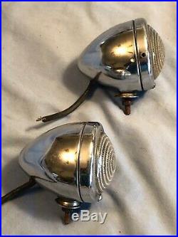

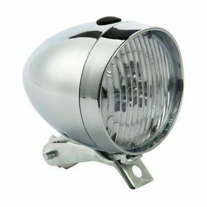

        Well, I am working on the same project. I thought of using either a vintage accessory B-31 backup light, or an old bicycle headlight. Both are 6v, and take small 6v bulbs. I have a couple of B-31’s on my Cushman scooter front fender.
        GUIDE-B-31-Vintage-Cowl-Parking-Reverse-Back-Up-Fender-Turn-Signal-Lights-6-Volt-03-un

            Yes, I have two Waterwitch motors a single and a twin, with the female plug. I have to come up with the male part, and put a couple of lights together. The lights don’t care if they are AC or DC. I think the amperage draw will be the determining factor on which bulb to use. The bicycle lights used a small 3 watt screw in bulb. The B-31’s use an automotive bayonet base which draws more wattage. I’m not sure how much. What did you use for the plug you designed?

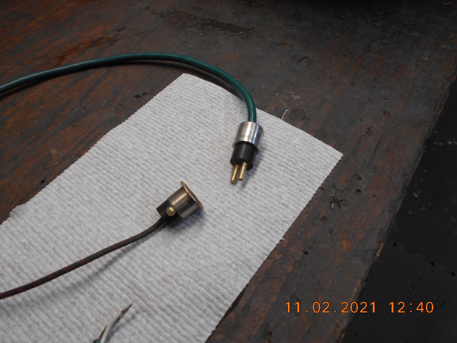

              I made up a male plug using Derlin plastic rod,
              brass pins, and an aluminum nut.
              I’ll take some photos of the finished plug this afternoon.

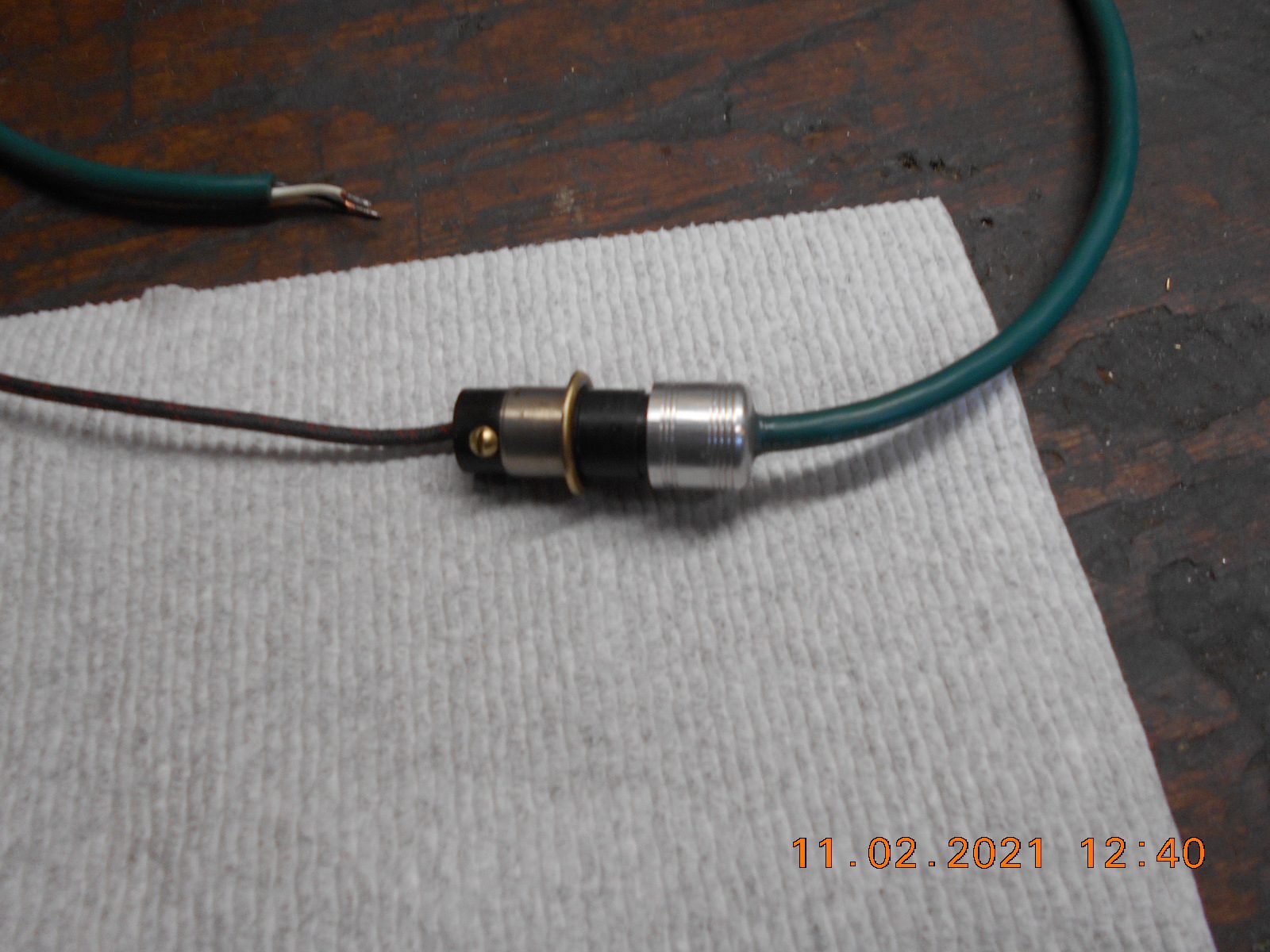

                        Here’s the male plug I made up with a short cord to hook up a future light.
                        It took me all day to make it, but what else is there to do when it’s
                        31 below in the morning, and -6 for the high.
                        DSCN2552
                        DSCN2553
