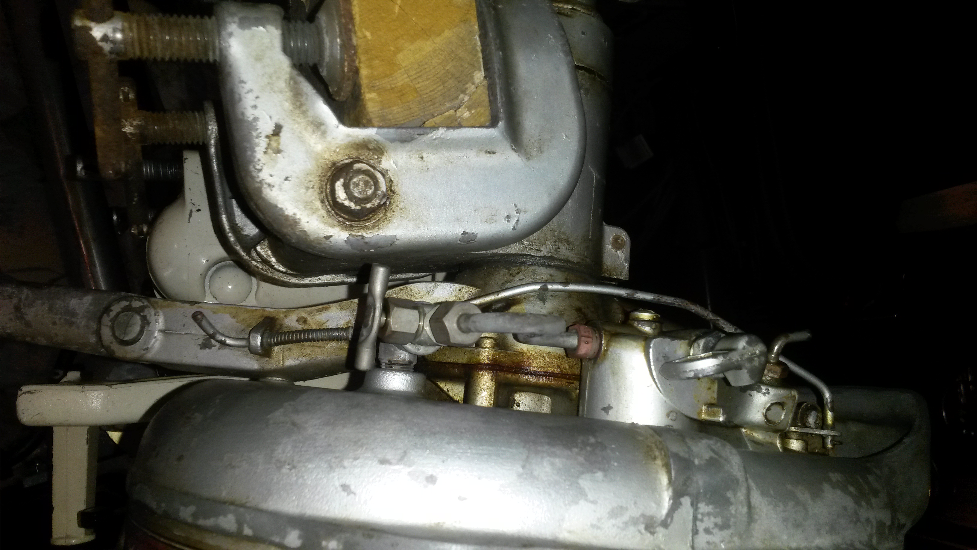

      This little protrusion with a hole through it is on the casting the crankcase sits on and tiller attaches to.See it on Johnson HD & HA models,but have never seen anything attached to it .
      #44149
        Not a omc guy but I would think it is so the bolt tightens tightens the tiller mount.

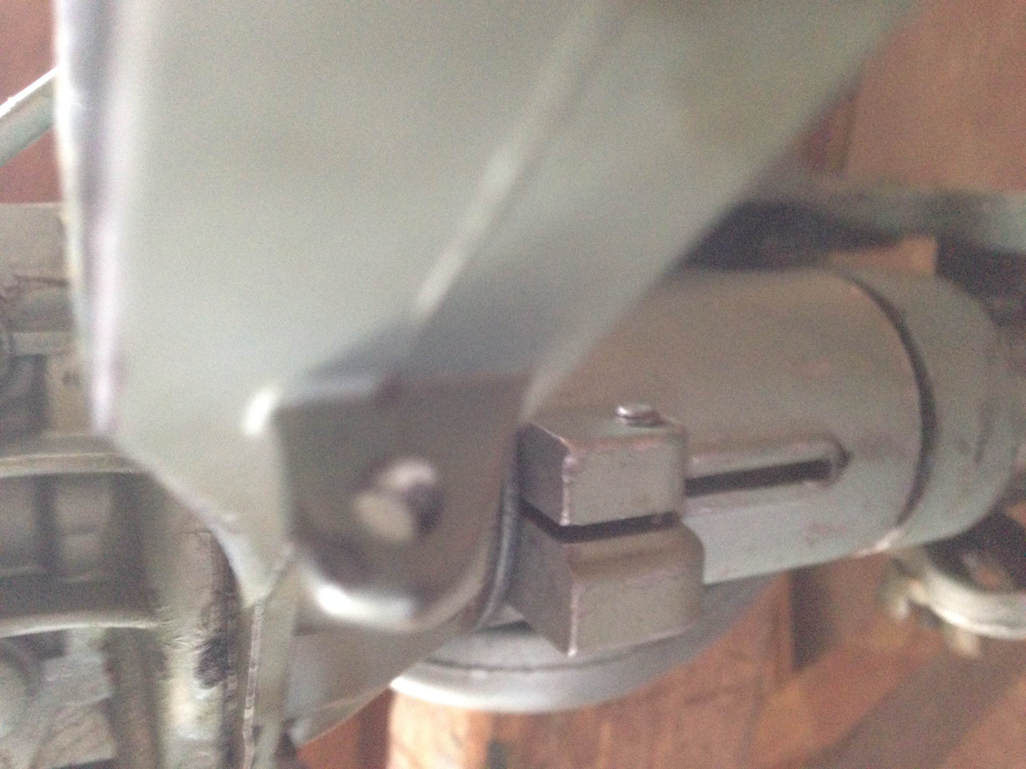

        stanley
          Here’s a better picture.

            A place to tie a rope to tether the motor to the boat in case of a clamp failure? Just a guess.

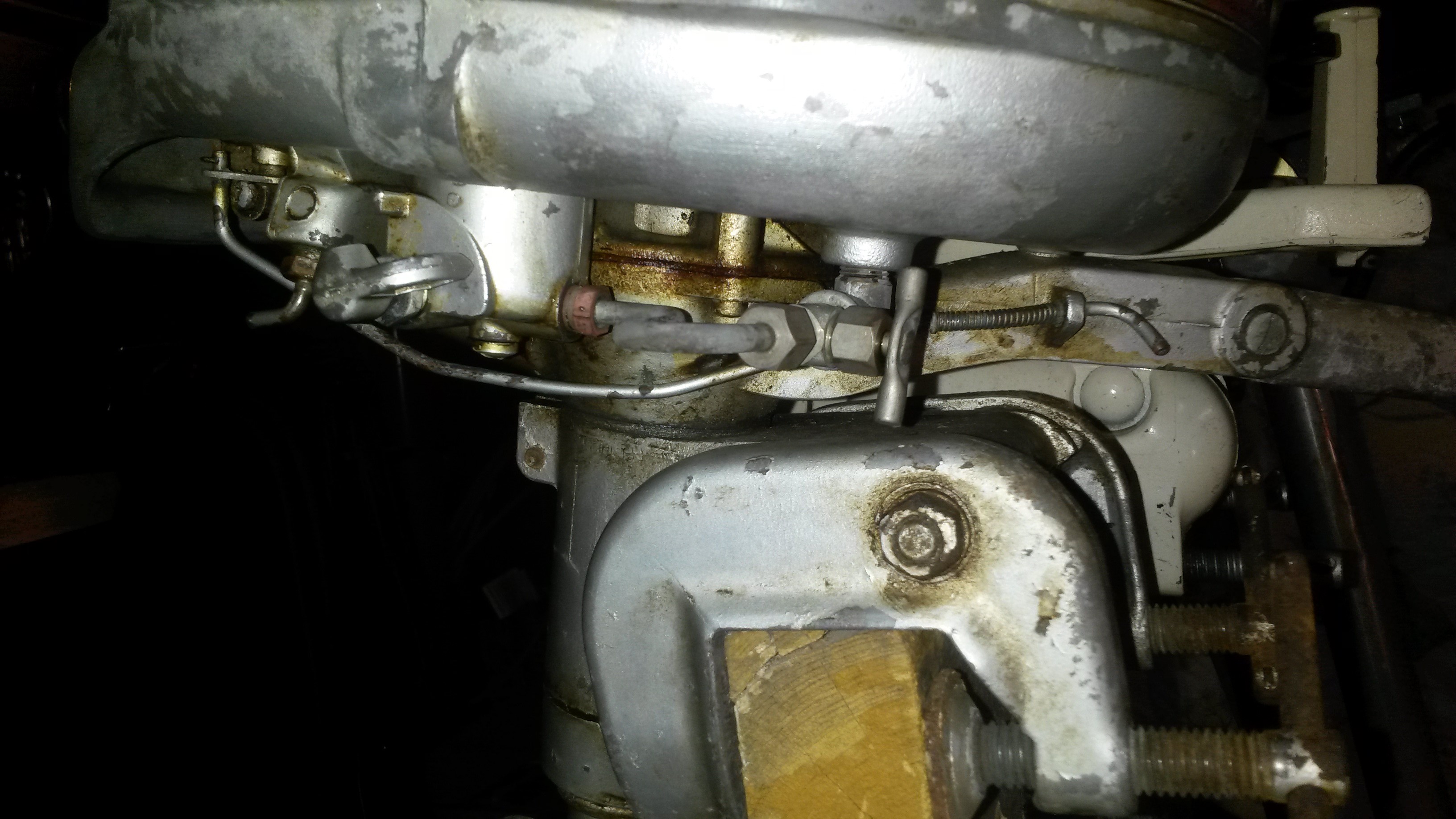

            ray-schaber
              On some models a spring loaded choke pull went there.
              Ray
              #44162
              nabmd
                I have an Johnson MD-15, ’40, with a spring loaded choke lever that goes through the same spot.

                  nabmd
                    sorry it is upside down; I’ll figure it out later.
                    #44202
                      How’s this?
                      #44204
                      opposedtwin
                        Thanks nabmd! I thought that would look familiar!
