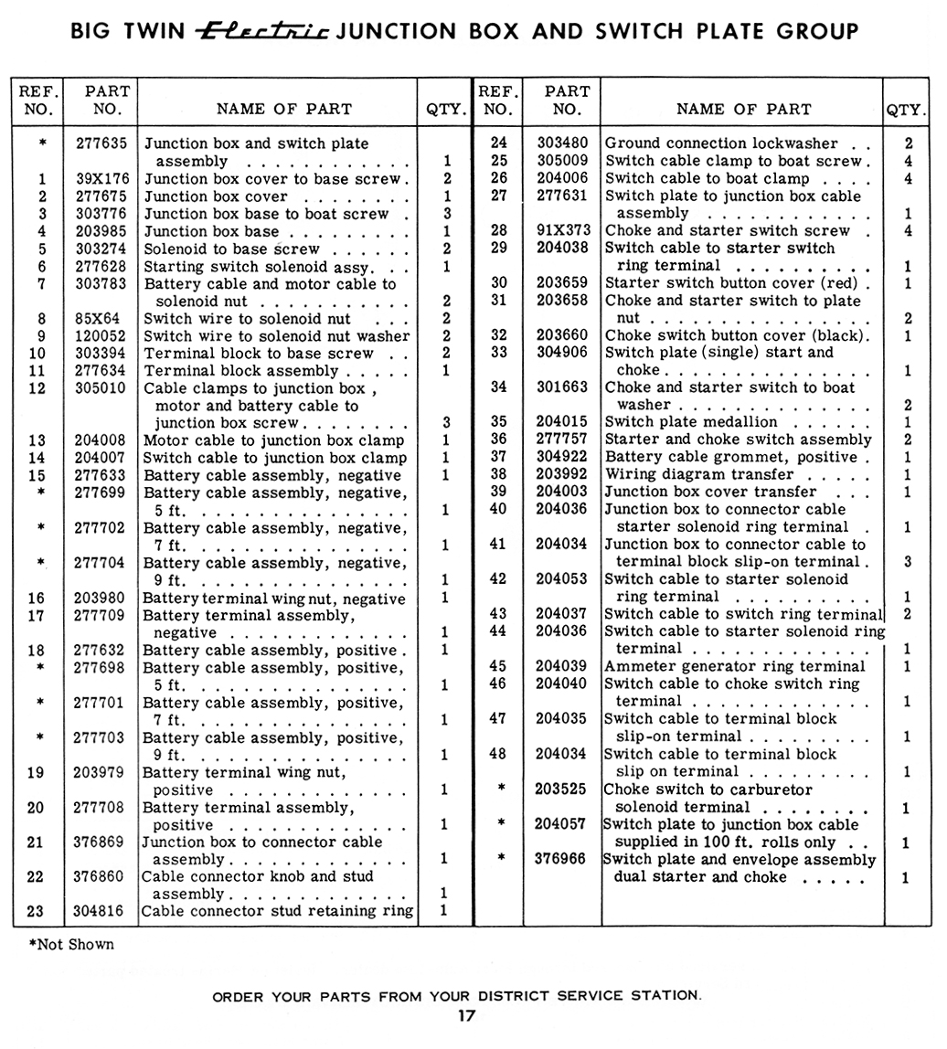

      While I’m doing that, anyone have a parts numbers for the junction box for a ’57? One of the few that they don’t have on the website

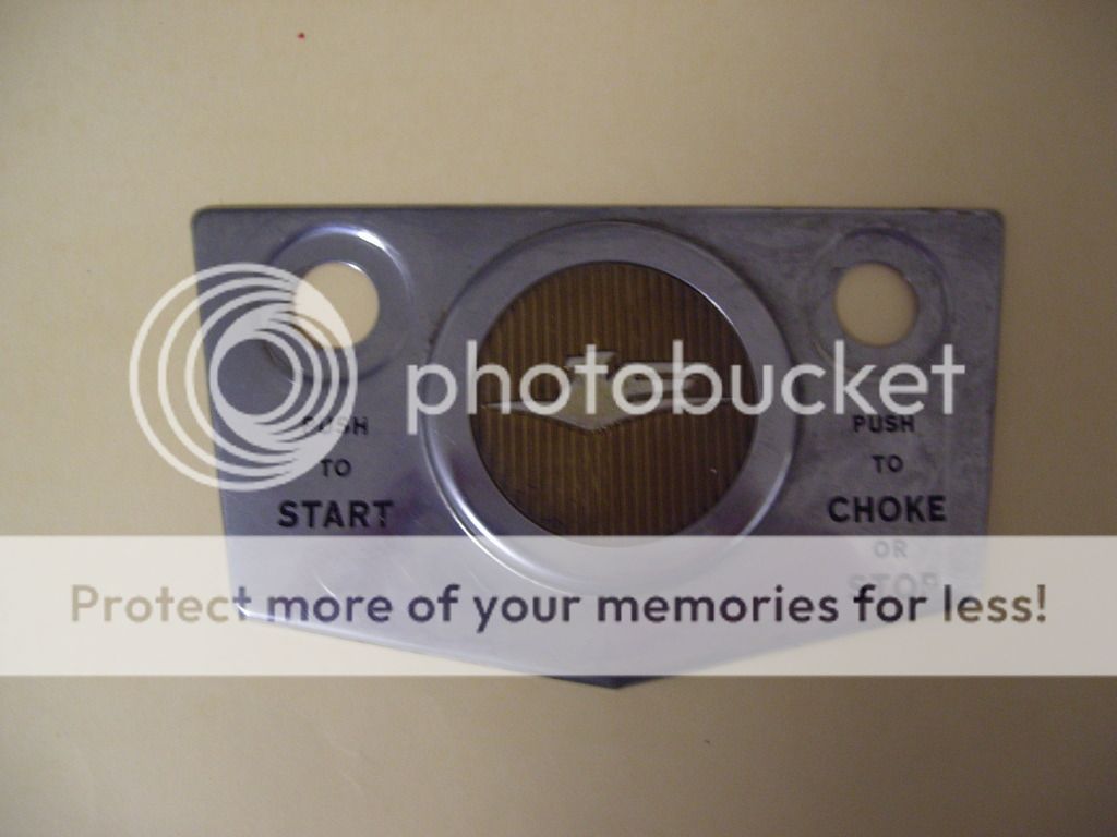

        Can’t resist – Would this be 1956? The center emblem is loose.
        #50975
        fisherman6
          I’m pretty sure that one is 1957. I believe the ’57 medallion had vertical lines and the ’58 had horizontal lines. The ’56 motors had the Sea Horse outline on them like the earlier green motors. If I’m wrong I’m sure someone will correct me.

            1956 took a very small plate that looked like the letter D with the flat side pointing upward. About 3" wide and only two push buttons, no medallion.

              ….and the small 56 plate also said "push choke to stop".
              Note that the medallion plate was discontinued for 1960 when the automatic choke was introduced, so it only had a three year run.

                Here are the part numbers you asked for. . . 😉

                  1956 did not have the medallion or ammeter hole because the generator kit had not been offered yet.

                      Garry, thanks for the part numbers.
                      A ’56 is in this thread
                      viewtopic.php?f=2&t=8925
                      That one yours, if so would you be willing to sell it? As mentioned, I do need on that says "Push To Start" instead of "Turn To Start"
                      #51105
                      olcah
                        Mr. Asa, I am also planning to set up electric start (on a 1956 Johnson 30 HP ) so will keep the plate for now. Maybe another member has an extra.
