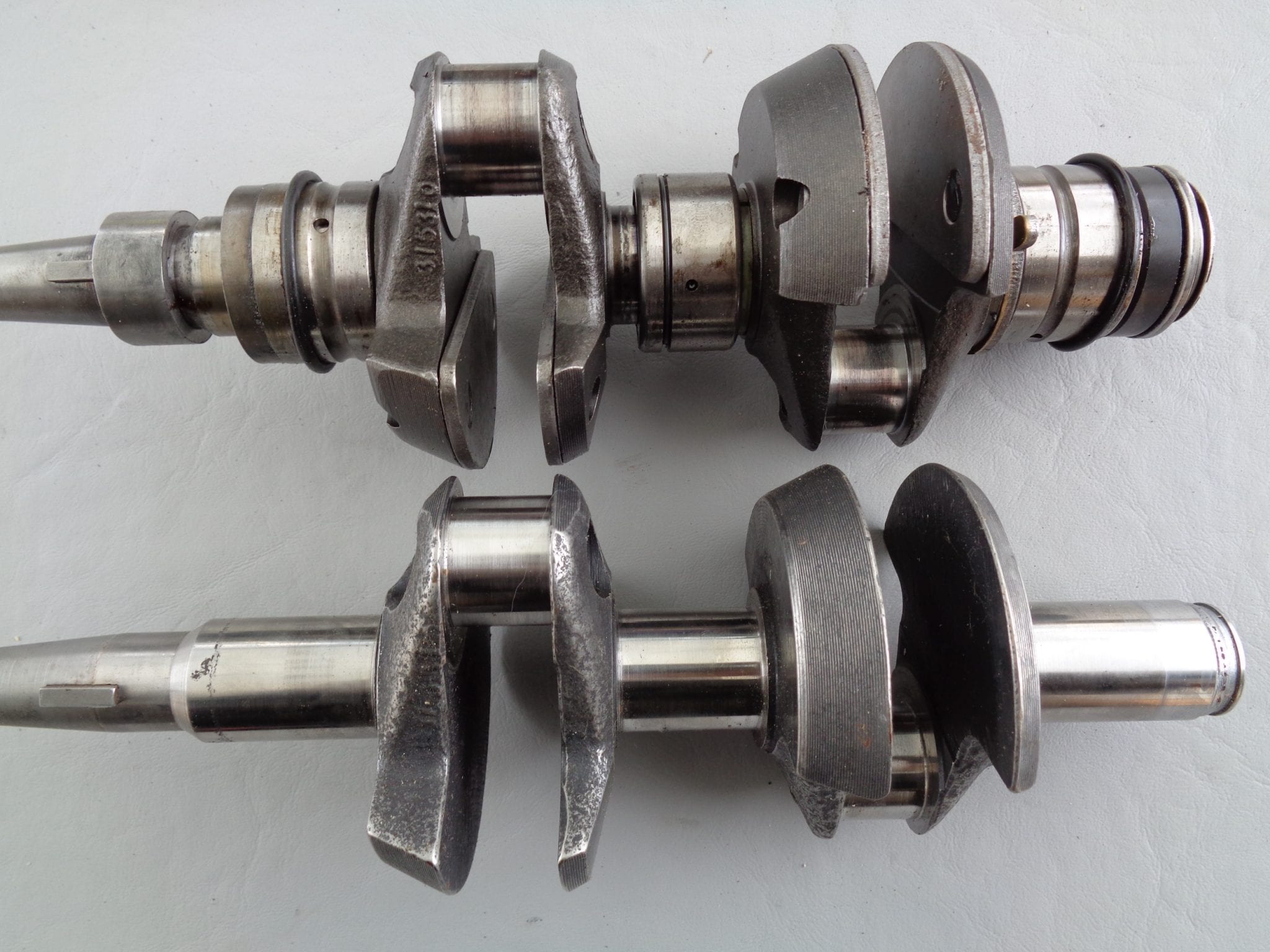

      there does seem to be a groove visible in the last pic i posted above. Is that the groove you’re talking about or is it lower, behind the existing seal?
      #219614
        On these QD and FD cranks, you can see the sharp groove on the right to retain the clip.
        QD-FD-Cranks

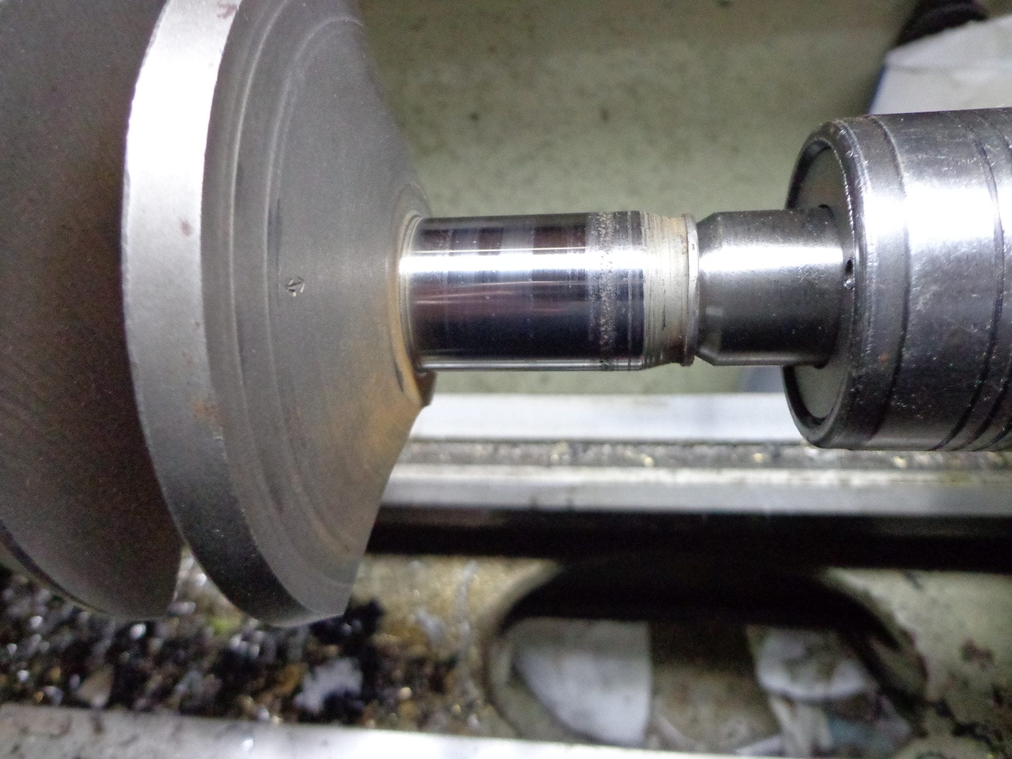

        Not like this Big Twin crank designed for a lip seal.
        58-Big-Twin-Crank-Polishing-009
