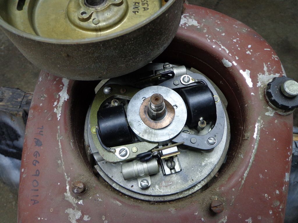

      I got the flywheel off the Elgin today, and found this’
      Does the integrity of the coating (rubber, plastic?) have an impact on their function? Can I just wrap them in a good electrical tape and, as a former boss would say, "race on it"? I do have the missing chip. I just left it out of the picture for clarity.
      Thanks.
      Stan
      #21983
      joecb
        those coils are "shot" … moisture intrusion = corrosion

            These can be replaced with OMC universal coils, just replace the coil and not the metal.

              I have a second, almost complete motor, same model and all. My original hope was to get both running, but the one is too far gone. I’m having trouble getting the second, or "donor" flywheel off. I don’t have a real puller, but I used a homemade one to get the first one off. So, I hope the donor unit has good coils. But if not, I saw on the Oddjob Motors site the thing about OMC, or Sierra coils fitting right in. I found the Sierras for about $20.00 a piece.

                If you get real lucky the donor motor may have the old orange shellac coils. Those things are bulletproof.
