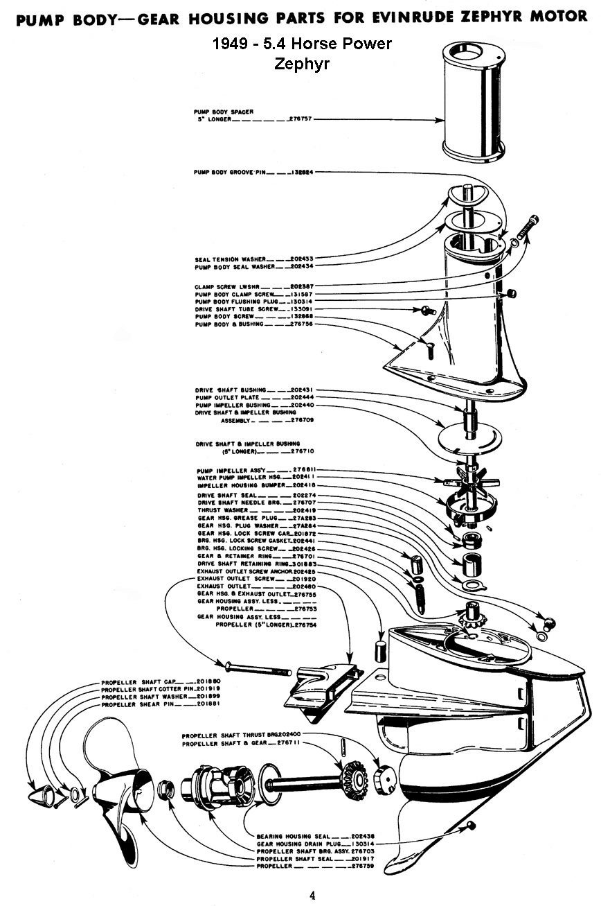

            Here’s a parts diagram for the 1949 model. This was a 1 year and done model for the last year of the Zephyr. I view the gearcase as the predecessor of the “weedless” gearcases on the 1952-1967 OMC 3 Hp motors. Quite different from the earlier Zephyr gearcase.

              The above diagram is for the later model. My grandson’s has the earlier slip clutch type prop. I machined the phenolic washer and it worked great! That allows the prop nut to create extra tension on the cone spring and the phenolic prevents contact between dissimilar metals. His motor runs great!
