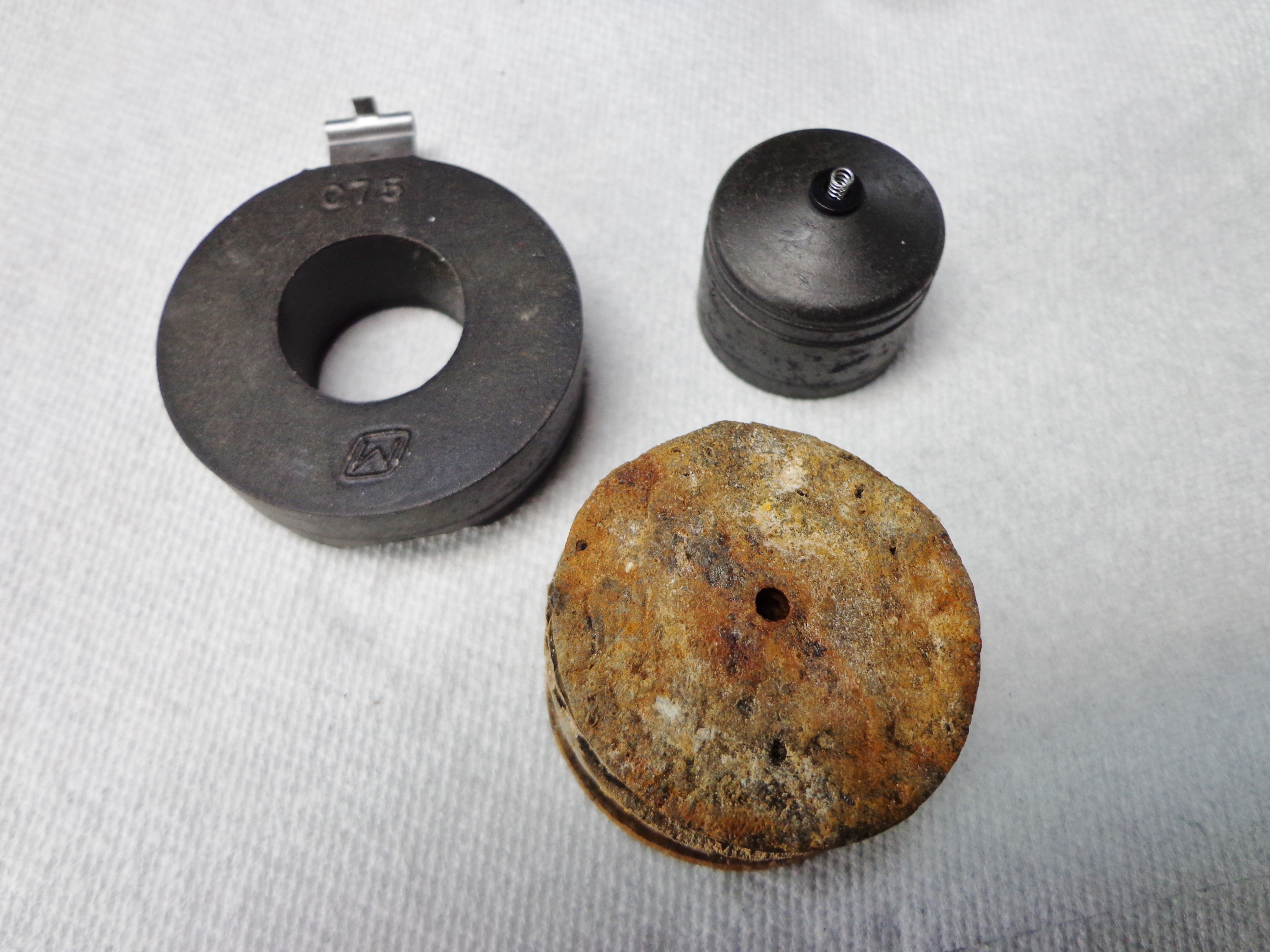

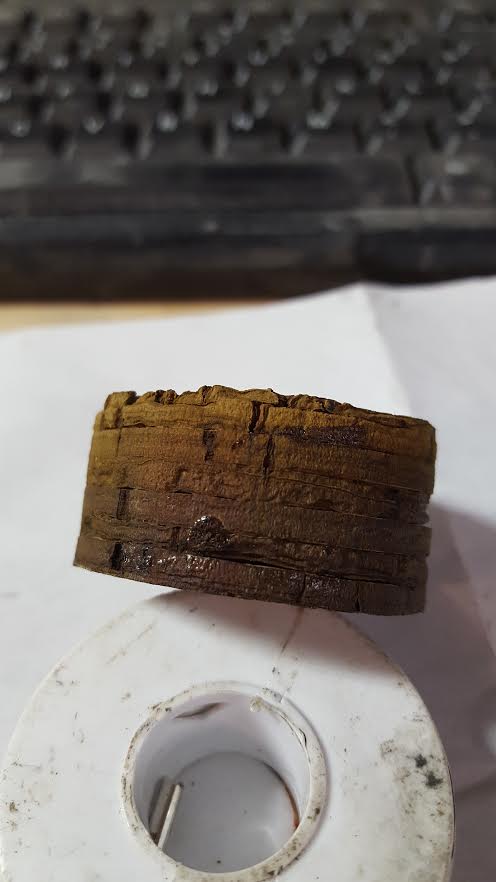

      Next he says we gotta go thru the carb and he says something like..Engineers suck….Oh wait, my bad that was me after seeing the contraption they call a carb.. REALLY a pressurized fuel system??? ooook, so we get deep into this toy and everything looks really good just dirty on the outside, but I did find this :
      This is the float, looks pretty bad to me, so what options do I have for making it work or replacing it with something better?

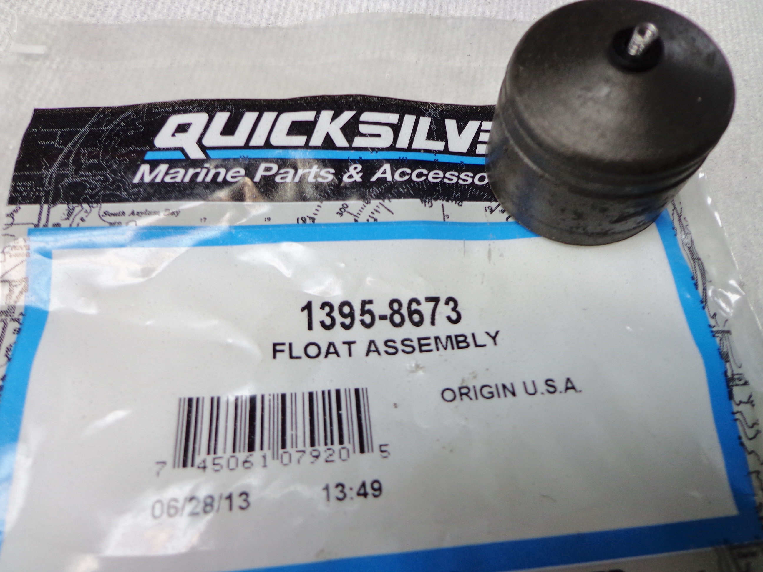

        Many are using the new modern closed core foam float used in the newer engines. . . 😉

          I use the sierra float, sand down the dome end on a belt sander and away you go.

            Umm they are not the same size…. I do not think…care to measure one as I do not have a Johnson carb available to look at
                Richard, despite the size of the new foam float, it’s boyancy is superior to that of the cork float. I have used it in a 1937 johnson 110, a 1953 johnson tn28, and a 1951 Neptune A1. It’s the boyancy that keeps the float needle up to seal off the flow of fuel in the carb body when the chamber has enough fuel.
                I also plan to use it in a 1937 Johnson KA37 and a 1947 Johnson KD15.

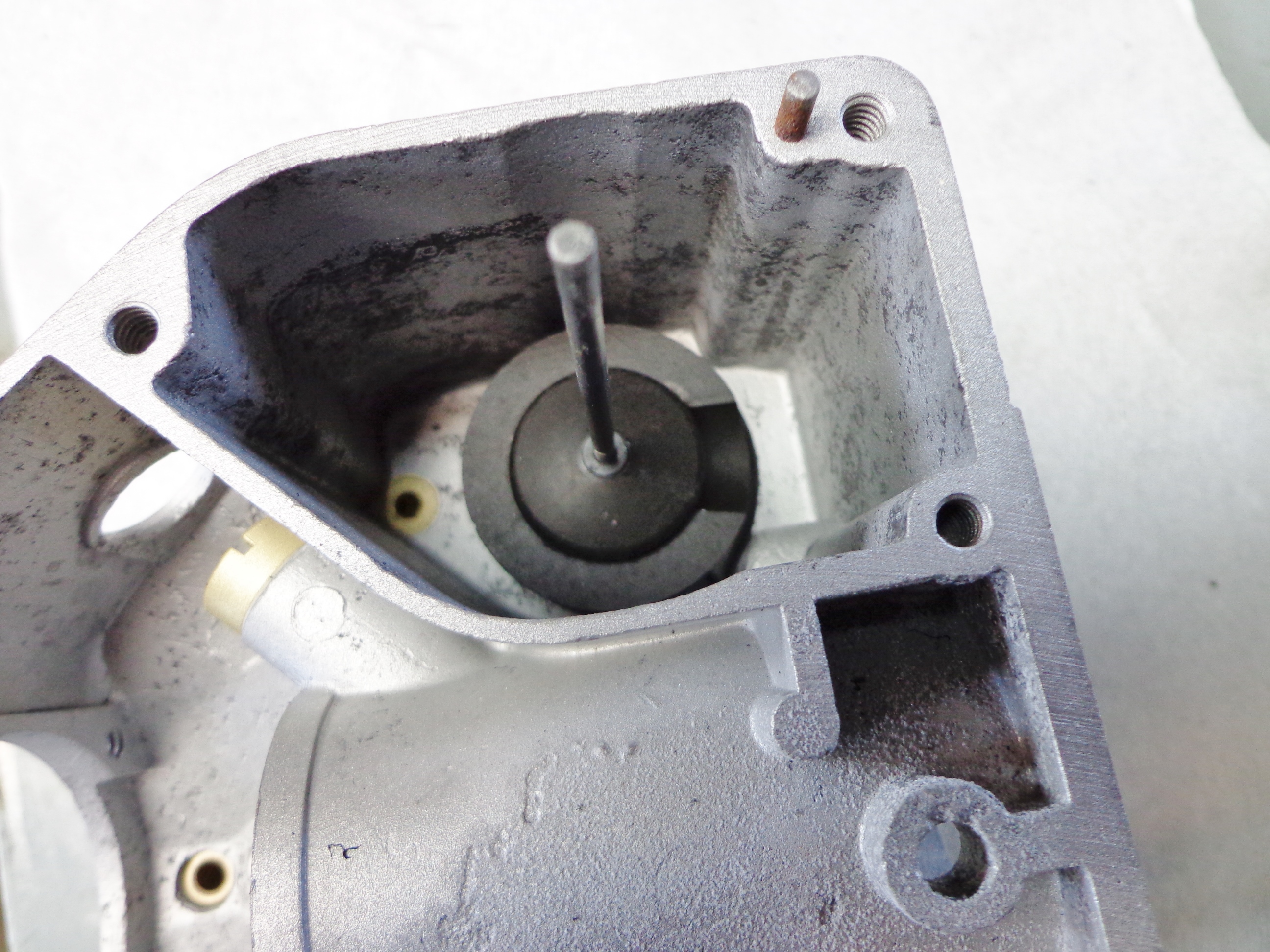

                  Don’t forget their use in junction with a larger OMC float for the Vacturi carbs used on PO’s.
                  The Merc floats are so handy I always keep at least one new one on hand now!
