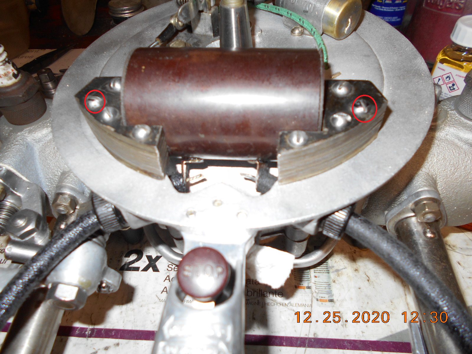

I posted a picture on this post of an A-35 Motor I originally bought for parts. Pulled the flywheel
last night and the coil tested positive!
Running into a snag with the plugs wires that are held secure by the bakelite screw in collars & bushings.
The bakelite collars backed out easily but the bushing have a firm grip on the plug wires that prevent me pulling the wires out, plug wires will push forward but not pull back.
At this point it appears I may have to remove the coil, cut the plugs wire off short and push what remains forward threw the bushing.
Tubs, as I recall you’re familiar with this scenario, any and all feedback appreciated.
T.. in Wisconsin

This picture is from an A-25. You probably missed
the springs and glass tubes. You have to be very
careful as they are easily lost it the clutter. You
likely never know they were there if weren’t told
to look for them.
Try some petroleum solvent like carb cleaner, kerosene,
engine de greaser, exct. to dissolve the tar and free
things up. Heat gun will also help.

April 8, 2024 at 4:29 pm #286579Sure, removing the coil & cleaning up is the way to go.
I was asking more from the thought or question is the only way to change the wires is to remove the coil. I see no other way without forcing or damaging the sleeve/insulator/bushing.
On another “A” mag I left heels in place and just removed the coil so realigning was not a problem.
From what I’ve seen on the early “A’s ” Johnson used a variety of schemes at the coil/plug wire interface, interesting stuff. Makes me wonder if Finn was behind all this !!
T.. in Wisconsin.
April 8, 2024 at 10:15 pm #286593Question answered.
With sufficient lubrication to loosen the plug wire from the bushing the plugs wires can be pulled “out” without having to remove the coil.
I did however remove the coil and push the plug wires forward. I did find bushings at the end of both plugs wires making for a snug fit.
Coil tested live again with readings across both primary & secondary windings.
My memory is not so good at times. To remove the coil I did have to remove the heels as well.
T..
