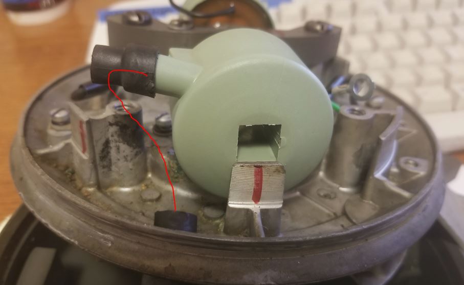

          I guess you guys have tried running it this way? It looks like it should work if the spark plug wire can be bent sharply enough to not be so high as to rub on the flywheel…..
          #68660
          outboard315
            quote Seakaye12:
            I feel like the way it was routed in the first picture was easier. I was thinking straight down and drill a new hole for the wire, but that still seems harder.
