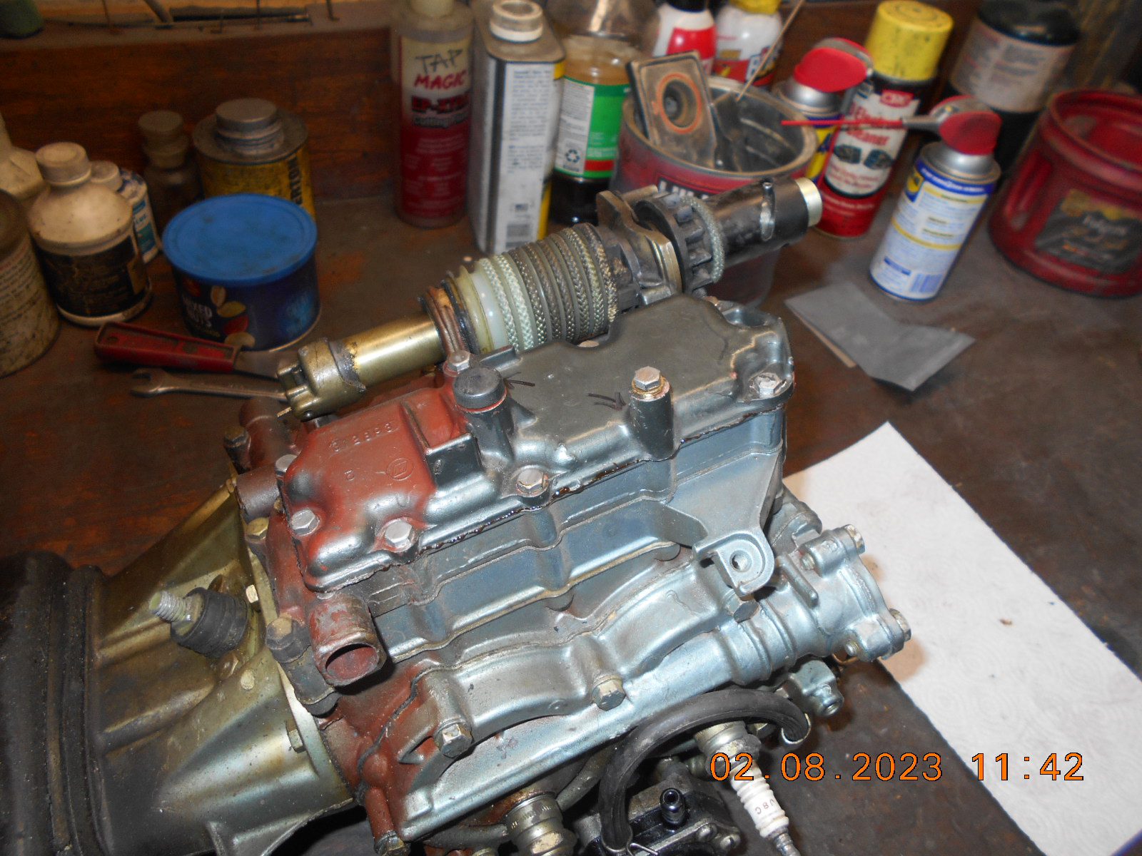

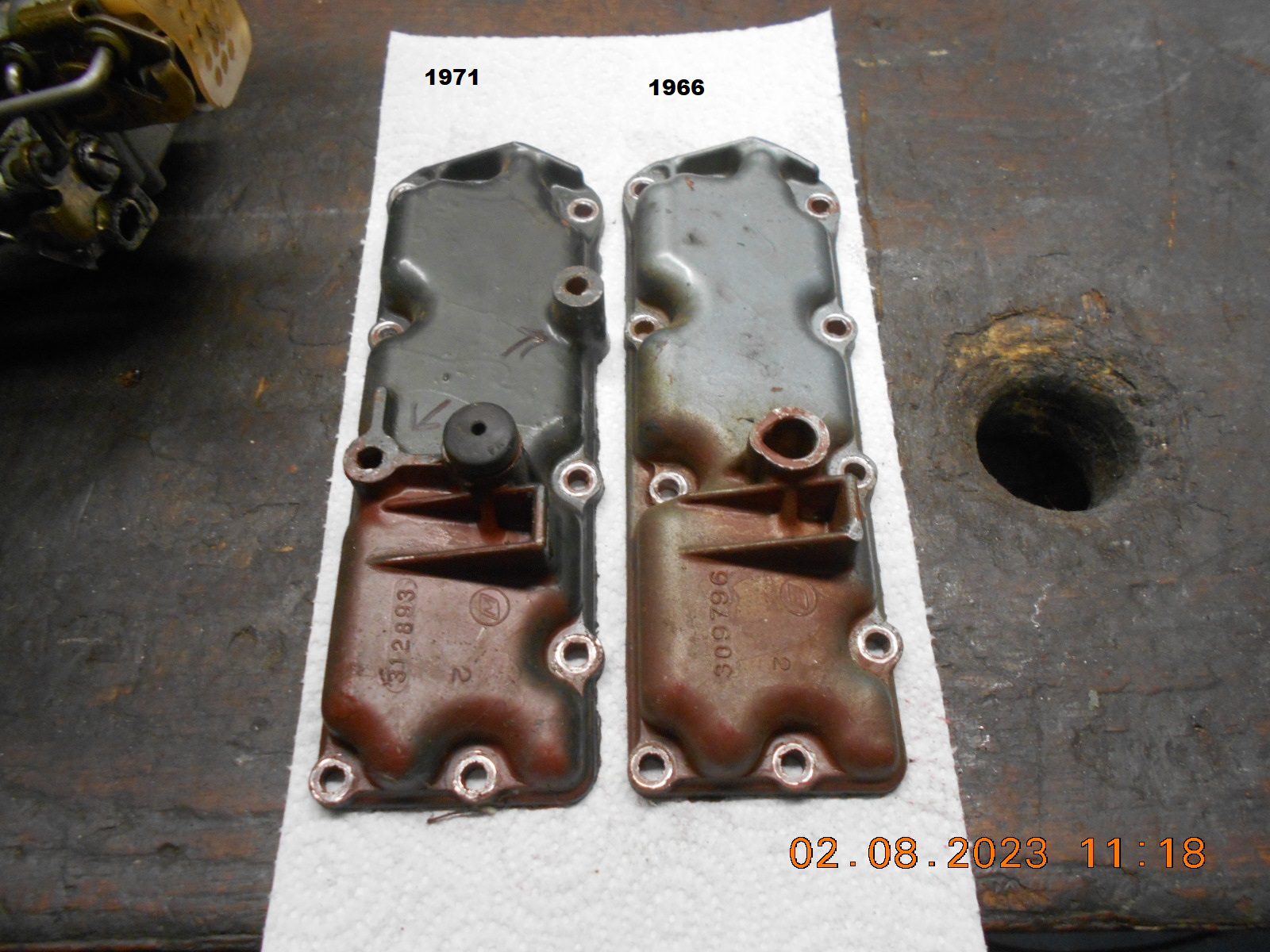

      I decided to see if I can upgrade the 66 Evinrude’s powerhead
      suspension system with the 71 Johnson parts motor clamshells
      and the exhaust water cooled cover, so I can use the
      two vibration dampers from the 71 model.
      There appeared to be some differences with the throttle linkages
      under the hood, and the Johnson front panel was one piece, the Evinrude two.
      Hopefully I can make it all work out.
      So far, I’ve only switched around the water cooled exhaust cover.
      Tomorrow, I may see if the port clamshell crack is repairable.
      DSCN6083
      DSCN6087

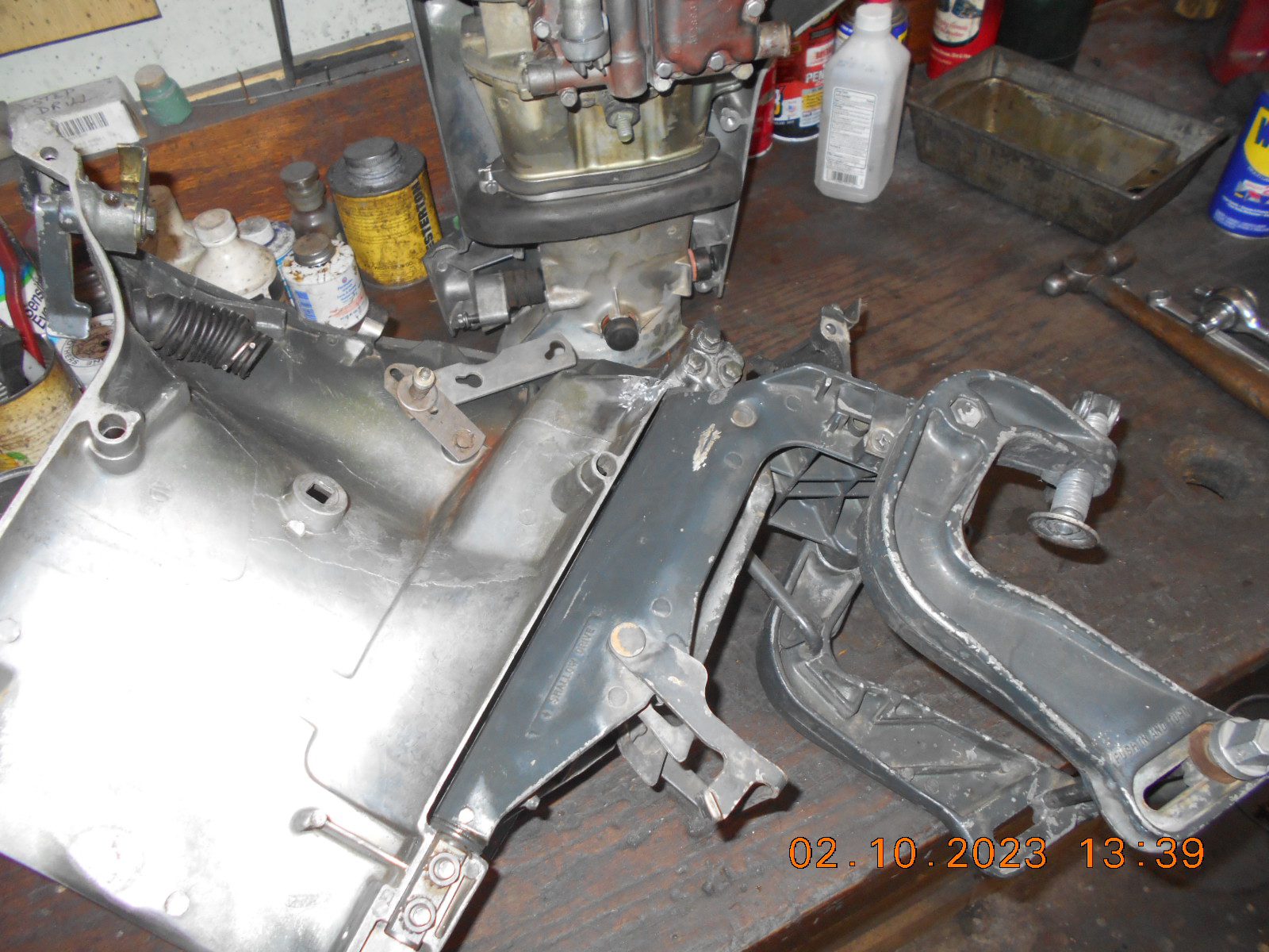

              I cleaned the 71 clamshells with the vibration dampers, and the 71 transom mount,
              and hope to “try” to start putting it all back together on the 66 powerhead, in a couple of days.
              I alumi-welded up the crack in the one clamshell, on the inside of the shell,
              and put some JB weld on the outside of the crack. Not pretty, but doubt if
              it’s going to show anyway.
              DSCN6097

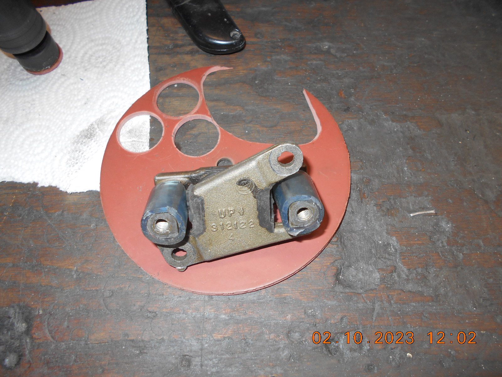

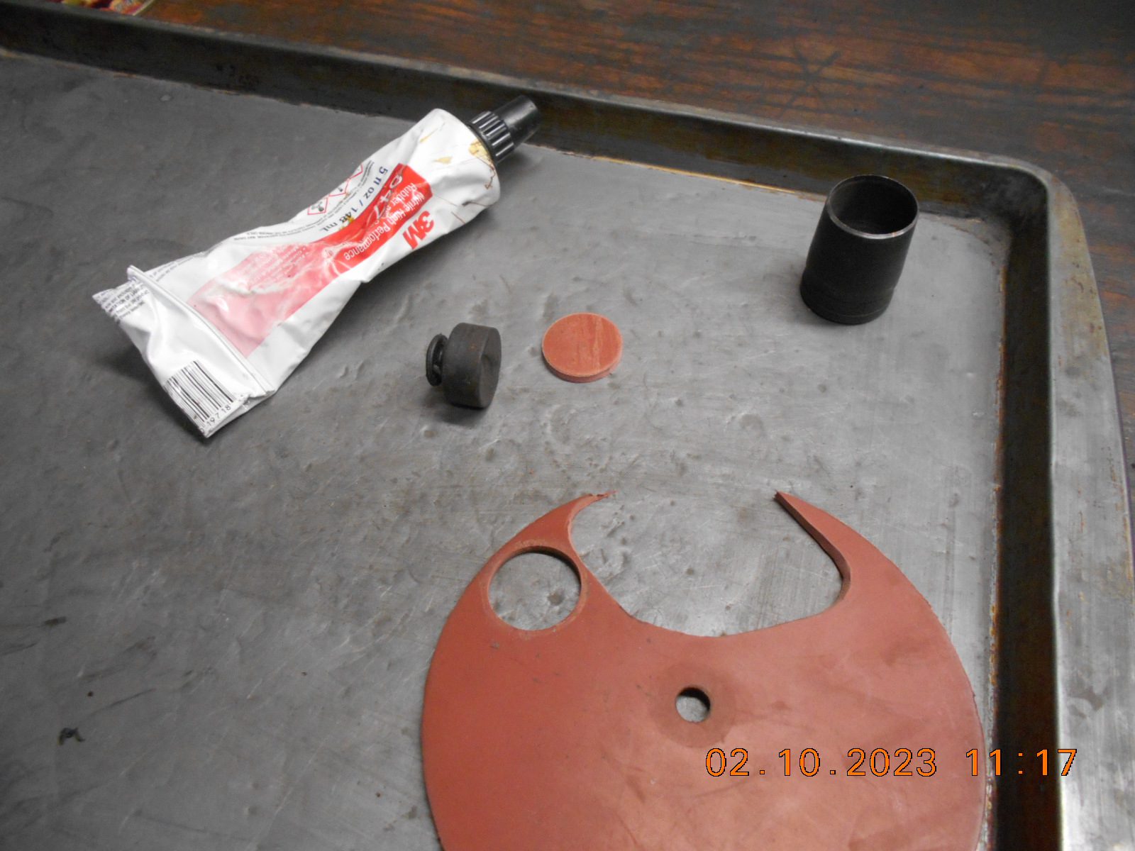

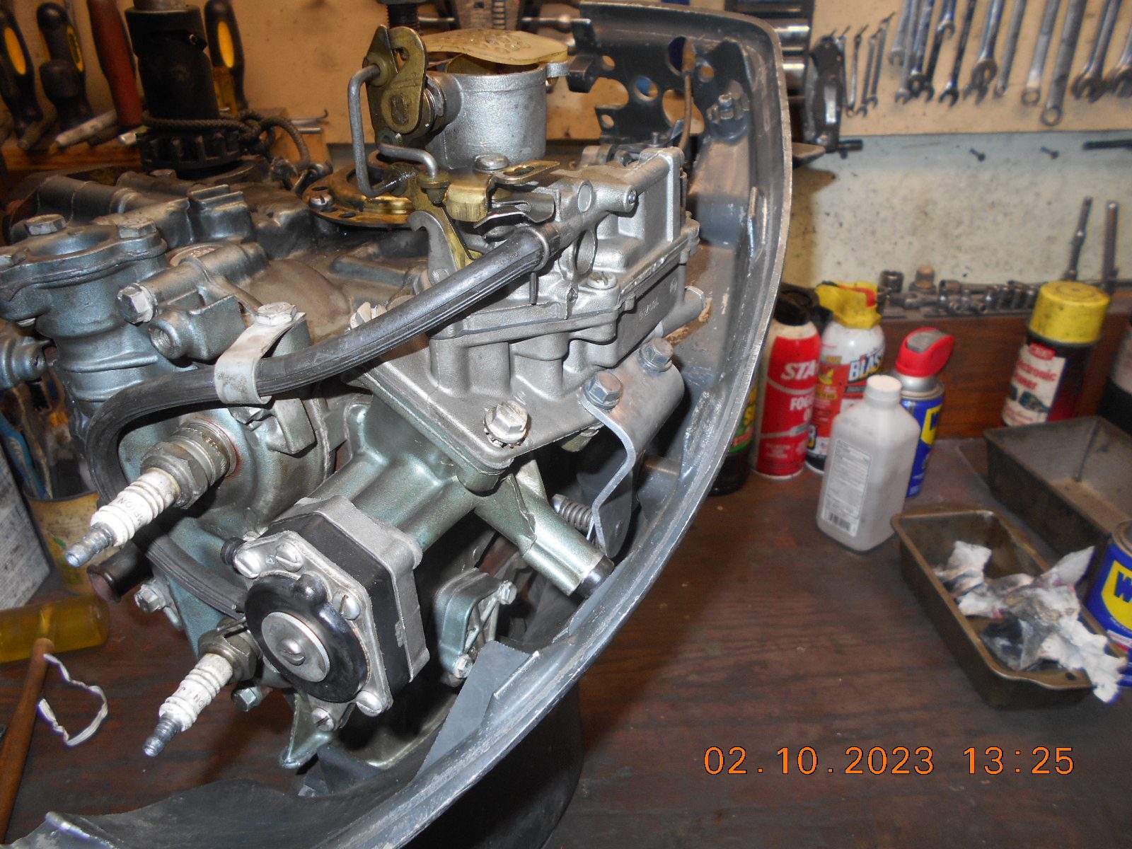

                  Did a bunch of cleaning this morning, then
                  I started putting the clam back in the clamshells today.
                  I cut three 1/8″ thick rubber gasket circles to glue to
                  the bottom side rubber mounts, and the bottom rear,
                  to help tighten things up.
                  The newer style clam shells with the vibration damper
                  on each side seemed to really “snug” things up too.
                  I wished I had a video from years ago when I got the motor,
                  and tested it in the barrel, to show how bad the clam was
                  shaking in it’s shell…. hopefully this time around will be better!
                  DSCN6100
                  DSCN6102
                  DSCN6104
                  DSCN6105
