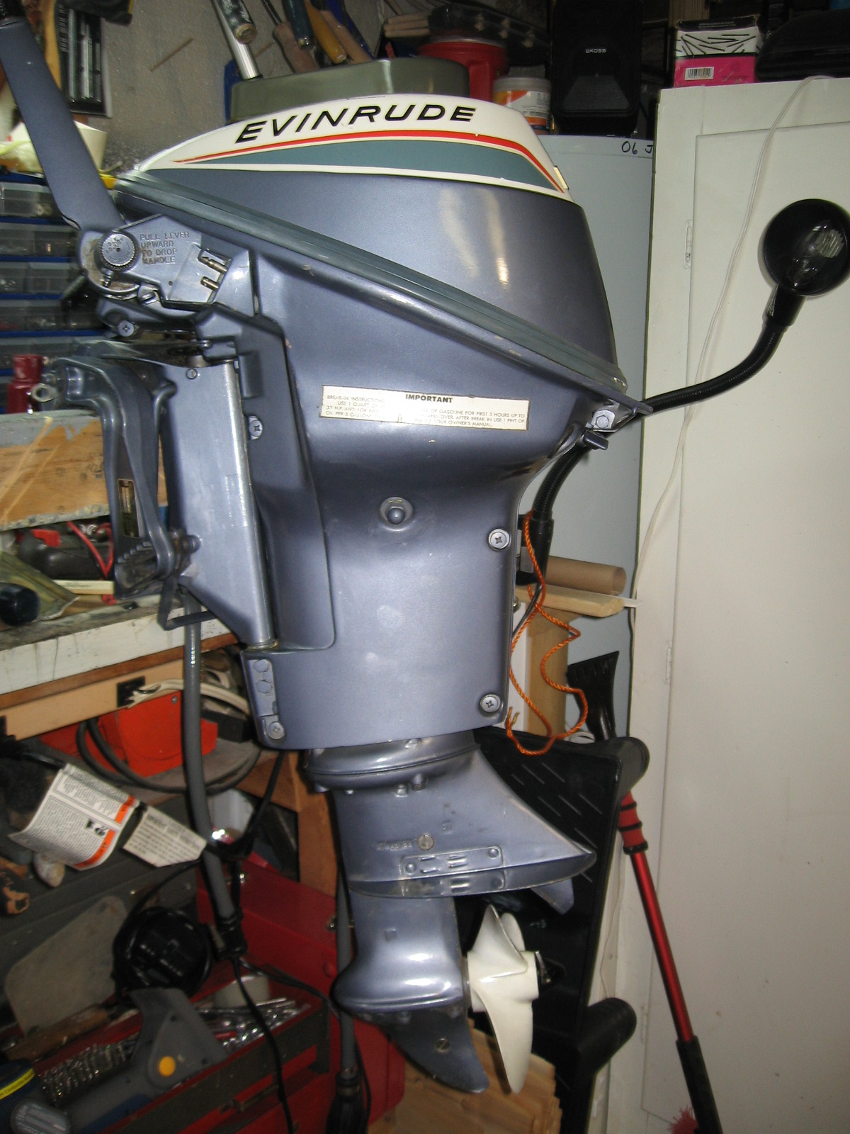

                      #47901
                        you guys have me worried ….are Evinrude mdl 9623a in that batch of …waiting to crap out mounts ???
                        download/file.php?mode=view&id=5909
