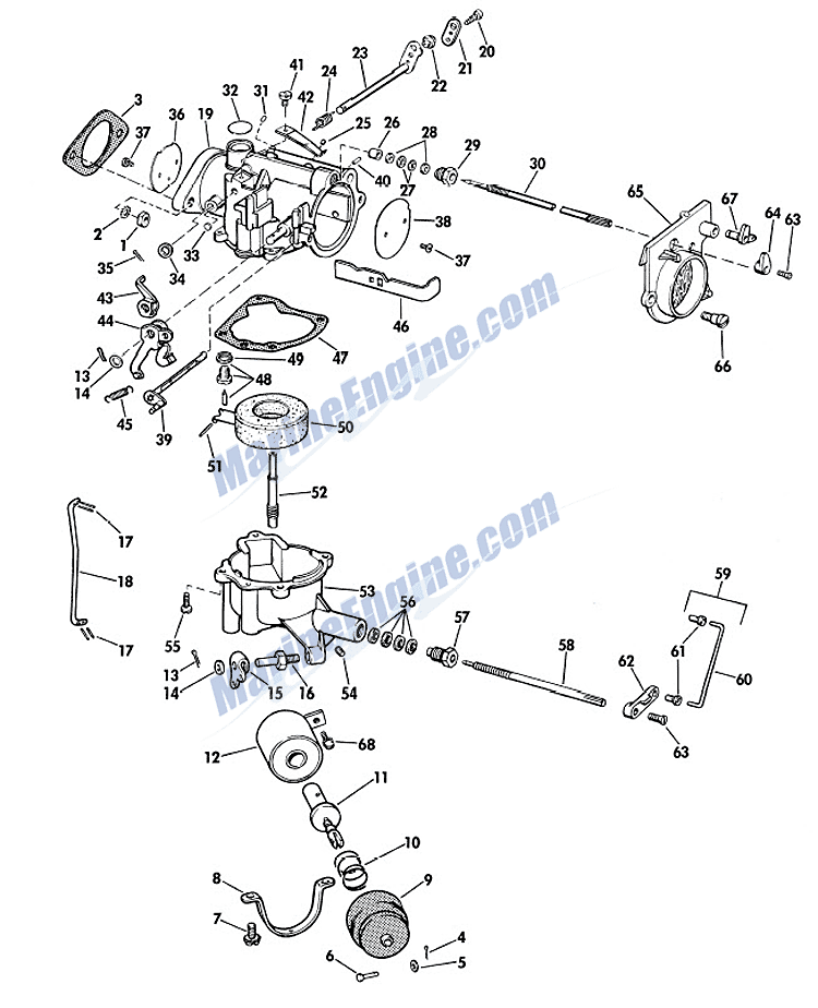

              its what I am wondering, clutch dog will be easy to diagnose and fix once I am out of the water, the other I wondered if it was also too lean, this engine is quite tight so I know its not leaning out around the crank shaft. id really like a prop wheel so I can try to diagnose this at home. I have also wondered if I am out of adjustment on the shifter, I am going to go look into that now. I would absolutely describe the high end issue as feeling like I ran over something and here in Squam lake, thats always a possibility. when god got done making lakes he put the extra boulders here, so it is especially alarming
              I don’t know what you are referring to in regards to carburetor. Lean sneezing can happen in Forward gear, neutral and Reverse. A lean sneeze will become more pronounced(more prominent skip or hard jerk feeling) at higher speeds. Your carburetor has a low speed/idle needle number #30 and I high speed needle #58 in the diagram provided.
              You never stated if you adjusted carburetor while you were in the water and on the boat. You dial in your high speed needle first then you make adjustment to the low speed/idle needle second.
              Before you tear into the ignition, get a set of inline neon spark detectors and look for intermittent spark loss while the engine is running.
              Like the others have stated, your motor should not be jumping in and out of gear in neutral.
              Make sure these are your beginning carburetor settings:
              (Carburetor Adjustments for High speed and low speed/idle needles)
              Initial settings are: Bottom high speed = seat gently (turn needle clockwise), then open 1 turn out(counter clockwise). Top slow speed = seat gently(turn needle clockwise), then open 1-1/2 turns out (counter clockwise). Once you have adjusted the idle/slow speed needle and the high speed needles, then snug up/ tighten (packing nuts) part numbers 30 and 58 with 7/16 open in wrench enough to feel resistance when you turn the needles, but not too much where it makes it very difficult to turn the needles by hand.

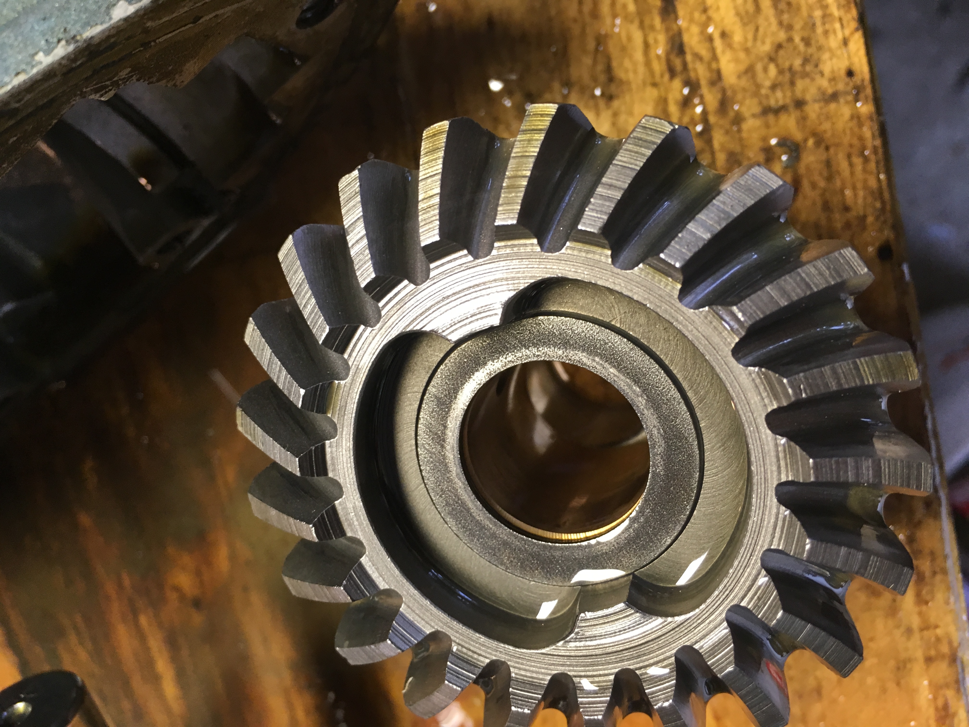

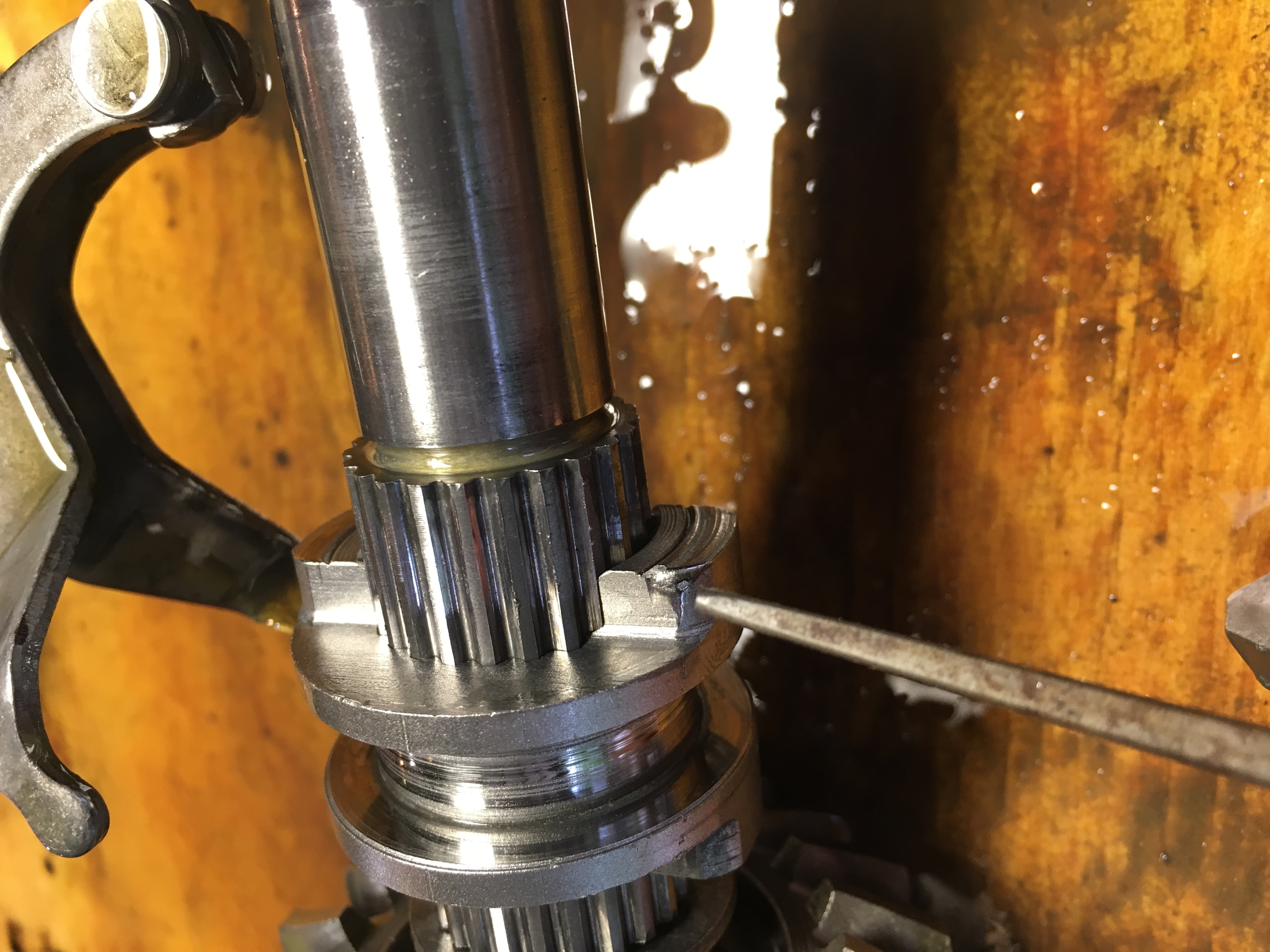

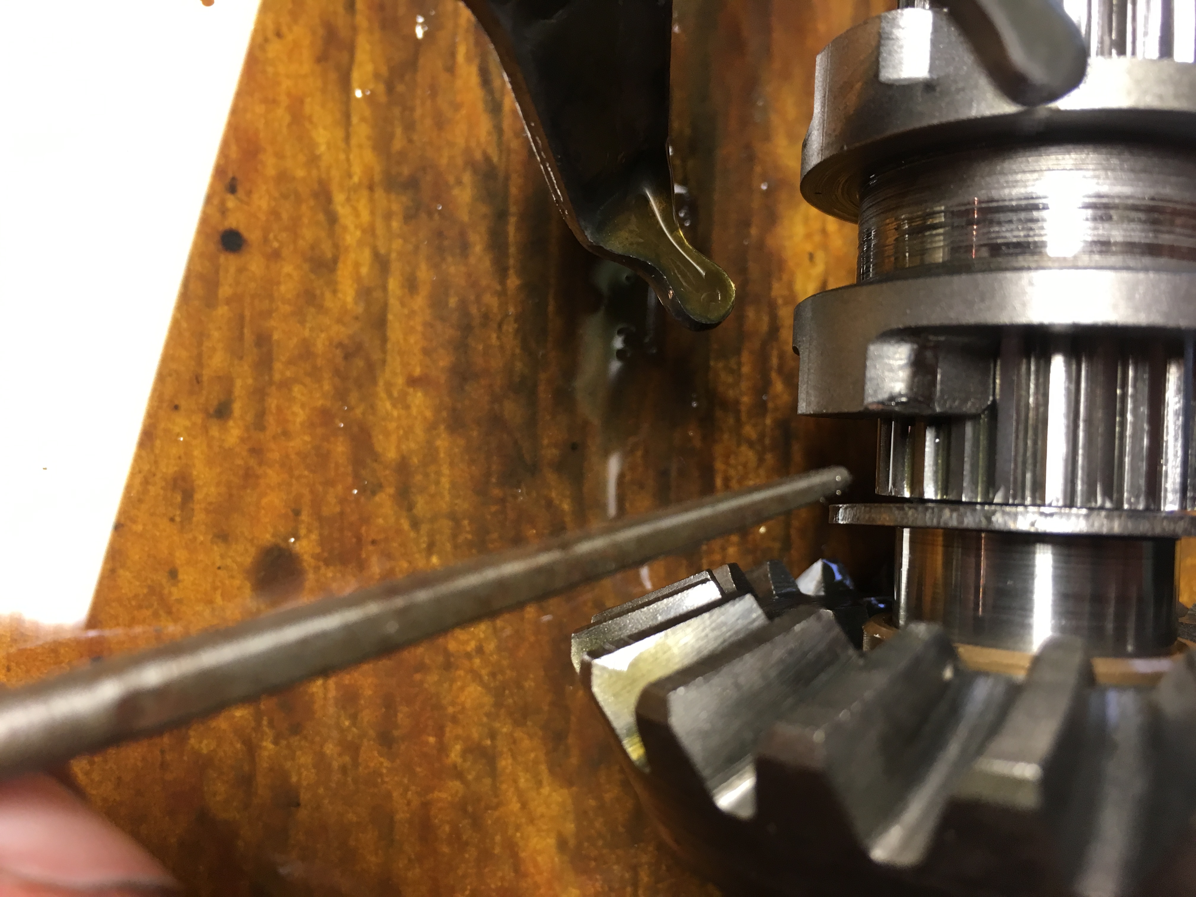

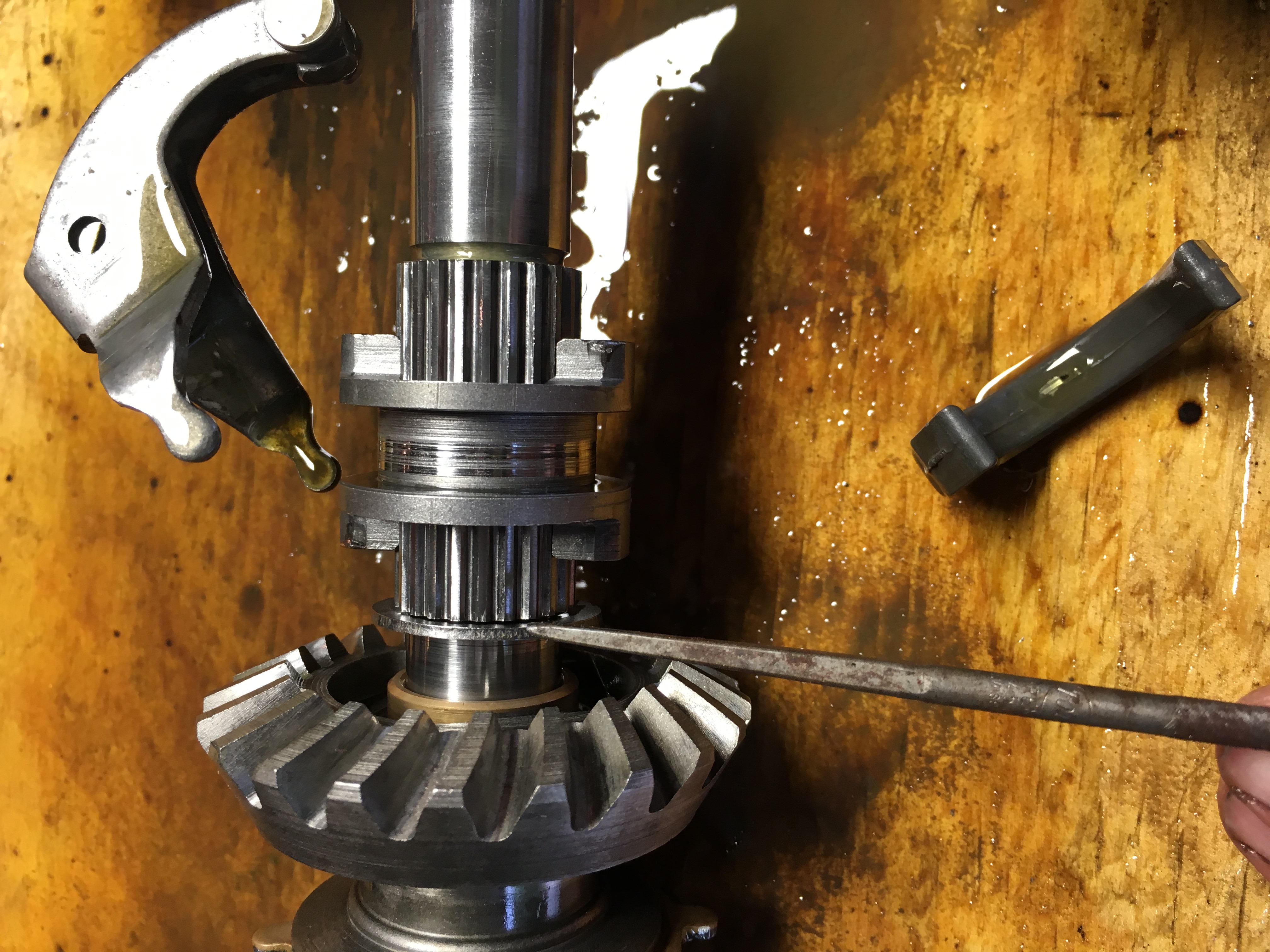

                Cajuncook, thank you for all the adjustments procedures, I’ll save those for future reference as well. I have reason to feel the carburetor needs further attention however I am awaiting a kit.
                Meanwhile here are the pictures from my lower unit gearbox I believe there is a thrust washer missing, and I also believe that I have sufficient clutch dog wear to warrant replacement. Please give me your thoughts.
                #83282
                  That clutch dog is toast.
                  #83283
                  vtfireman85
                    Also I just found the other washer, it was stuck to the gear.
                    #83298
                      Yep, clutch dog is history….Would need more pictures of the gear lugs to make a decision on it…
                      #83310
                      vtfireman85
                        That’s all I’ve got, they didn’t look as bad but I did wonder if they were interchangeable, could they be turned around so they engage the opposite side? Same with the clutch dog? I don’t mind buying new parts but if I can just turn it around…
