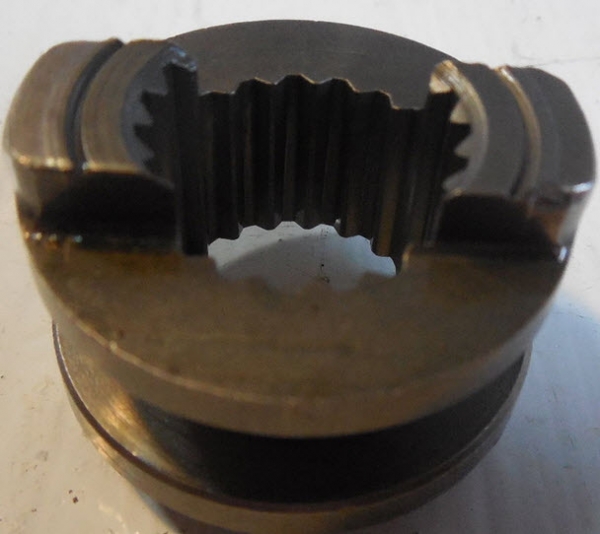

                      The clutch dog is located in the lower unit gearcase. It’s the shifting device that moves back or forward along the prop shaft to engage the forward or reverse drive gear. The clutch dog has "ears’ on it that engages the drive gears and over time, the ears can be worn down to the point the gears slip and grab when under load. See picture enclosed – yours may not look exactly like this one but you can see the ears.
