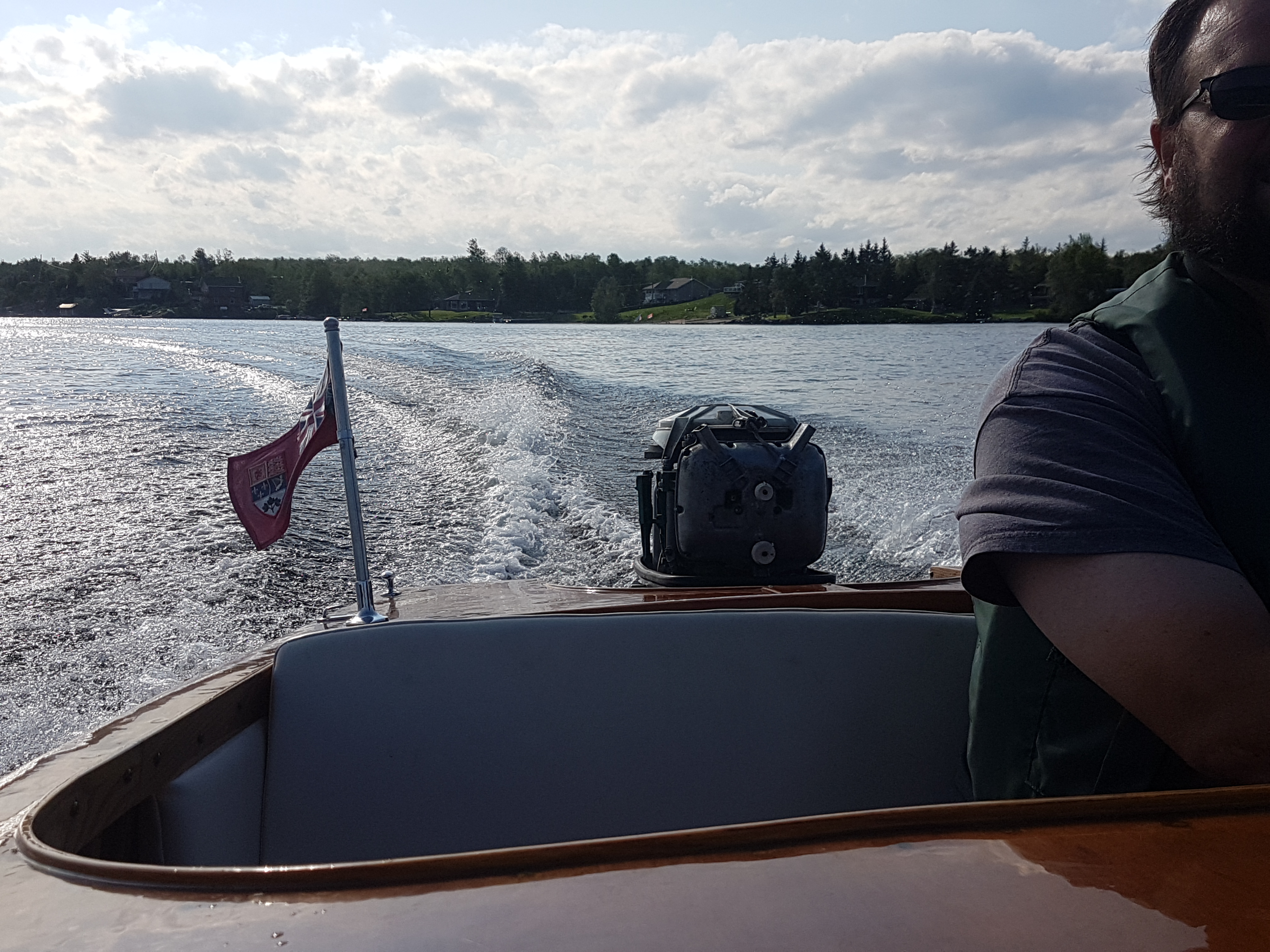

              Richard L. Paquette
                Success!
