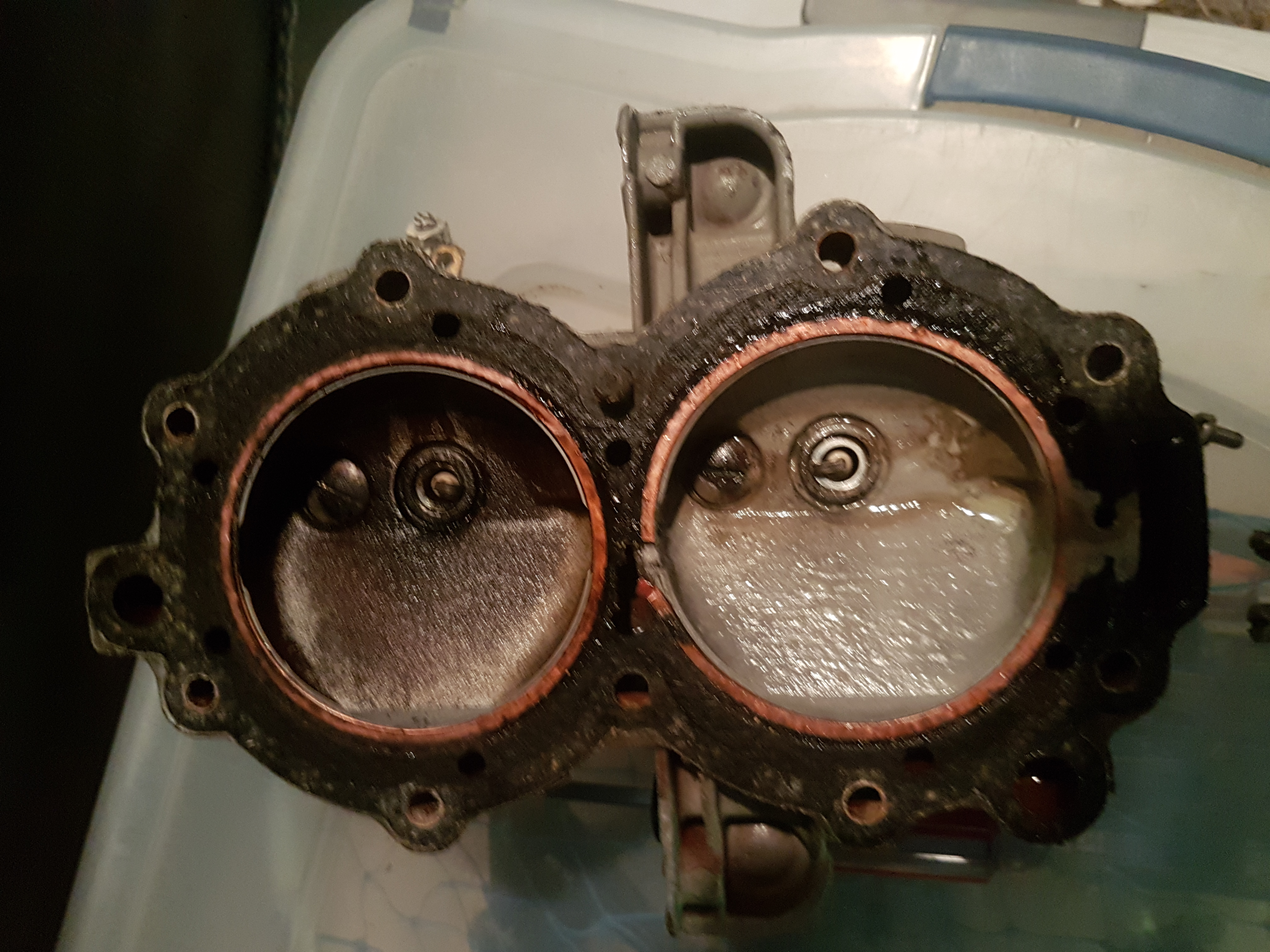

                      Reading the Seloc manual I note they seems to think compression tests are of paramount importance in diagnosing whatever. Well…, I borrowed one after going through the mag and swapping the carb again to only get the same, though worse results. Top was only 70 and lower didn’t register will just a pull start, Had to use the starter and it didn’t even get to to get to 30.
                      Lesson learned and a compression tested added to the Christmas list.
                      Will check the head gasket first…
