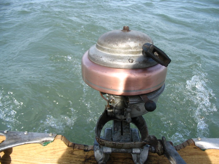

        PM T2
          check the tank, you may have a copper-top motor there. Evinrude built some of these with a heavy-walled copper tank that is virtually bullet-proof. if you have zero dings in a 70 year old tank, I’d say either that motor has been very lucky, or the tank is copper and not pressed aluminum.
          Chips in the paint without corresponding dents or dings might be one clue.
          Hope this helps.

          shoestringmariner
            Thanks guys. I had a closer look and there are 2 few very slight dings in the tank. I did not try to expose any material beneath the paint but it looks like some white oxidation in a few places indicating aluminum corrosion, so very doubtful it is copper. I may just clean it up the best I can without damaging the decals and leave it. Looks like I can get decals for it.
            I guess the tank must be from a "41 then. Could be a parts motor for all I know

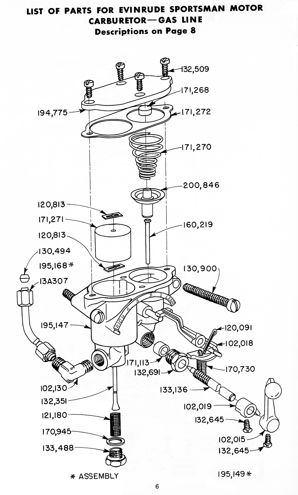

                    Hey Garry, does this one have the delicate filter meshes in it? I know my 1949 sportster does. They should be removed BEFORE you put and "hardware" into the tank!! These are fine metal mesh filters in the gas line. One might be right inside where the gas line leaves the tank. Very delicate. And easily cleaned if you know where to look. Mine was very dirty. The other one on my Evinrude Sportster is at the bottom of the carb bowl. Hope this helps.
                    #49402
                      There is no filter in the tank. There IS a 1000 mesh filter 121180 in the bottom of the carburetor. It will stop water when coated with the oil in the fuel. . . 😉
