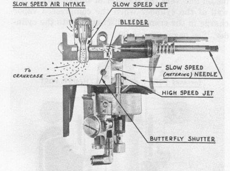

      That thing on top is a 375628 Venturi Assy – Slow Speed. Now that I said that, I gotta admit I don’t remember how it works. 60 years since last seeing one can do that to a fella. Now to dig into an old service manual to be re-educated.
      #187146
        Here ya go—-

            Thanks for all the responses. It seems simple enough. Just going to take my time cleaning it and reassembling. Does any one ever mess with that brass seal? Or just leave it be?
            #187211
            David Bartlett
              I wouldn’t touch that seal until it is known to be giving you trouble.
