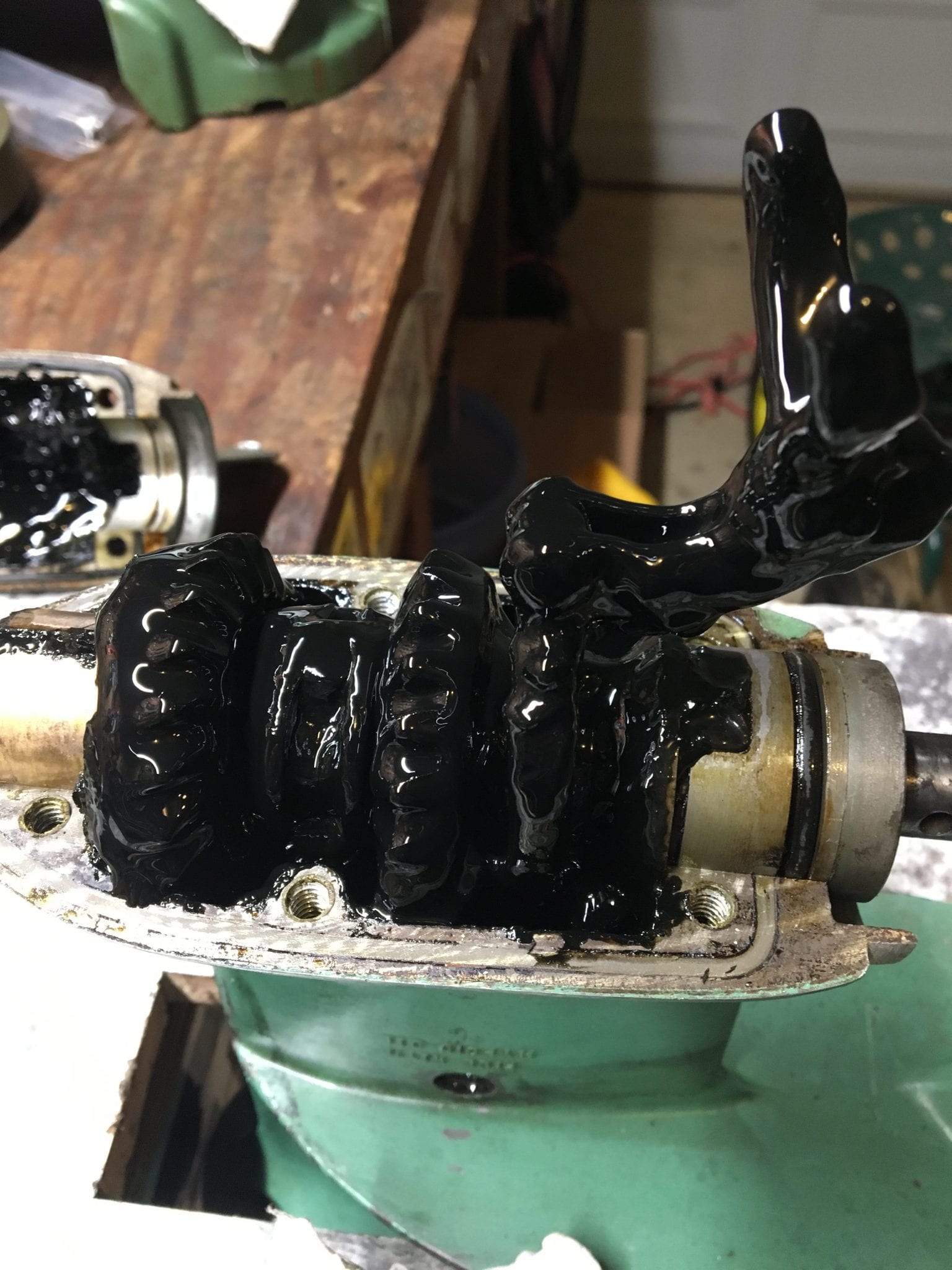

            Boy, this was a mess! Took a bit to clean everything up but came out clean and looking great. Gotta love black sludge (old grease I’m sure!) Gearset was definitely protected!!!

            #190228
            labrador-guy
              Wow I bet it smelled good too! Did you notice those bolt holes are on the inside of the spaghetti seal? Remember to put some sealer on the treads and the heads of the bolts.

              #190232
              Tinman
                It smelled wonderful! Lol. Garage still stinks. Hard to get off the hands too! I’m very generous with the 847. Should be sealed up tight. Thanks for the tip about the float. Worked out well.
                #190233
                  Man, that’s pretty gnarly! And it didn’t stink, it must have staaaank! But you’re right about the internals being protected – nothing could get through that mess.
