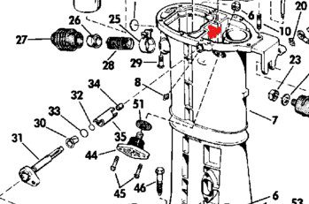

        OK, here is what I’ve decided.  The crankcase puddle drains drain into the area marked in the picture below.  That also is the place the shift shaft passes thru.  Also, note that the shift shaft on this later model has #32 & #33 O-rings on it.  Those O-rings are not shown on the 1959 screenshot that I posted earlier.  Methinks the O-rings were added for just that reason—puddle drainage blowing out through the shift shaft bore.
        Bottom line is puddle drainage is normal and intentional.  And it is not harmful because it is normally headed for discharge out the underwater exhaust anyway.  Maybe a tad messy for your tastes but not much to do about it without major efforts.

            Oh and Crosbyman, where might the purge valve cover be located. Might take a look at that. Thanks
            #267863
              see parts 68 …to      76  on the diagram above
