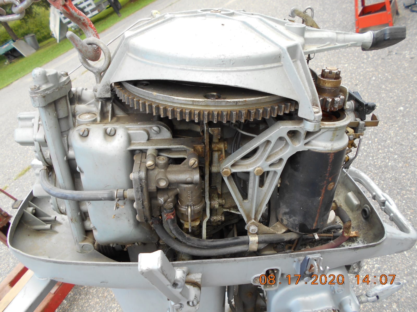

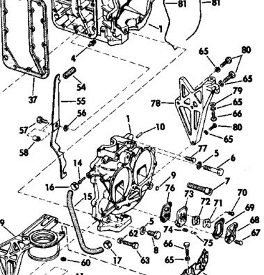

October 4, 2022 at 4:20 pm #267079So you are speaking of zerk fitting #4 in first picture? Is it actually coming OUT of the zerk or just somewhere nearby/above? The crankcase puddle drains #68-thru #76 drain into that general area in the exhaust housing, but I can’t say I’ve ever heard of any complaints of it coming out the zerks.
If that’s what it is, I’d say it’s harmless, but messy.
October 4, 2022 at 8:38 pm #267091Of course, the first thought that comes t mind is the hose #15 on the side of the powerhead. But you said you replaced all hoses. Say you didn’t use a vacuum hose there. That stuff isn’t fuel-proof.

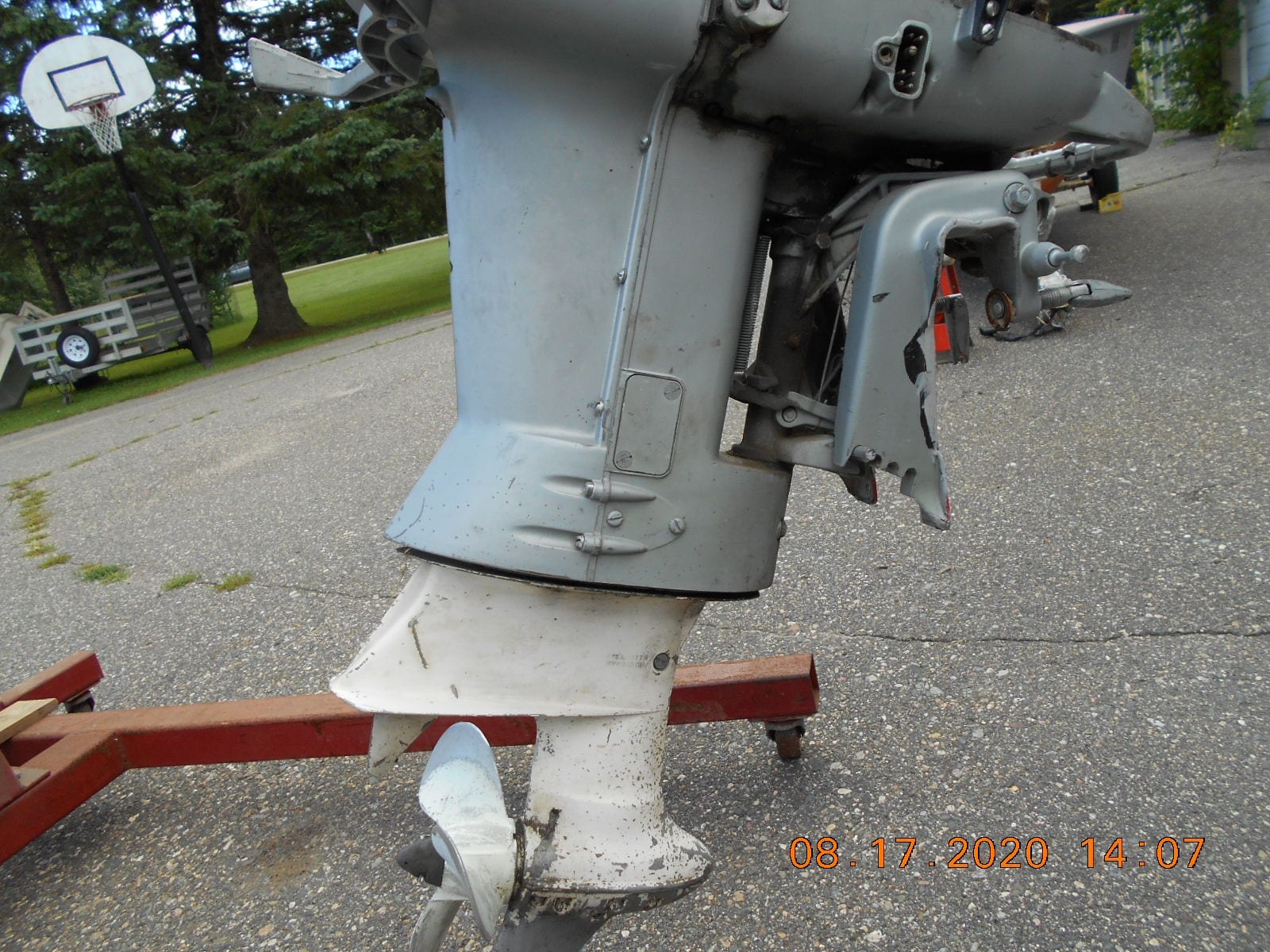

October 5, 2022 at 9:13 pm #267139Ok, here is where it’s dripping from. Hope you can see it. The other pic is what it looks like down on the lower housing. It also has the goo coming out of the exhaust port down by the prop. It smells like gas so I don’t think it’s lower unit lube as I have replaced all the seals when I put in a new impeller
October 5, 2022 at 11:23 pm #267144unburnt fuel ?
October 6, 2022 at 9:28 am #267151That’s what it looks and smells like but I can’t figure out where it’s coming from
