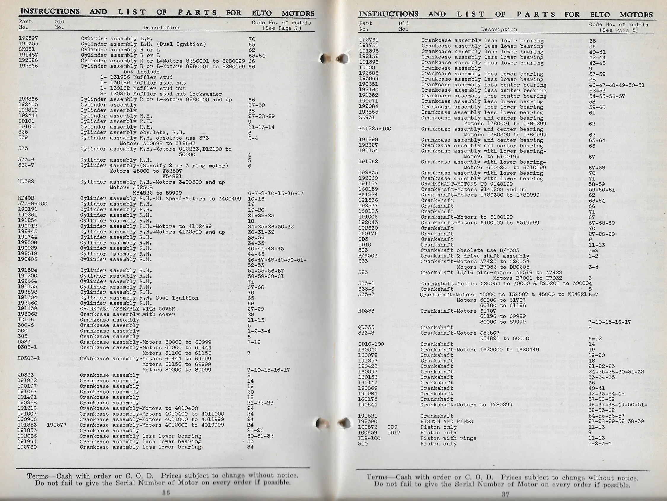

      Normally the Elto’s of that era used step-cut piston rings that were pinned. Crankcases evolved as production proceeded through 1928 but refer to this image here for more thorough info regarding which crankcase was used on which motor.

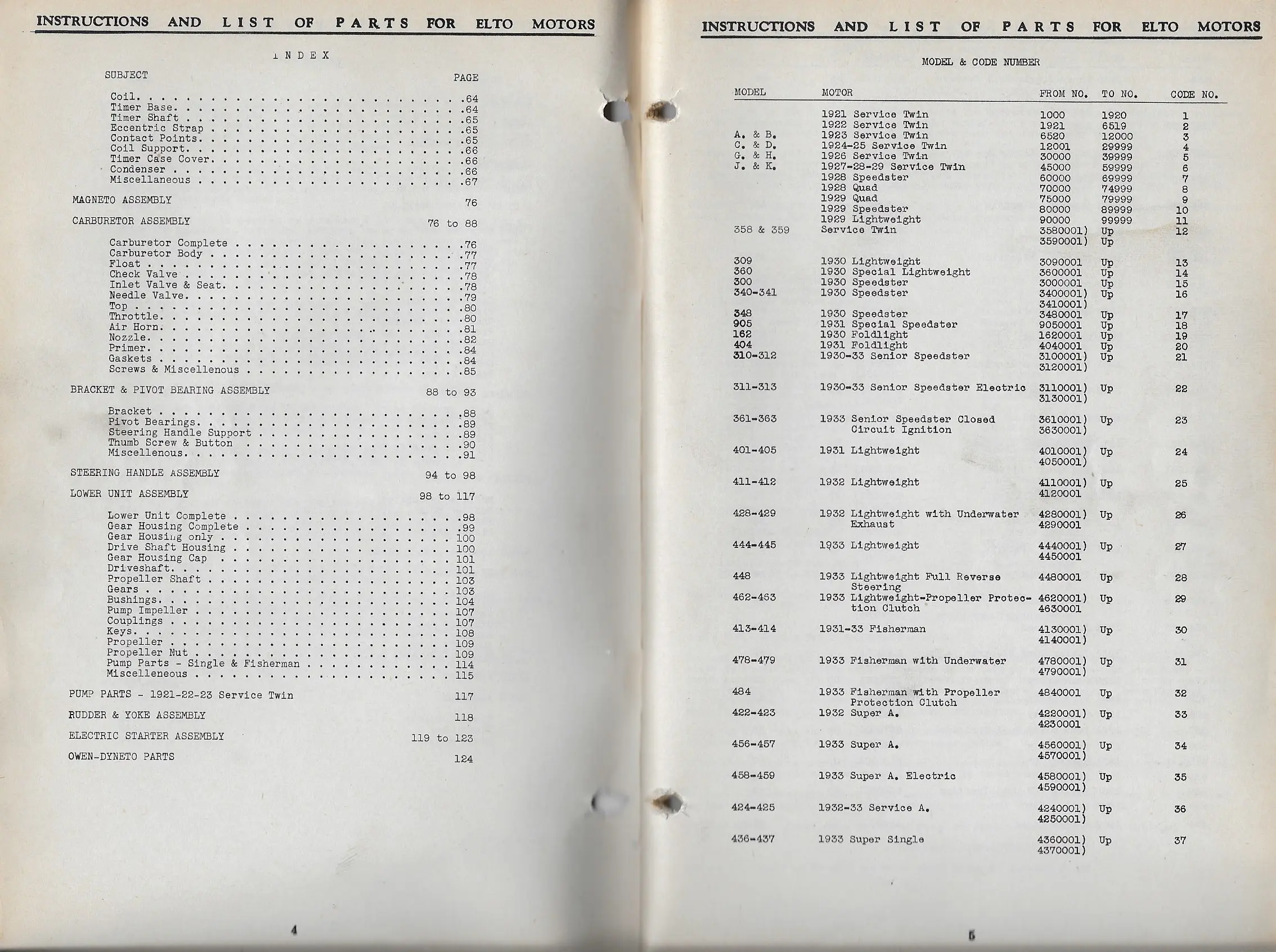

      On page 5 here, you can see the codes assigned to each motor. You’re going to want to pay attention to codes #7 and #10 with regard to whether a given part belongs on your motor or not.

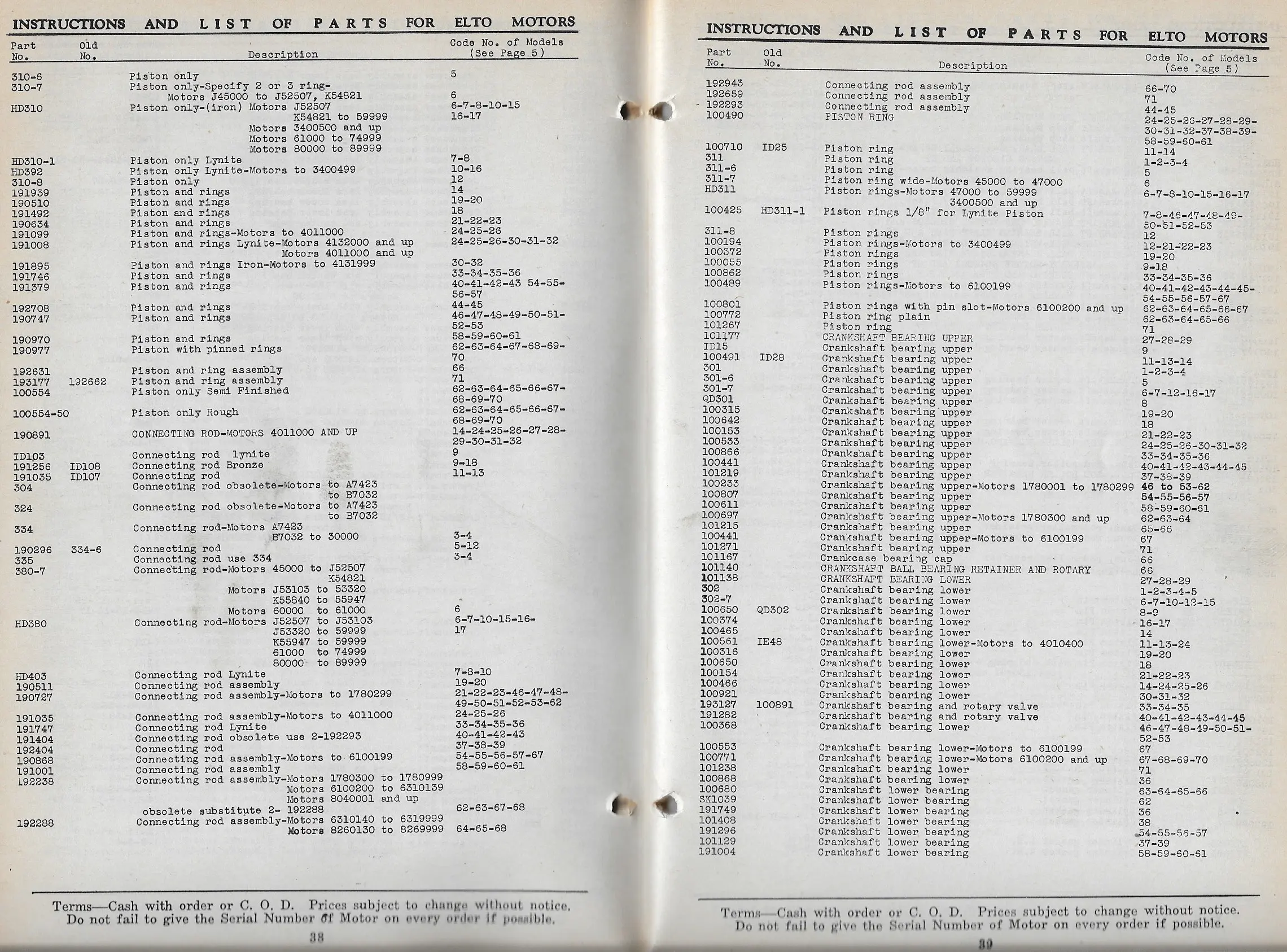

      This one has info on part numbers for other powerhead parts
      MPL-Pages-38-39
      The reason for changes in the oil grooves could be numerous. If the factory changed anything in the production of these motors, they did so because it was an engineering improvement. Ole Evinrude was reputed to be very diligent in insisting that when motor quality issues came up that something be done about it and changes were often made on the fly.
