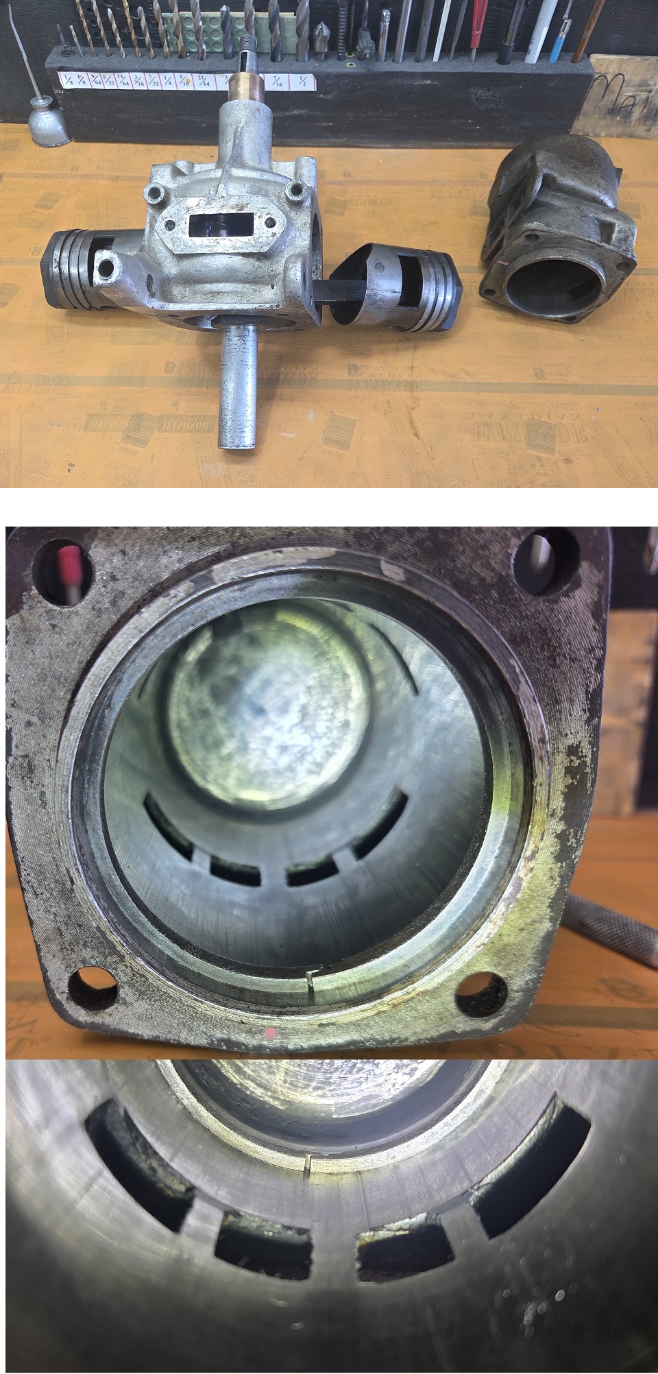

You can have all of this if you can use it. I only have the port cylinder. Took a ring off to check the end gap at the bottom and top for taper. Less than I thought there would be. Its a 28 if that matters.

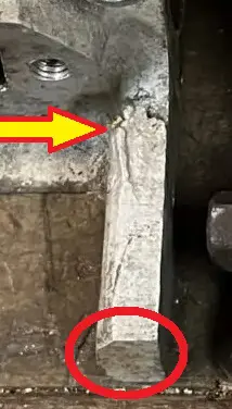

-does it look like the tiller handle bracket mounts on the left crankcase have been altered? It did not have the tiller handle bracket on it when it came to me.April 9, 2026 at 10:43 pm #314810April 9, 2026 at 11:22 pm #314819Ah!! Thank you Tubs!
Is there a trick to removing the tiller handle bracket? The 2 bolts circled in yellow seem happy to stay where they are. Backed off the outside nuts and tapped on them pretty good and nothing. Just a round, flat head on the bolt. Are they designed like a carriage bolt?
