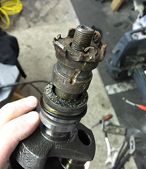

                Before I’d give up and start cutting, I’d keep at it with some heat and penetrating oils while applying short bursts with the impact gun. Maybe try heating the flywheel good and hot, then hit the crankshaft nut/threads with some CRC Freeze Off to create a temperature difference big enough to pop it loose?
                Whatever approach, try not to end up with one that looks like this.
