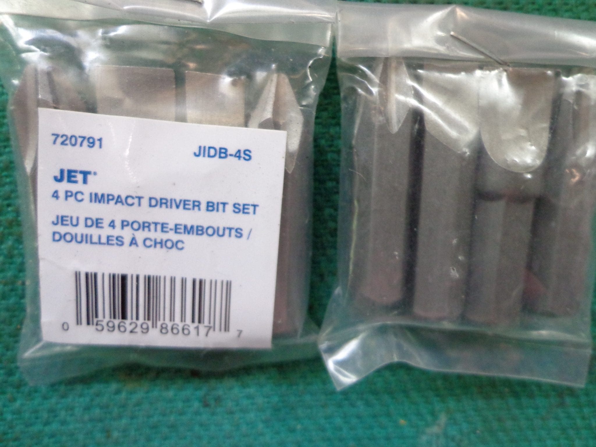

                  I prefer a 3/8″ drive over a 1/2″ drive for use around outboards. Try your local auto supply or tool store for one. One thing I’ve noticed lately is all the new ones are smaller in diameter than the old ones but they are supposed to work OK. Being smaller, I’ll bet I know where they are made.
                  IMGP0340
                  DSC00067
