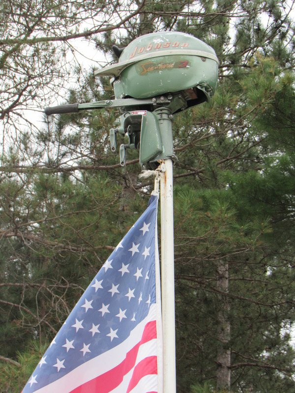

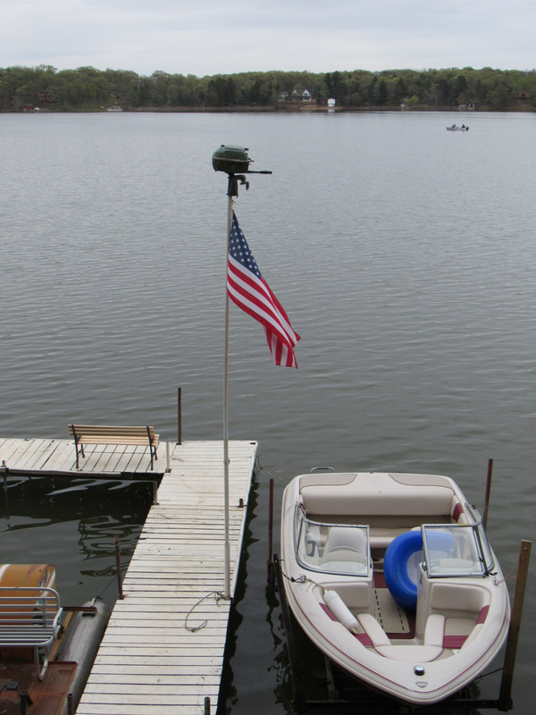

          If one of those 3 HP motors turns out to be junk, here’s what I did with one last summer:
          Not sure why the images didn’t post, but I think you can cut/past or click on the links and see them.
          If you can’t see them, it’s a couple photos of a 1955 3 HP Johnson I mounted on top of my flagpole on my dock.
