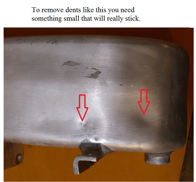

        for some insight into the process, go to the good old YouTube
        and search for Paintless Dent Repair – – – this will give you an idea
        of how to use the hot melt glue and the pulling anchor.
        the larger the glued on foot, the more holding power you will have.

          What you use must be either part of the tank (Welding/aluminum braising) or a very tenacious but slightly flexible glue. I have tried epoxy putty and had it break loose as the metals contour changed . Using the aluminum braising rod with an aluminum nail gave me the best results for a painted tank. The braising rod polishes to a different hue than plane aluminum. . . 😉

            The dent on the video above is easy to fix.
            Much more then on our tanks 🙂
            #50699
              The sheet metal on todays cars is nothing like
              the aluminum tanks of the 20’s 30’s & 40’s.
              Those blue things she is using with a slide
              hammer would break before most dents would
              even move on a aluminum tank if you could get
              them to stick good enough. Now if you could get
              them made from something stronger ?????

                Re the aluminum rod… if you get the dent pulled out, can you cut off the nail and sand off the residue? Does any left over aluminum rod blend in with the tank aluminum color?
                Also, does that "Solder_It" blend in with the aluminum color well enough to use it as filler in small spots. I’ve tried JBWeld but it is too dark.

                  What material that can be used as a filler for aluminum dents or holes matches the aluminum color best?

                      How about the tube of Solder-It in you pic? Will it stick, sand out, polish and look ok?
