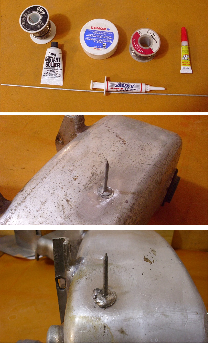

January 9, 2017 at 1:02 am #50693I have spent some time seeing if I could
come with a method to pull dents from
the outside. I like these roofing nails but
haven’t found the answer to getting them
to stick while still able to remove them
easily. I’ve tried super clue, hot glue,
solder of all kinds, that aluminum rod.
None stick good enough to pull a dent
except the aluminum rod. It sticks too
good.A "Boathouse Repair" is one thats done without having tools or the skills to do it properly.
