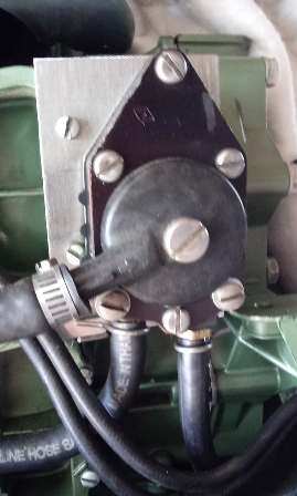

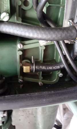

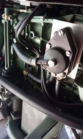

      outboardnut
        186510367_926957584753269_6453388920726952901_n
        188446848_926957308086630_3462460182647567664_n
        189620314_926957141419980_2454432057461428884_n

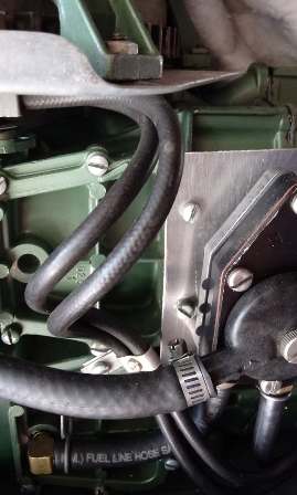

        outboardnut
          192944846_926957488086612_424728962230558146_n
          #239121
            easy as pie 🙂

              Several valid approaches are described in this thread. I think mainly it depends on how original you want it to look. Elsewhere I have seen suggestions to REPLACE a transfer cover with a flat aluminum plate. This I would not do as I can´t believe it wouldn´t mess with the performance of that cylinder.
              The pic of the early covers with a boss look as if they are intended to be drilled and tapped for one eighth pipe thread for a remote pump. Possibly this was an early Gale setup…
              #239146
                Possible impact yes but if the bypass cover empty volume of the unused quadrants are fill up or.. all with a simple 1/4 hole drilled in line with the pump would it matter that much compared to tapping for an nipple and hose back to the pump ??
