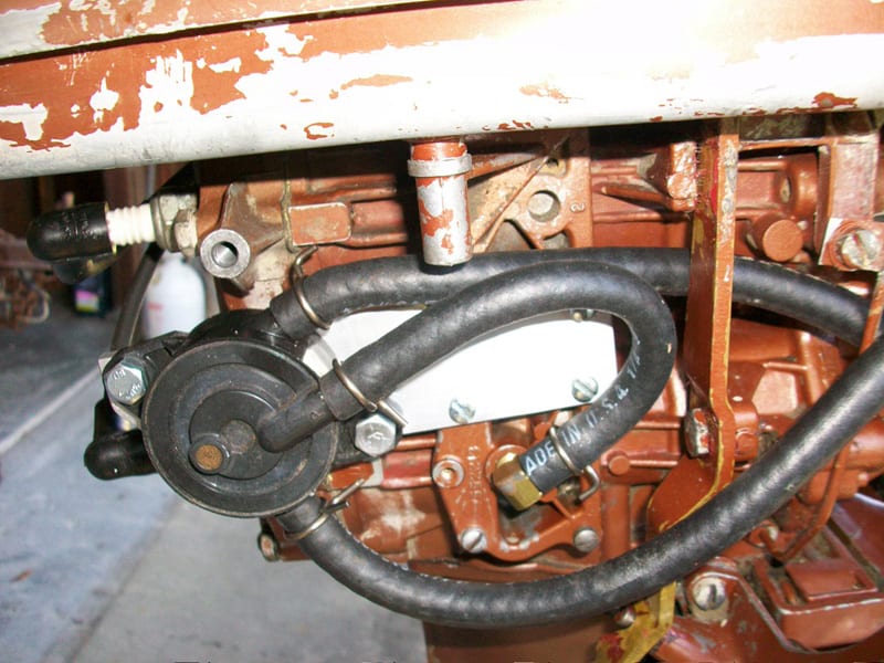

          The ‘net is full of ways to do it. What crosby suggested is probably the simplest. Next simplest is tap into the existing bypass cover for a hose fitting to drive the pump. I’m posting a picture to illustrate the concept, although this is not a Big Twin. This guy used a Briggs & Stratton fuel pump, available everywhere & cheap..

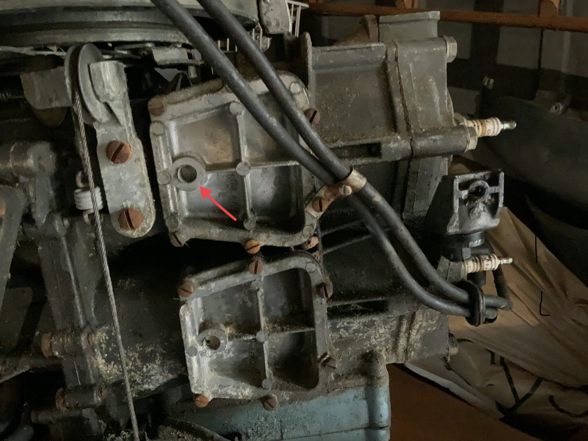

                The fuel transfer covers on my 1953/54 Big Twin both have unused bosses. One of frankr’s photos shows a hose connection in what looks like a cover similar to mine. Do you suppose I could have one cover drilled and tapped for a hose connector? Lets be honest, I have no idea whatsoever what is behind that cover. Placing a new pump would be another challenge but we’ll cross that bridge when it gets to us.
                IMG_0094
                #238888
                  That was my intent as I posted the pictures. Fuel pumps are driven by alternating pressure / vacuum pulses. There are alternating pressure / vacuum pulses in the engine’s crankcase as the piston moves up and down in the cylinder. So the goal is to access those pressure / vacuum pulses. Drilling & tapping a transfer (bypass) cover for a hose fitting is a super easy way to do that without messing anything up. Remove one of the covers and take a look and you will see what goes on in there. Of course, you should remove it anyway for the drilling operation to keep chips out of the engine.

                    Jersey Jim
                      Thanks Mr. Crosbyman for all your help and patience on this. I understand the plan to mount the pump directly over the port. The raised edges of the port cover would be gasket surfaces once machined flat. These are kind of thin (3/16 in) and any leakage here could be disastrous. I think I would have less to worry about if I begin by placing the hose connector in the existing boss and finding a spot for the pump.

                      #239001
                        it is up to you but if you just shiny up the surface of the lower bypass cover for ex.: on 100 grit paper and make a patterned cover plate of 1/16 aluminum you could mount the pump on the cover plate and drill a 1/4 inch hole in the best quadrant aligned to the pump’s rear center pulse port
                        Me I would try to use a lower quadrant corner edge allowing any accumulated fuel/oil pushed in the void behind the pump to simply drain back into the crankcase . This will prevent any puddle of fuel staying in the bypass cover. pick a quadrant and drill at a slight down angle. remove the bypass to drill it !!!
                        other quadrants can be filled with JB to eliminate any chance of the “extra” volume affecting the pump operation or crankcase pressure specs
                        seal the aluminum plate /pump assembly over the drilled bypass cover with either a paper gasket cut to shape or gasket sealant
                        the crankcase does not generate high piston like PSI’s since on the downstroke it pushes new fuel in the cyl and expels burnt fuel at the same time. On the upstroke it sucks fuel from the carb.
                        both these actions will pulse your new pump directly or via a brass nipple tapped in..
                        OK I have never done a big twin so it is all up to you Option#1….you drill, plate and mount a 2 nipple pump or Option #2 you mount a 3 nipple B&S pump anywhere you can and hook up your pulse line to a brass nipple tapped into a bypass port as per the pictures above..
                        this latter option may be your best if you are worried with option 1 (drilled and plated bypass cover ).
                        up to you now.
