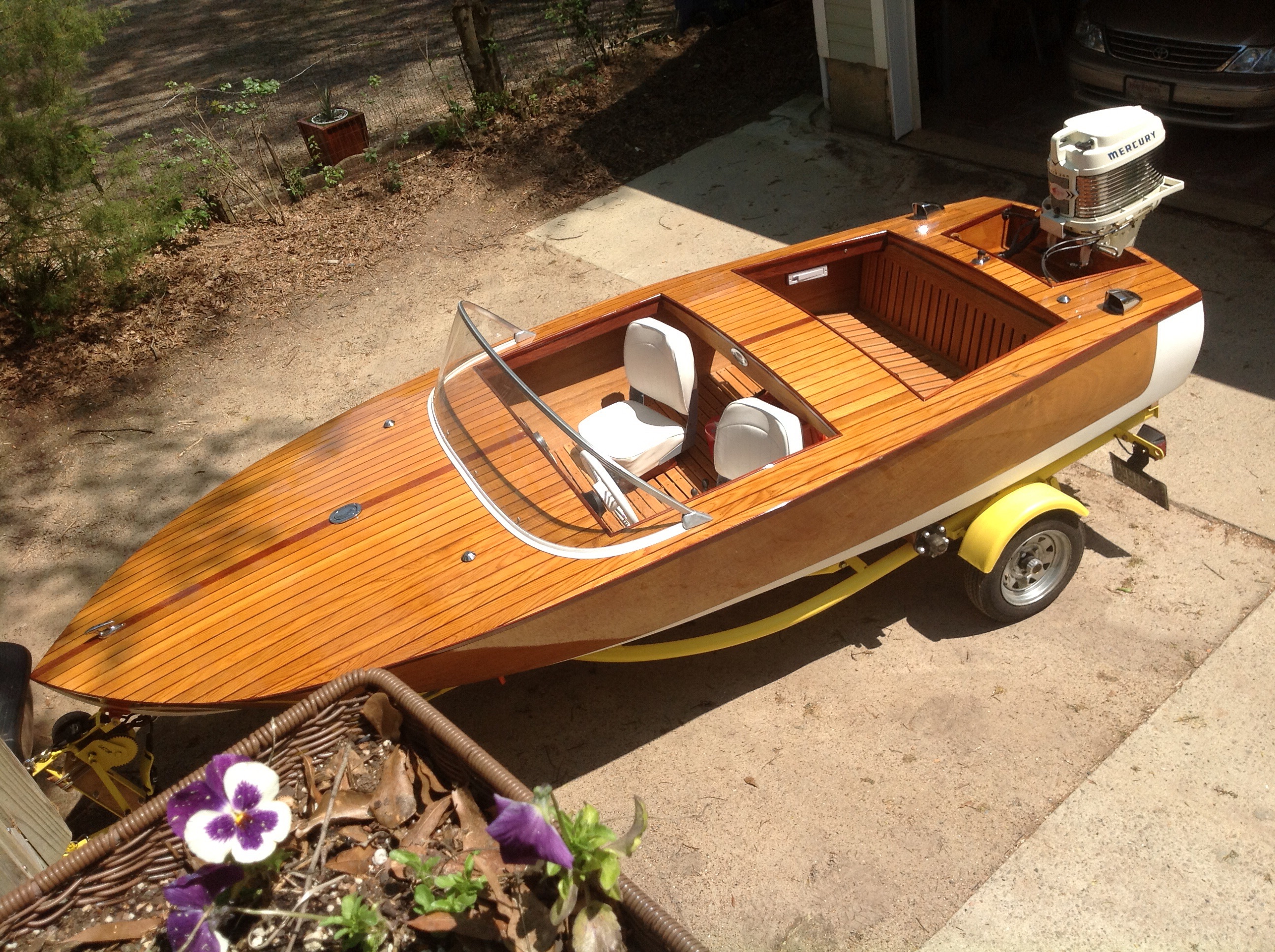

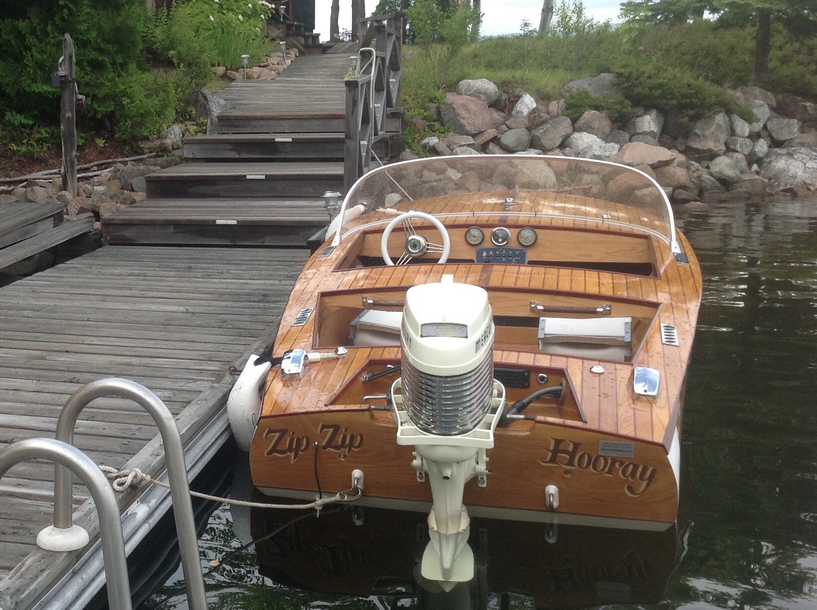

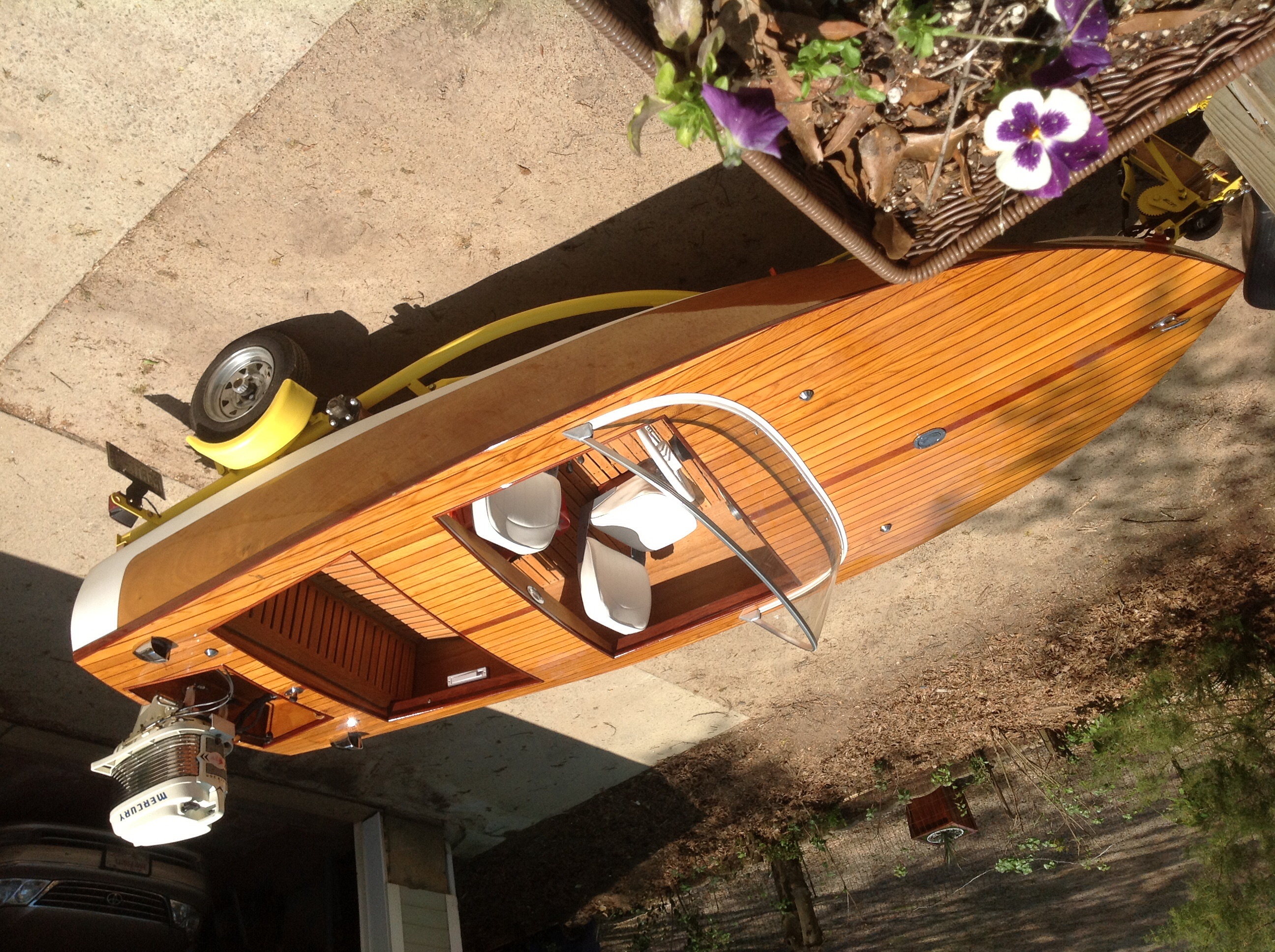

              #34881
              gdcarpenter
                The Boat.
                After 2 years on display in our family room the wife wanted the outboard ‘out’. So I found plans for a boat from GlenL that best suited the ’59 Mark35A and 2 years later had me a boat
                #34882
                archangel
                  Beautiful! Which plan is that? I have plans for a Zip along with the frame and transom kit that have been sitting and waiting 7 or so years for me to get my act together and build.
                  #34885
                  westwind
                    Cedar should be a good choice as well, with stainless staples.
                    #34889
                    gdcarpenter
                      It’s a "ZIP" – ergo the boat’s name.
                      #34894
                      20mercman
                        Hard on my neck the other way! It sure is beautiful!
