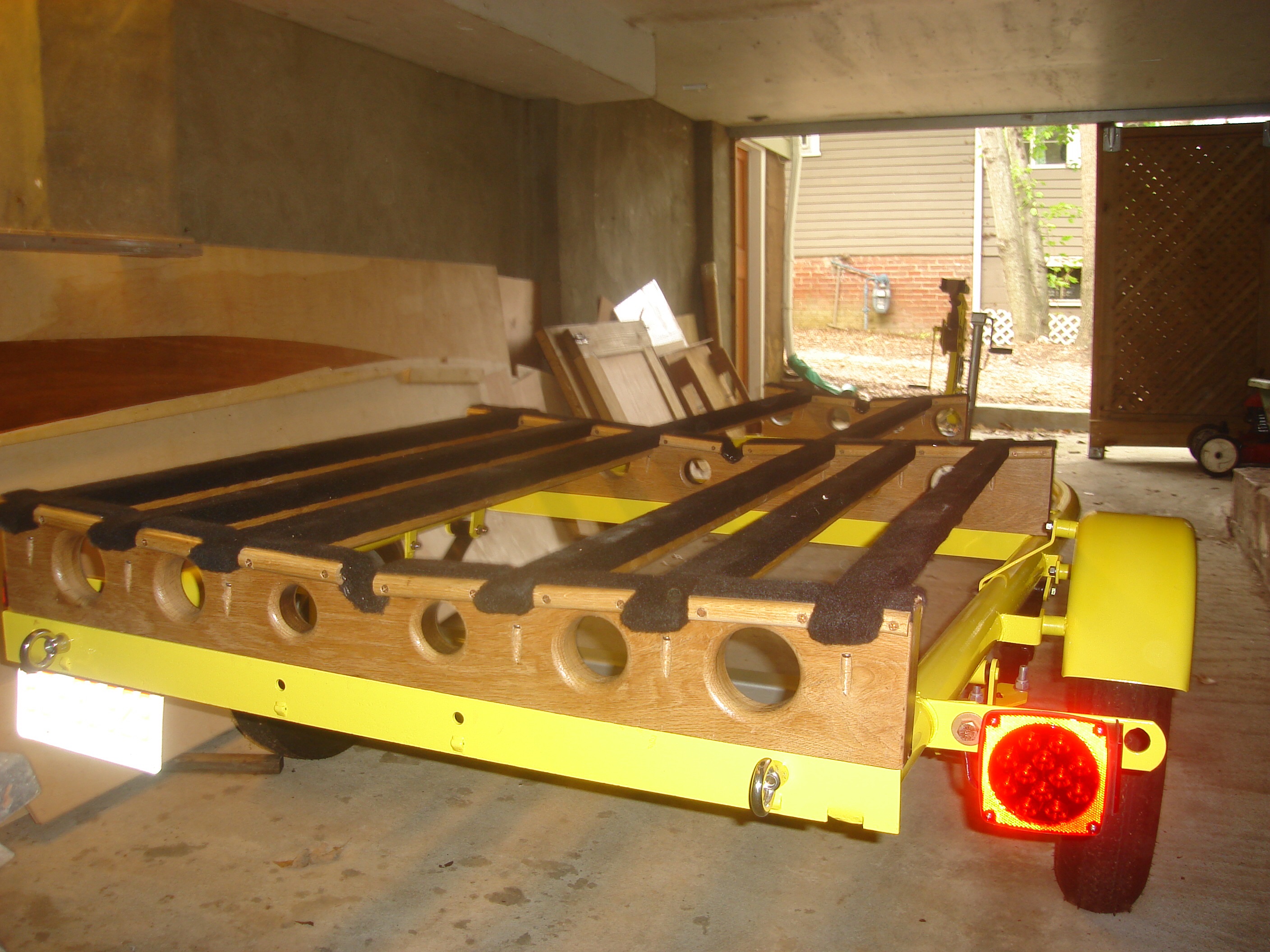

April 15, 2016 at 11:56 am #34836gdcarpenter….holy cow what a trailer. Not overkill, that is a work of art.
