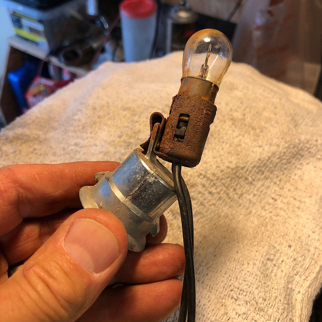

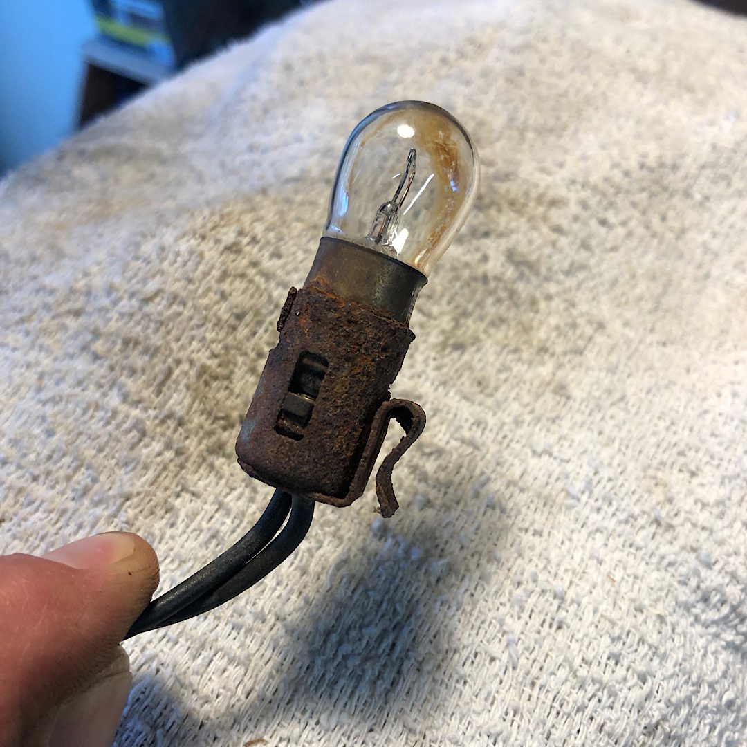

      So this is the element/receptacle or whatever from my vintage bow light. Solid rust and won’t budge. I could soak it, free it up but it would always want to rust up again. Where can I buy another new one that has the clip built in? This one is not removable.
      Actually I’m looking to convert this light to LED so I can run it on a super small 6 volt battery. I don’t need to lug a big 12 volt car battery since my FD-12 is manual start. Can I just install an LED set up on the ends of the 2 wires instead? Where would I go to buy that stuff? Radio Shack? Are they even around anymore? Haven’t seen one in years!

        I don’t know about the clip, but the socket size/design is called a BA15S. Start searching from there…

          JOSEPH BRINCAT
            Just note that the marine applications are typically “two wire” , hot and ground to the bulb base. No ground circuit through the mount and chassis (hull) as in automotive applications. If you go LED, you will have to rig up a wired ground.

            Nicholas Keller
              Running 12 volts will be easier to source led bulbs. More options are available, however in respects to battery you can use a small gel-cell or even lithium power source if weight is a major concern. Also, when looking into led you may consider mounting a small printed circuit board in the assembly in place of the traditional bulb as they are reasonably available in many sizes with surface mounted leds.
