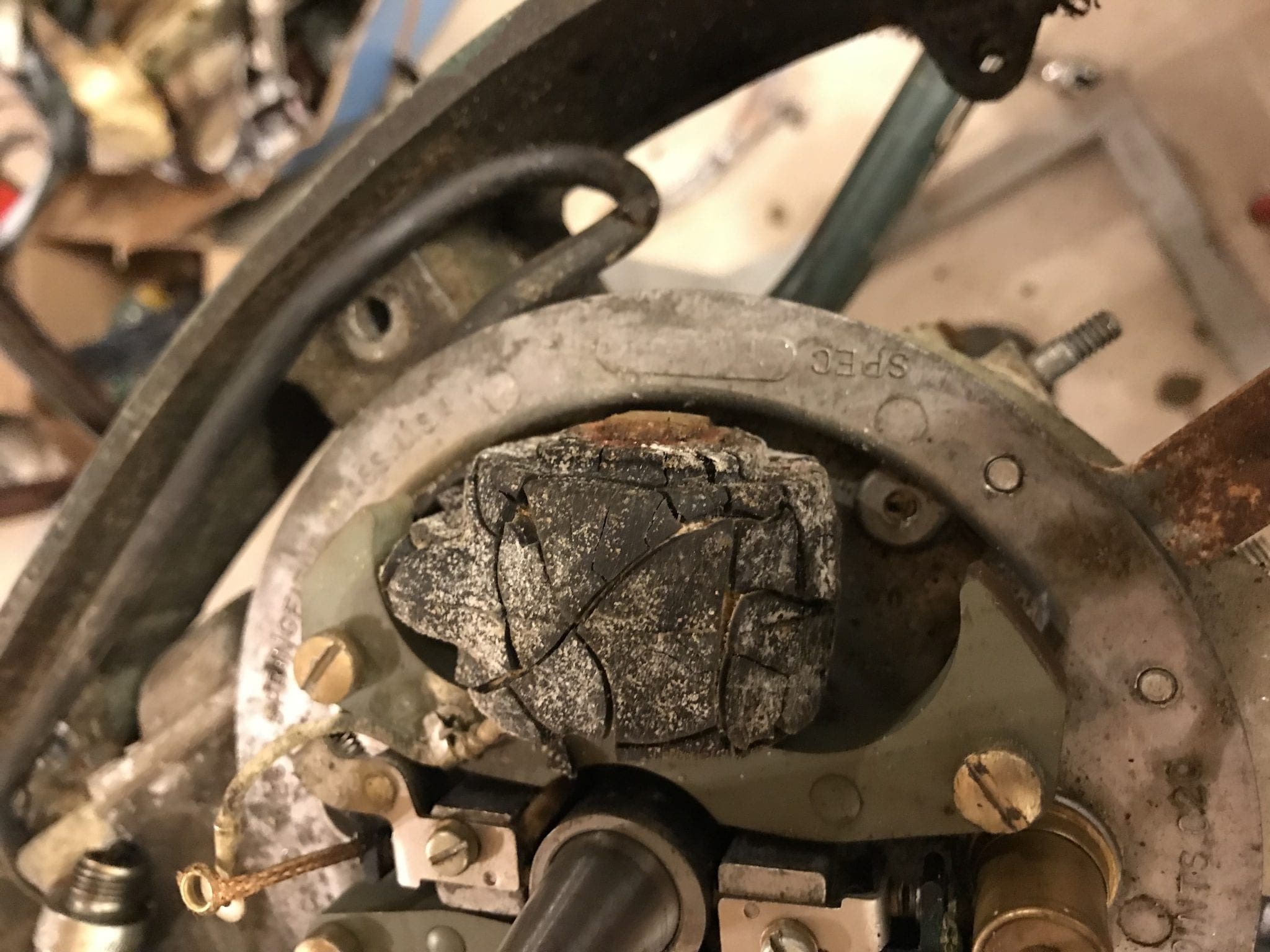

      I just popped open the flywheeel of a 1950’s Elgin 7.5 and the coils were completely shot. I would probably assume the same for the condensers. Is there any way I can slide off the coil of a Johnson evinrude (OMC) type ignition coil and slide it onto the Elgin style one? If I can, what precedures do I need to take to set it up correctly?

      jerry-ahrens
        You sure can. Just remove your old coil from the laminates, and slide the new OMC coil on. The original Wico laminates should have a tab that you bend over to secure. You can go ahead and use the original Wico condensers with the new OMC coils. Once in a while I’ve found a faulty one, but usually there still ok. Take a look at the Odd Job Motors website for detailed instructions.
