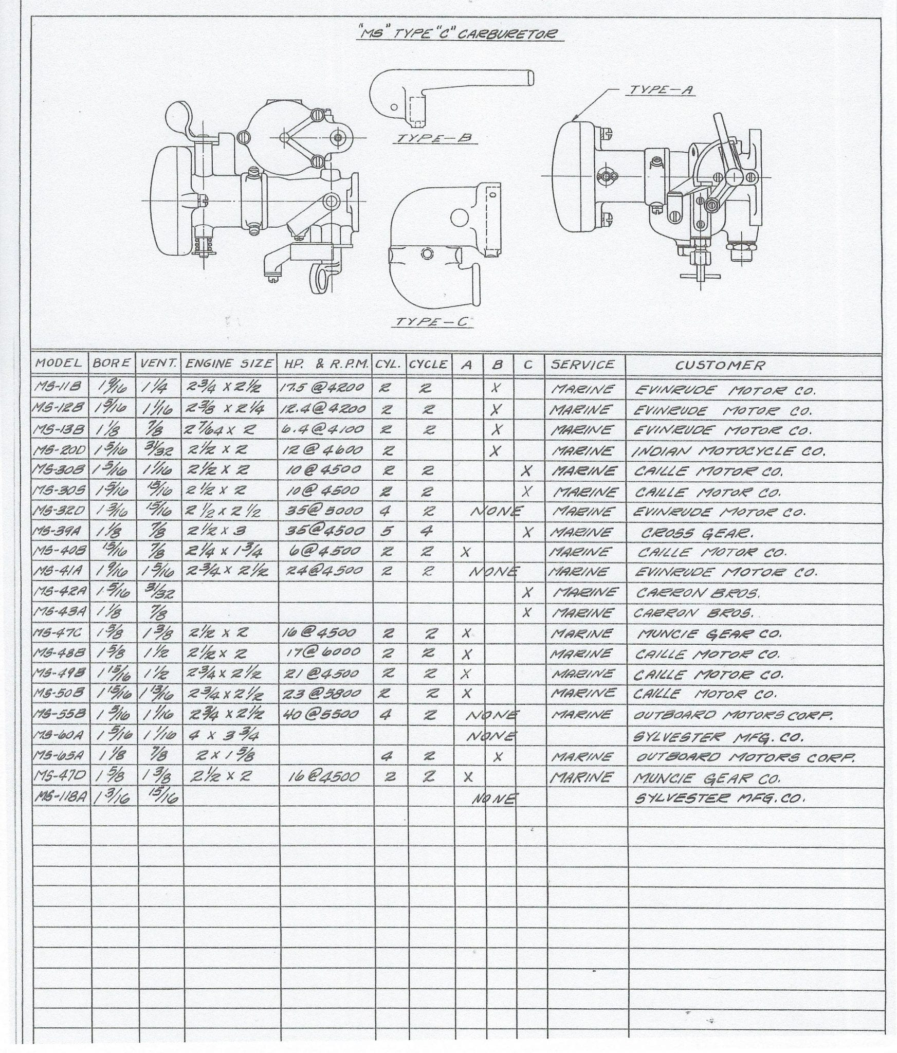

            #208642
              #208656
              opposedtwin
                Thanks Buc! Good work!!
