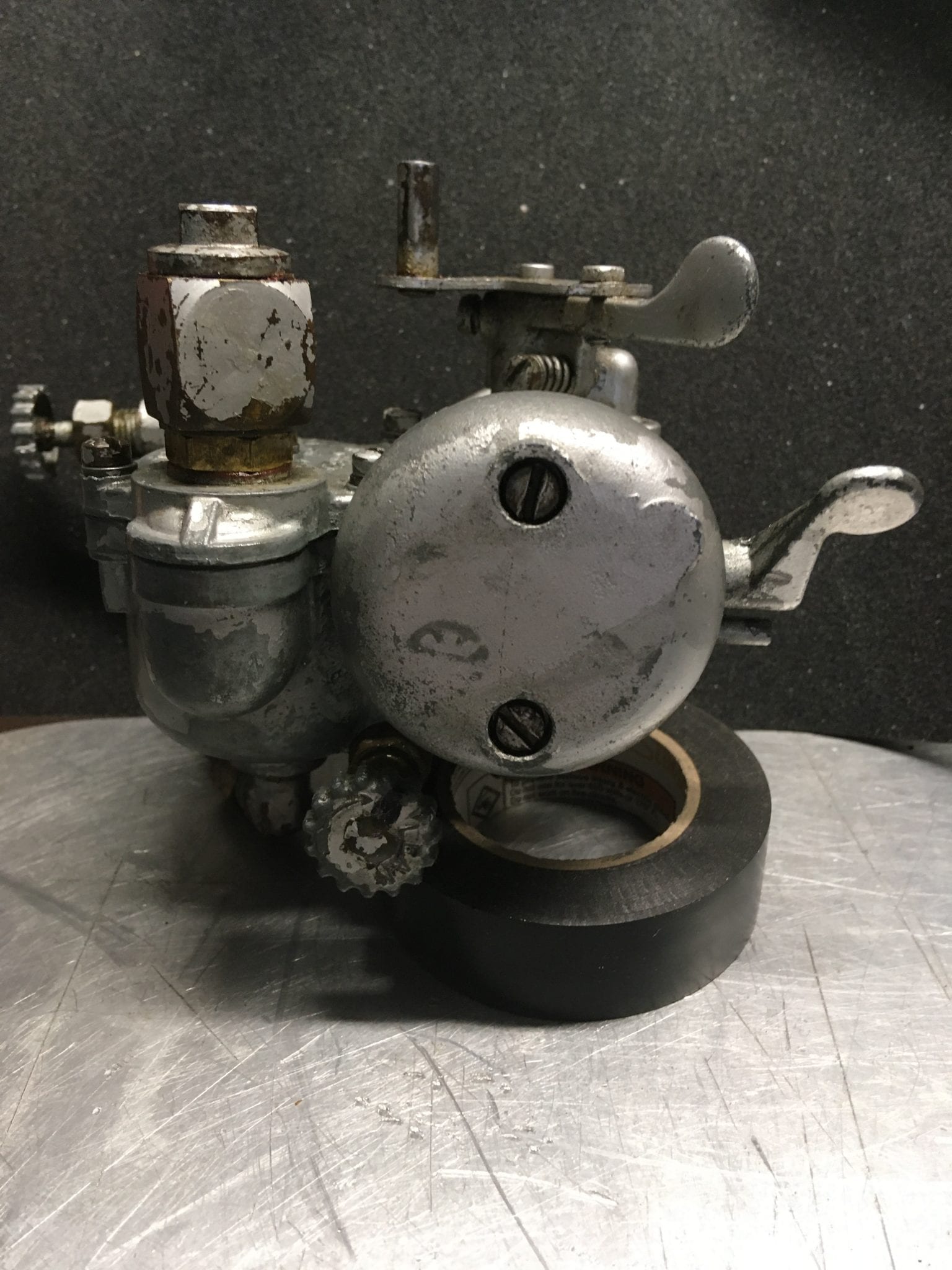

      Does anyone know where carb parts can be found for a 1940 K4 6HP. Photos attached

          Tillotson MS 113A looks fairly complete. I believe Ferguson Poole may have some minor items. Bob Grubb may be able to help.
          1940 was 80 years ago on the other side of a wold war. My experience
          in hunting down parts for MS113A makes me believe the best
          and perhaps only source is another MS 113A or a closely related
          model. Float bowl gasket can be made using accurate ruler and drafting
          compass measure carburetor bowl opening, then transfer and mark
          gasket stock.. The fuel inlet gaskets may also be reverse engineered.
          Where there is a will there is a way.
