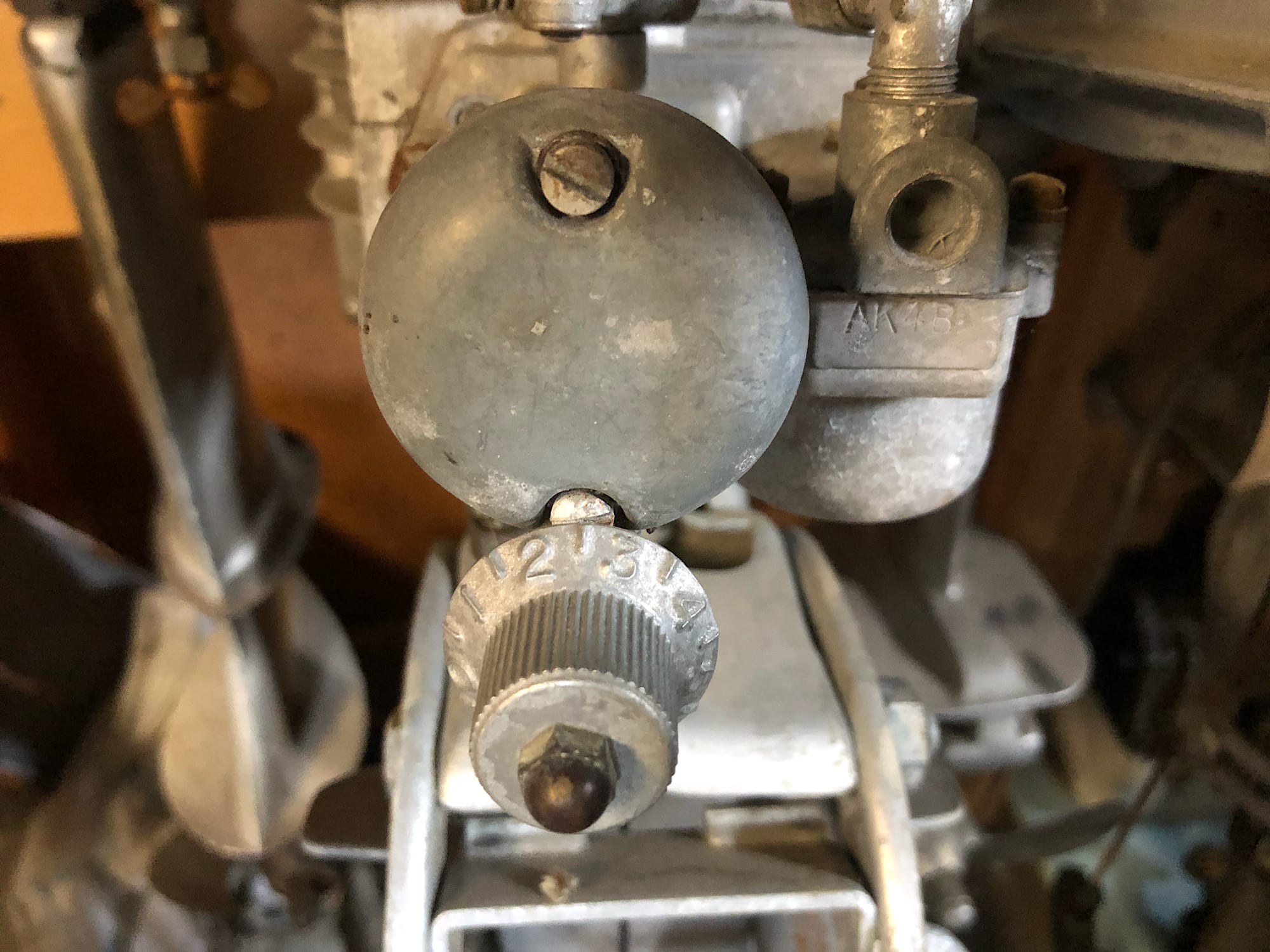

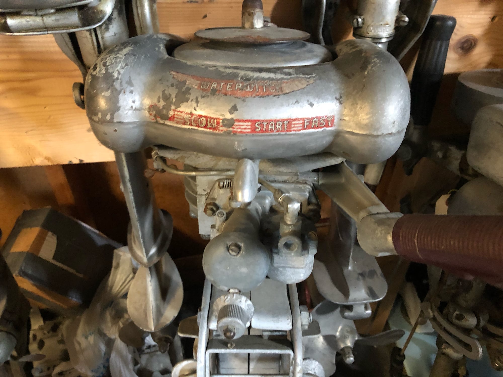

                  Interesting. As tillotson supplued carbs to multiple Outboard companies back in the day, I thought I’d check out my little waterwitch motor expecting and hoping the carb would be an ms113A or ms115A but no luck. It’s an AK4B.
                  Scott

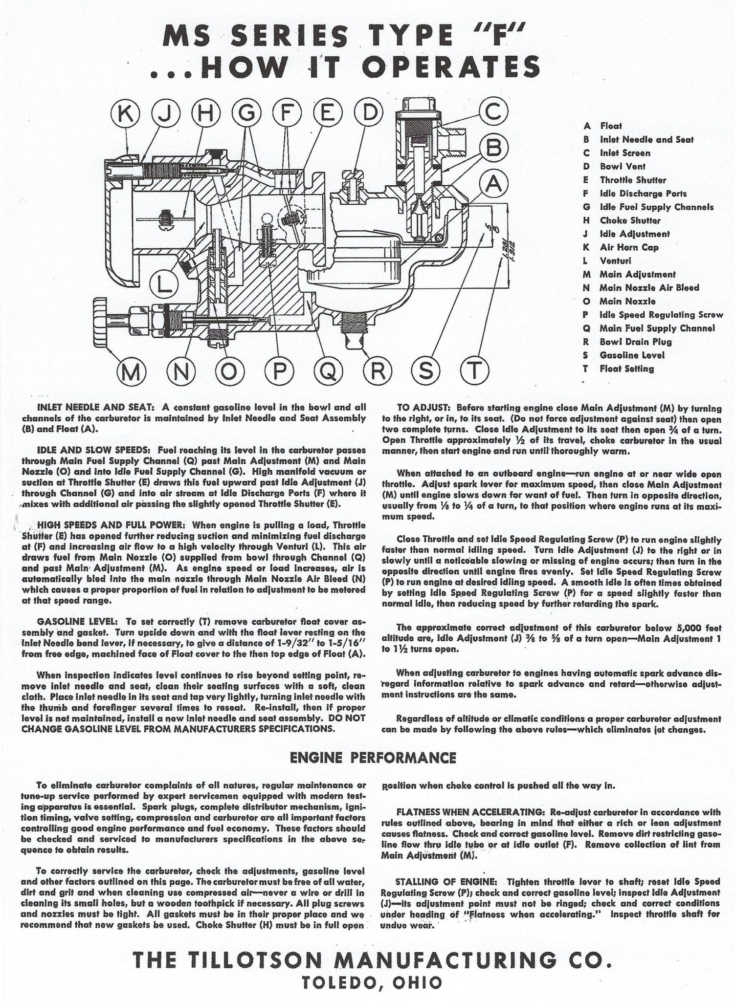

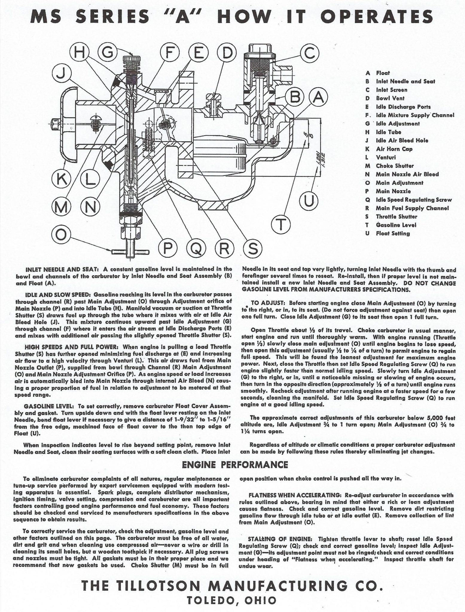

                      seakaye12
                        http://discount-marine-parts.com/tillotson_ms.html
                        T1
                        T2
                        T3
                        T4
                        Those Tillotson Fact-Sheets are great! Do you have others or can you give a link to the source?
