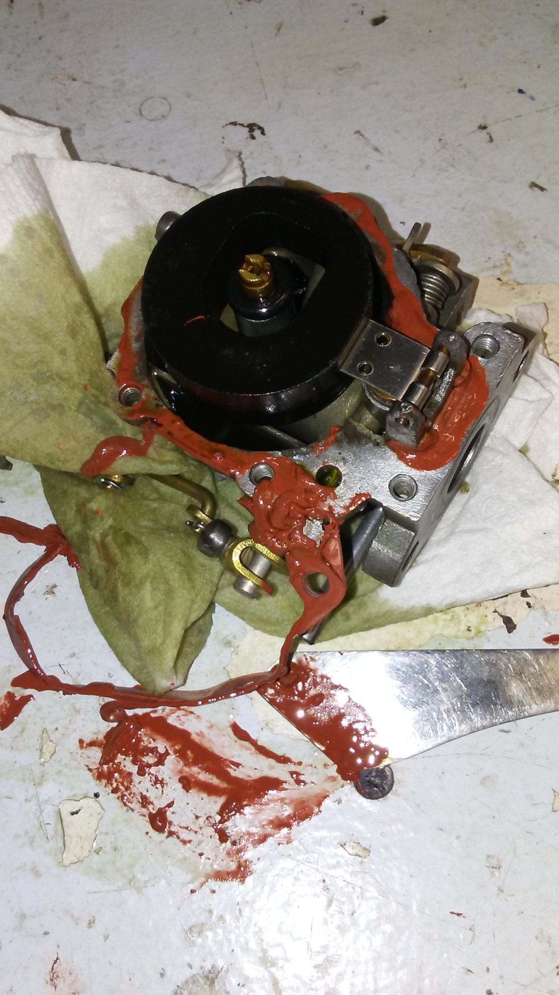

      I would strongly advise against using a Chinese “rebuild” kit.

        very convincing….I just did none a week ago…:-( so the inlet needle fitting threads don’t fit,, the gasket melts
        #208486
          I’ve installed a few of the offshore carb kits but haven’t checked the bowl gaskets yet. Gulp! Maybe I’ll get lucky by always using non ethanol fuel. The float valve seat has the correct thread pitch but they aren’t cut deep enough and need to be chased.

            #208497
            drifter
              Tubs, carb was done a year ago. I pulled the engine off the rack to run it last week but noticed a drip stain from the carb. Investigated and this is what I found.
              I run ethanol gasoline. Bad news.

                #208623
                sutterhome
                  black gaskets dissolve in a day or less, also brass needle valve seat wrong thread size. test all parts in gas for a day or so…china mostly trash… has been from day one
