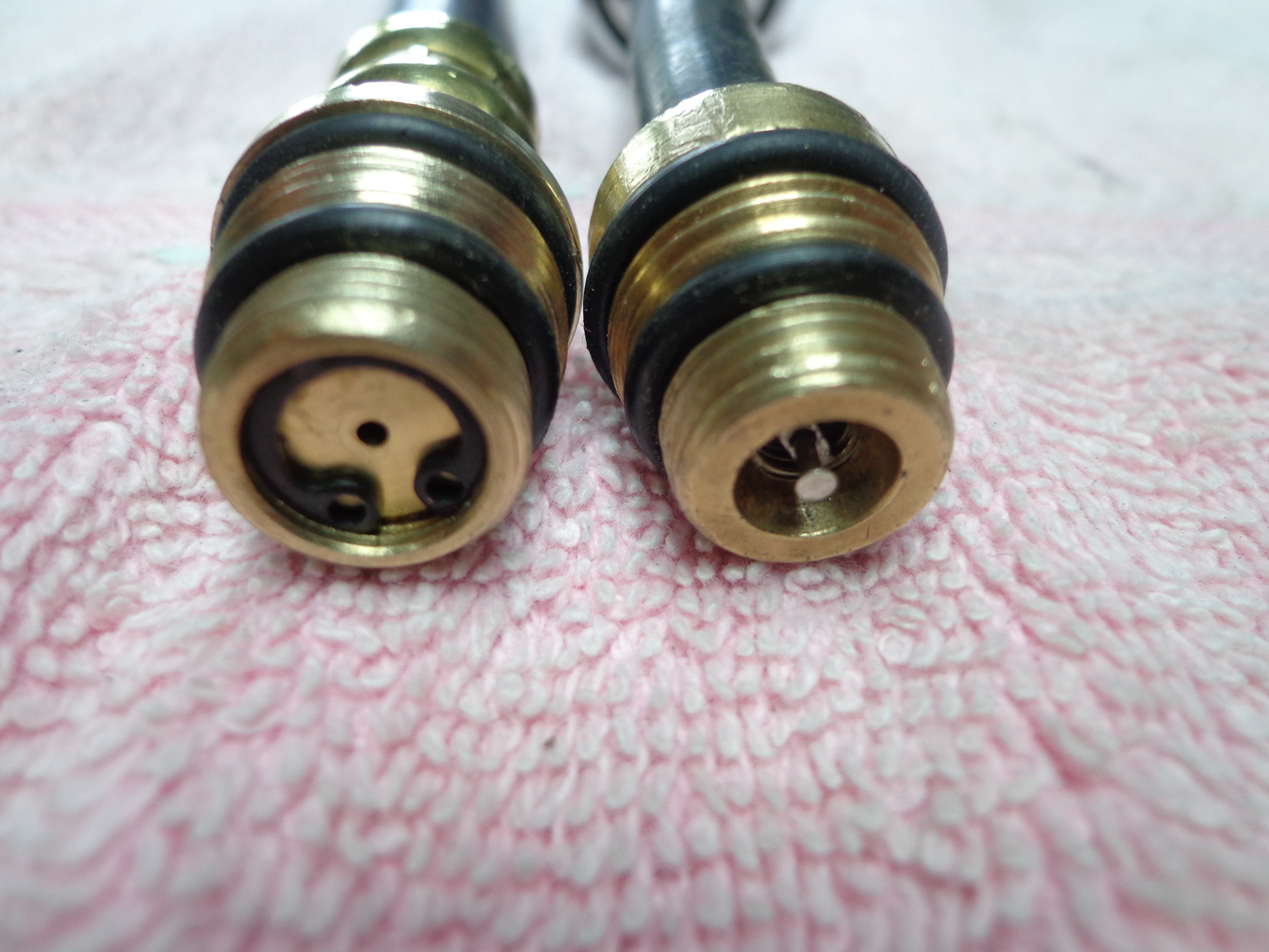

                    Your compression tester should have a working check valve like these ones on the end of the hose.
