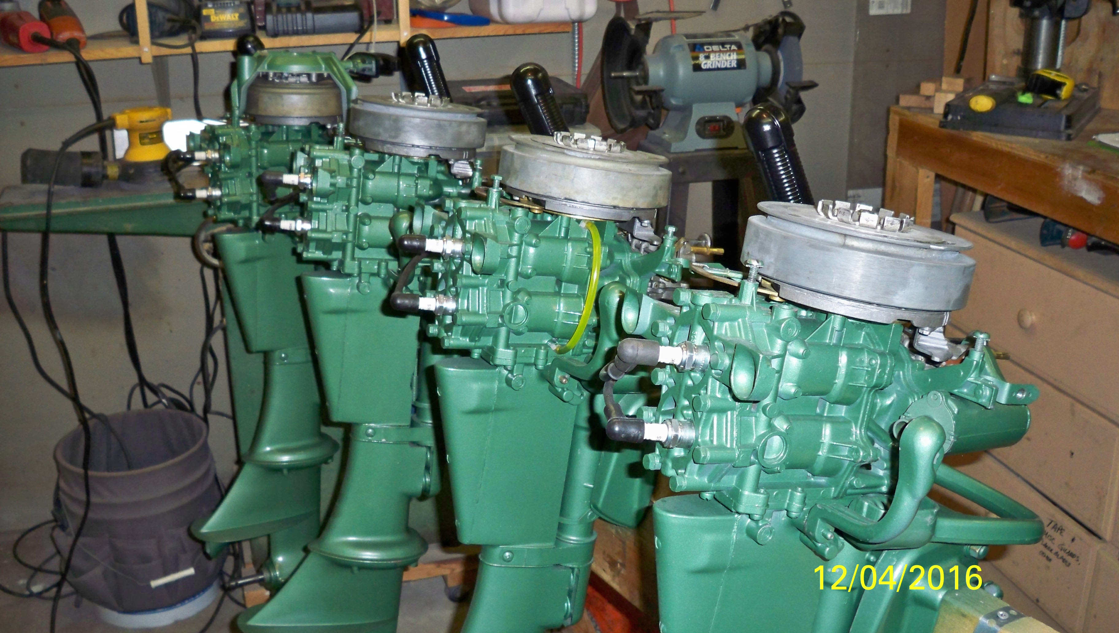

January 25, 2017 at 3:10 am #51667Are you pulling our leg here? Why does only one motor in the pictures have the line going from the lower main bearing to the upper main bearing? The two motors in the foreground have the spot for the soft plug that has the serial numbers on it but the ones in the background don’t have a spot for those plugs. You are telling us a scenario that seams impossible! You do have everyone’s attention though!
dale
